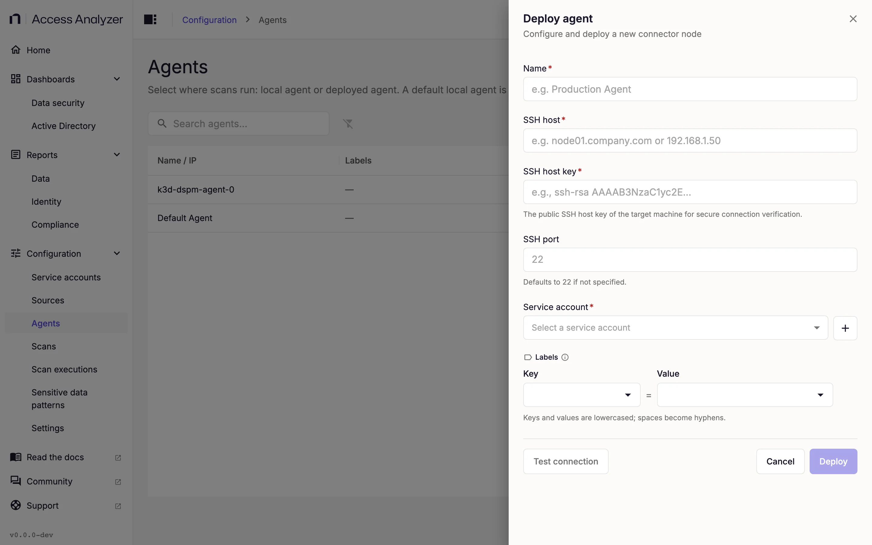

Generate the Command
- Go to Configuration > Agents.
- Click Deploy agent.
- In Name, enter a name for the agent, such as
Production Agent. - Under Labels, add at least one label, such as
env=productionorregion=us-east. Labels are how scans find this agent; see Agent labels and scan routing. - Click Deploy. The panel reads Generating install command… and then shows the command under Install command.
- Click the Copy install command icon. A notification reads
Command copied to clipboard.
The panel stays open. Leave it open until you have pasted the command into a terminal on the host, because Regenerate command is the only way to get the command again.
A generated command looks like this:
sudo dspm-installer install-agent --server=https://aa.corp.example.com:6443 --token=<registration-bundle> --name='Edge agent' --label=region=eu
The panel quotes the name for the shell and adds one --label for each label. Run the command exactly as the panel gives it.
| Field | What to enter | Rules |
| Name | A display name, for example Production Agent | Required; up to 255 characters |
| Labels | One or more key=value pairs | At least one required; Access Analyzer lowercases keys and values and replaces spaces with hyphens. The keys name and default are reserved. |
If you close the panel with unsaved changes, Access Analyzer asks you to confirm. After you generate the command, closing the panel needs no confirmation.

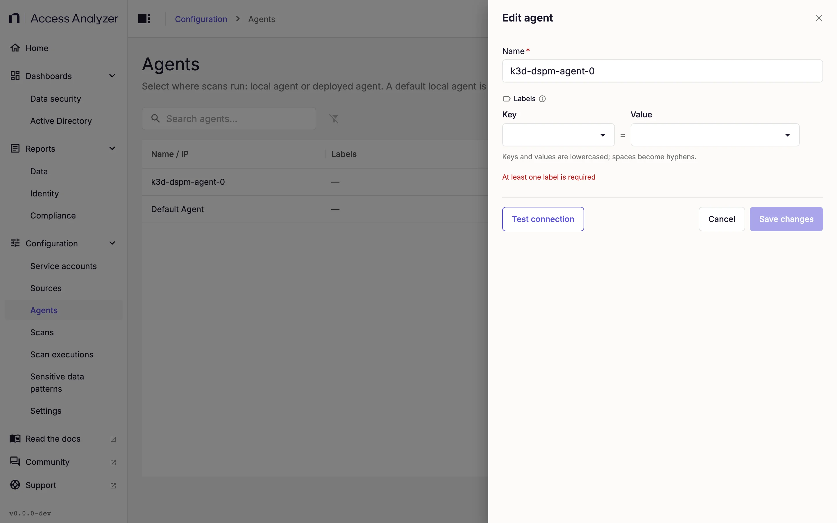

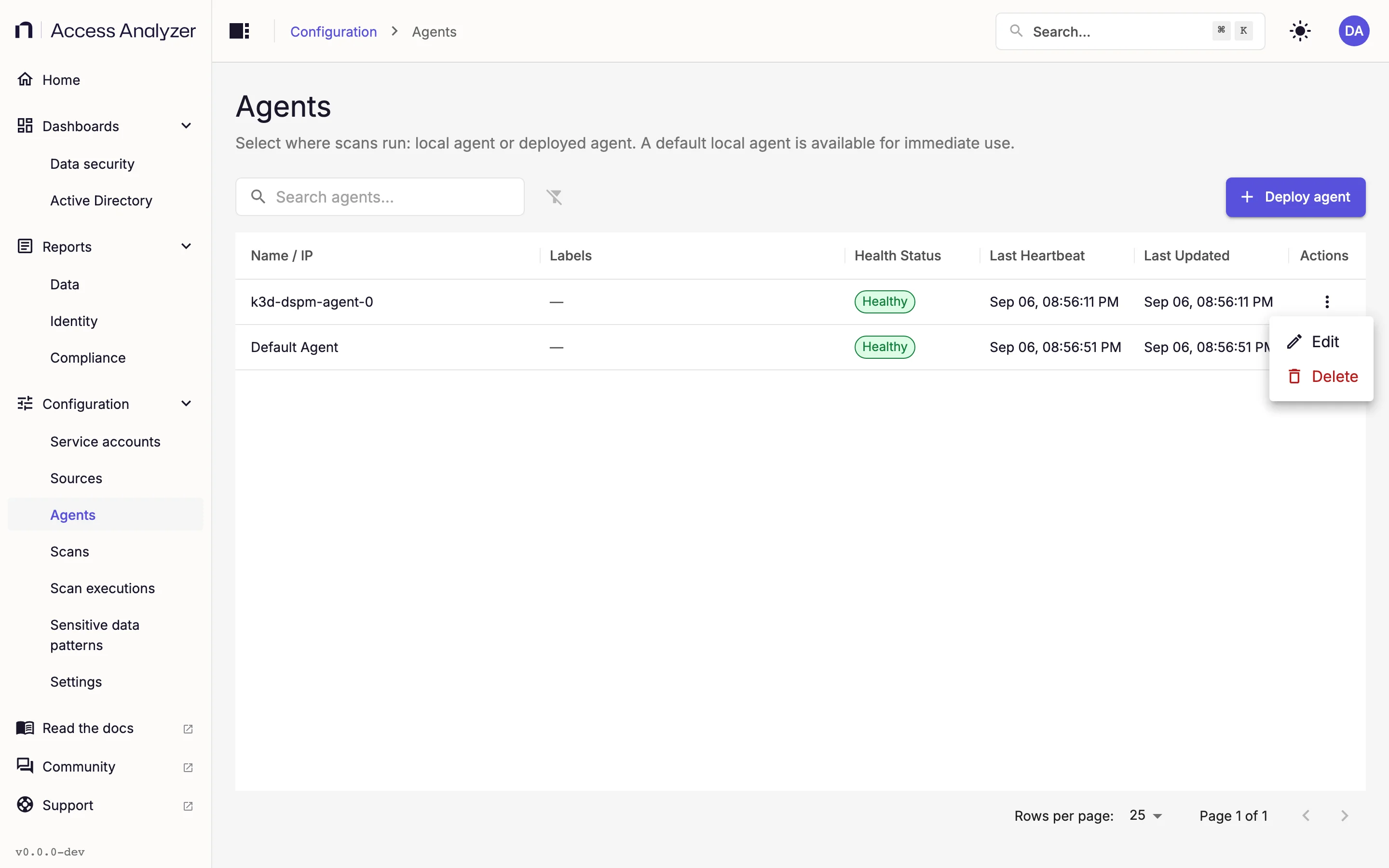

Edit an Agent
- In the agent's Actions menu, click Edit.
- Change the Name or the Labels. A deployed agent must keep at least one label.
- Click Save changes.
Test connection sends a short test task through the agent and confirms it runs. Use it to confirm that a deployed agent can accept work. Success shows Connection successful; a failure shows the server's message.
You can't rename or relabel the System agent, listed as Default Agent; opening Edit on it shows Name and Labels locked.
Remove an Agent
- In the agent's Actions menu, click Delete.
- Click Delete Agent to confirm.
A notification reads Agent "<name>" deleted, and the agent leaves the list.
Removal takes the agent out of Access Analyzer. The server doesn't connect to the host again, and the agent software stays installed there until you remove it yourself.
You can't remove an agent while a scan is running on it; the attempt fails with Failed to delete agent. Wait for the execution to finish, or stop it from Scan executions, then try again.
Scans whose agent label pointed at the removed agent keep that label. Their next execution waits until another agent with matching labels is available, as described in Agent labels and scan routing. Edit those scans, or deploy a replacement agent with the same labels, before their next scheduled run.
The System agent has no Delete action.
