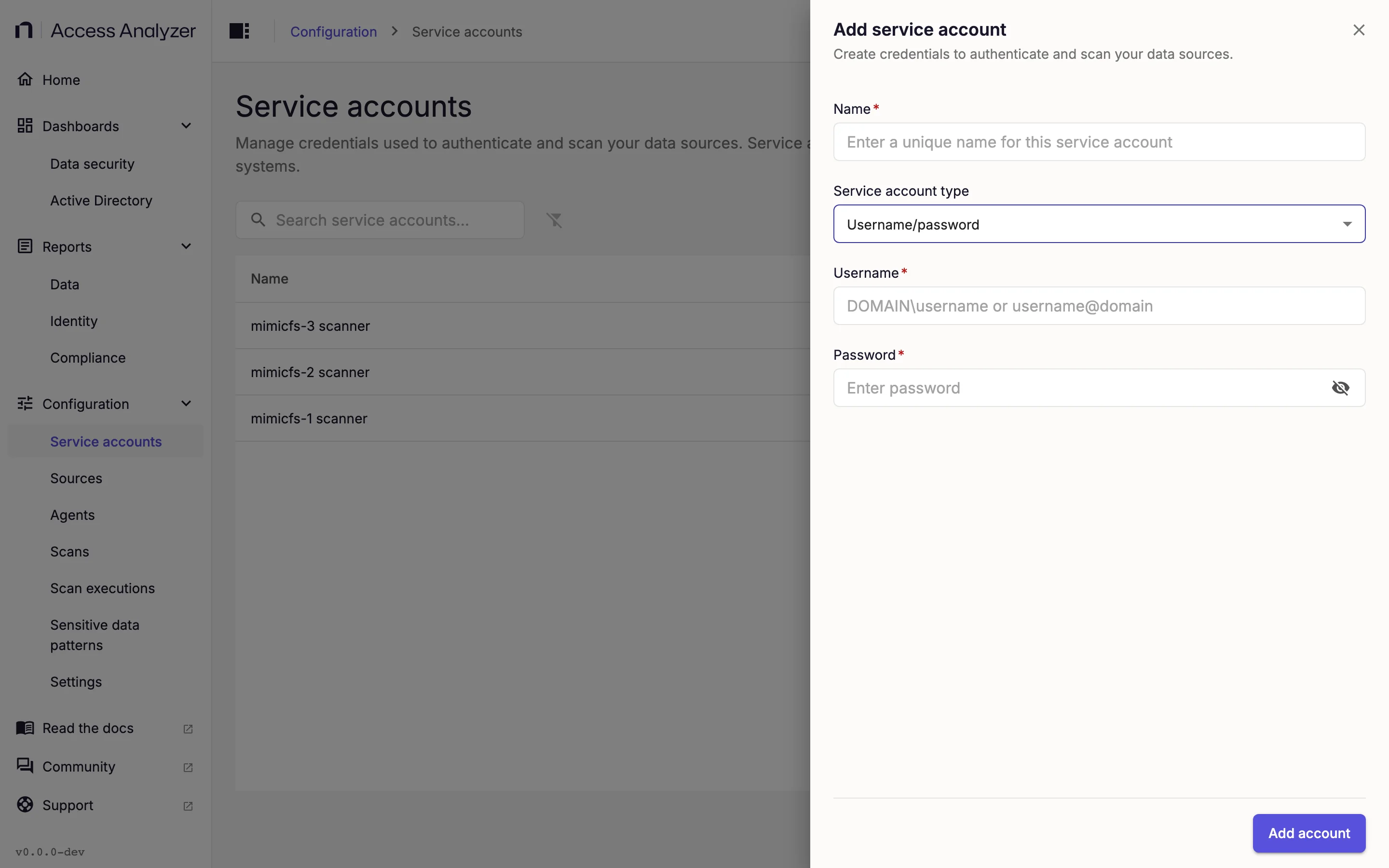

1. Create the Service Account​
Active Directory sources use a Username/password service account.
  1. Go to Configuration > Service accounts and click Add service account.
  2. In Name, enter a unique name, for example svc-ad-sync.
  3. Leave Service account type set to Username/password.
  4. In Username, enter the account's user name only, for example svc-ad-sync, without a DOMAIN\ prefix or @domain suffix. Access Analyzer supplies the domain from the source's Domain field.
  5. In Password, enter the password.
  6. Click Add account.
Add service account drawer with the Username/password type selected
If you already created a Username/password account for a file server in the same domain and its Username is a plain user name with no domain prefix, you can reuse it here; the Username and password page covers the details.

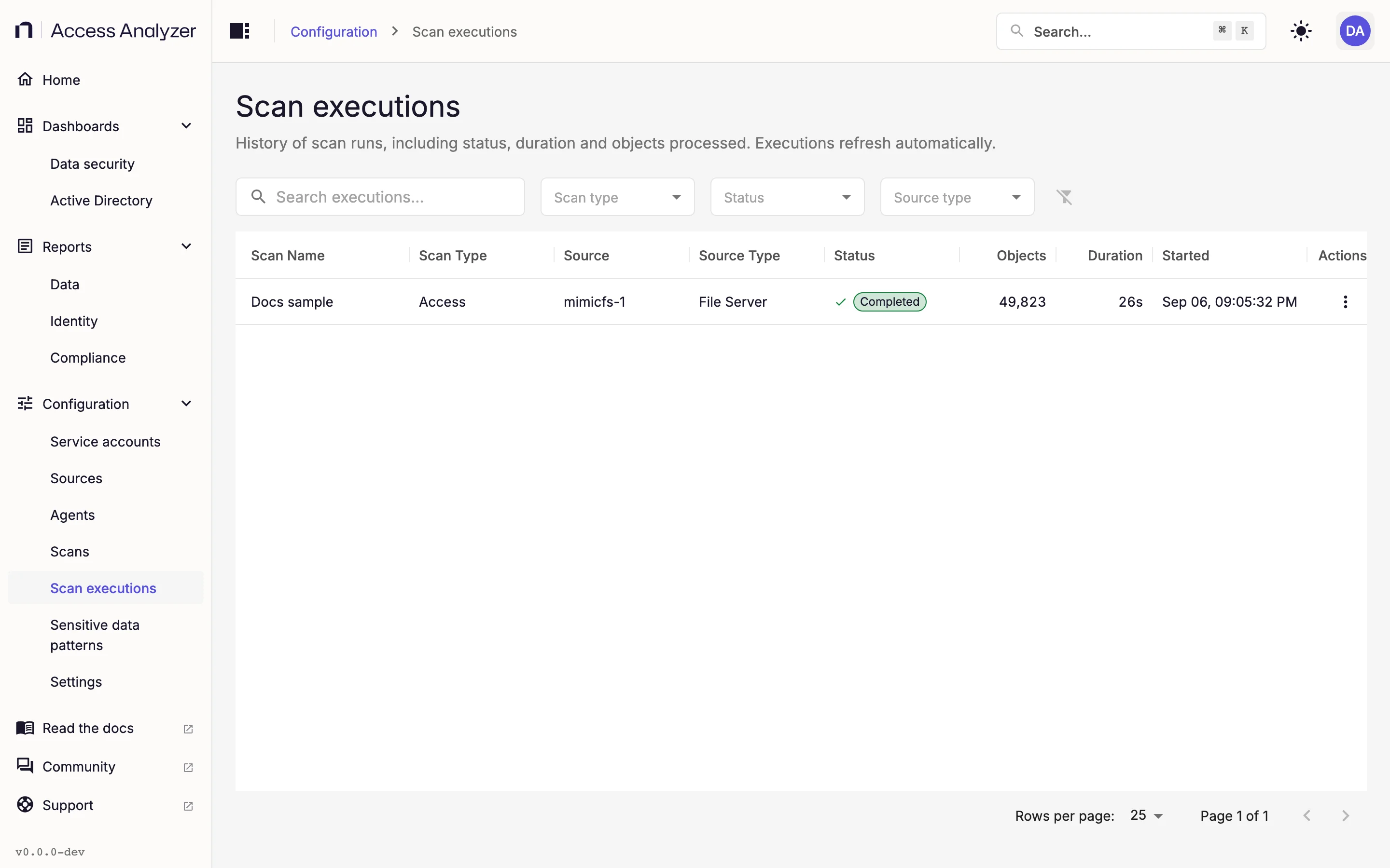

4. Watch the Execution​
Go to Configuration > Scan executions and find the row for the new scan. The list refreshes on its own and shows the execution's Status and, under Progress, how many users and groups it read.
Scan executions list
When the sync itself finishes, the execution moves to Post processing while Access Analyzer expands nested group memberships in a step named Refresh Effective Memberships. The step appears as a child row under the execution; click the arrow at the start of the row to show it. The execution reaches Completed once that step is done.
If the status is Failed, open the row's Actions menu and click View logs. Authentication problems appear in the Detailed logs tab. If the message asks for an FQDN, Host holds an IP address and the port is 389; enter the domain controller's name instead.

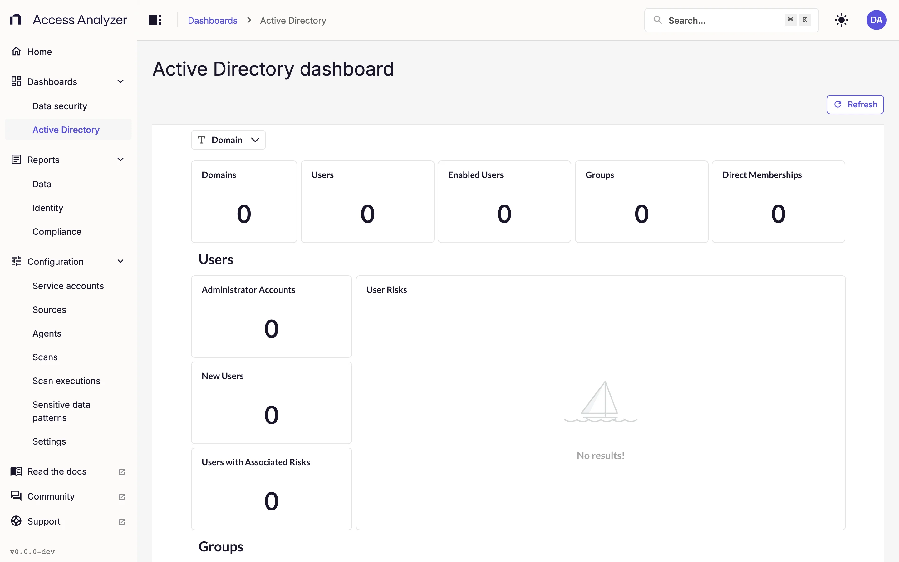

Go to Dashboards > Active Directory and click Refresh. In the Domain filter, select the domain you synced. The dashboard opens with counts for Domains, Users, Enabled Users, Groups, and Direct Memberships, followed by Users, Groups, and All Risks sections that end in the Active Directory Risks table. The Active Directory dashboard page describes each card.
Active Directory dashboard with Domains, Users, Groups, and risk tiles

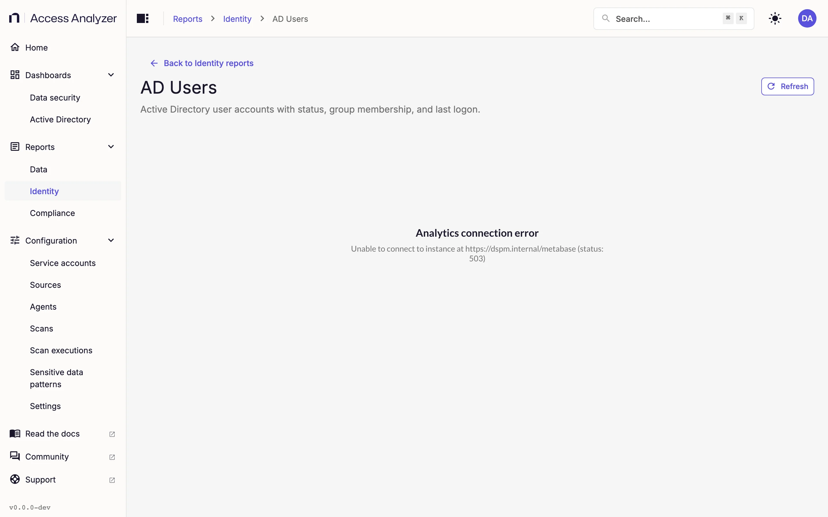

Under Reports > Identity, the Active Directory tab has the AD Users report: every user account with its status, password age, and last logon. The Identity reports page describes each column.
AD Users report
