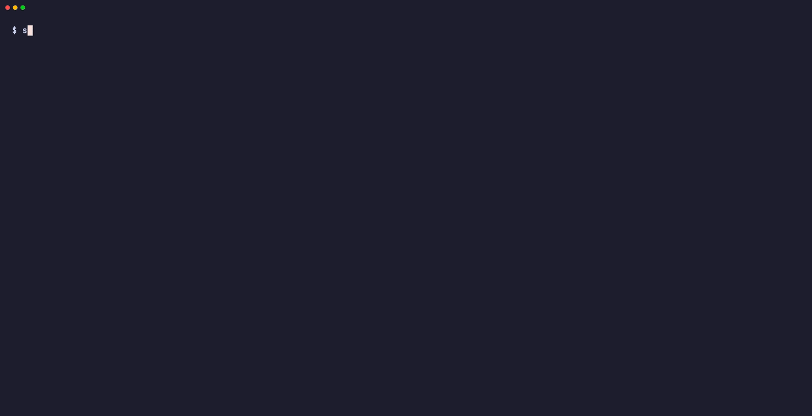

Leave out --ca-bundle for a publicly trusted or self-signed certificate. Look for the TLS line in the output. A pass reads certificate ... and key ... are valid; SANs cover dspm.example.com. If the certificate expires within 30 days, the line also includes , expires in <n> days so renew it before install day before the SANs clause.
Always pass --hostname. Without it the installer skips the SAN comparison and the check still passes, with the message ; hostname not checked, pass --hostname to verify the SANs.
When the certificate doesn't cover the hostname, the TLS line fails and names the hostnames the certificate does cover. In this example, the certificate is for dspm.corp.example.com, so a check against dspm.example.com fails:
dspm-installer --preflight failing the tls check because the certificate is valid for dspm.corp.example.com, not dspm.example.com
