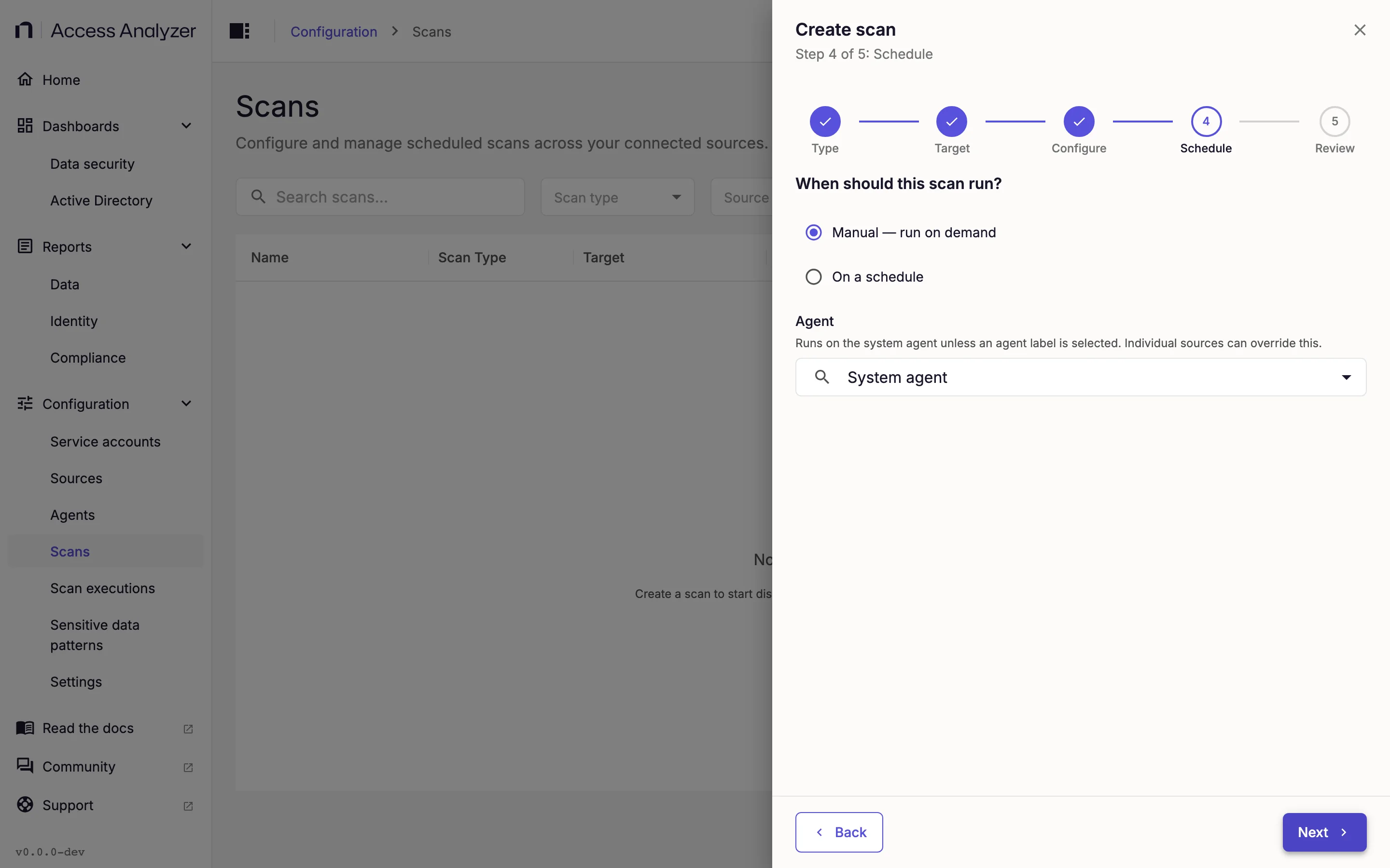

Every scan is either manual or scheduled. You set this on the Schedule step when you create a scan and can change it at any time by editing the scan. On the same step you also pick the agent the scan runs on.
Manual and Scheduled Scans​
Manual — run on demand is the default. A manual scan runs only when someone starts it: Run on the Scans page, or Create & run now when you create it. Its Schedule column reads Manual and its Schedule Status badge reads Disabled.
On a schedule makes the scan run itself. Its Schedule column summarizes the timing, such as Daily 2AM, and its Schedule Status badge reads Active. A scheduled run is identical to clicking Run. Access Analyzer resolves the target again, so label-targeted scans pick up any newly matching sources, and each target source gets its own execution. It skips a source that still has an execution in progress from the previous run and resumes a paused one.
Create scan step 4 schedule with Manual selected

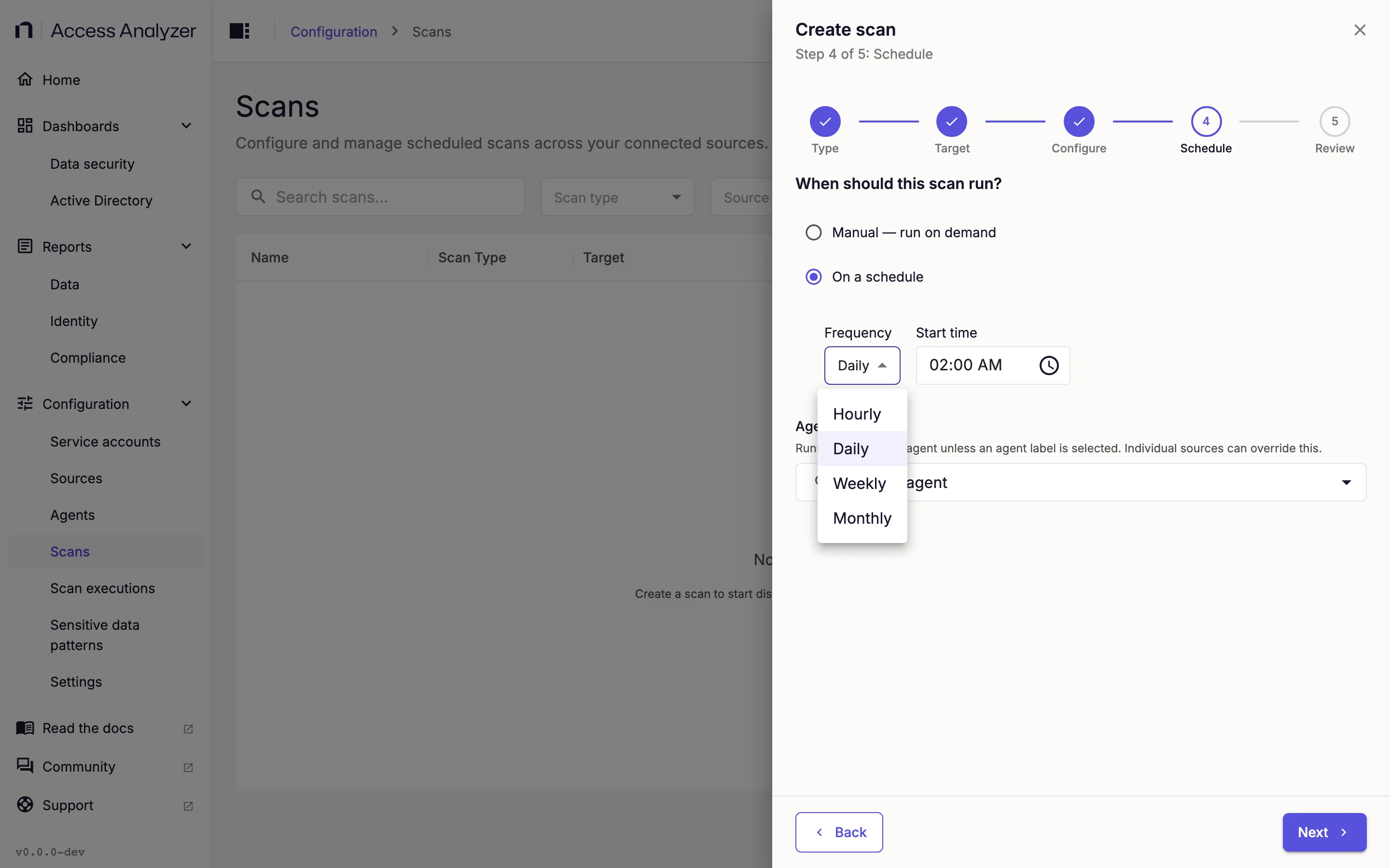

Frequency Options​
Select a Frequency, and its controls appear below it.
Frequency options Hourly, Daily, Weekly, Monthly
FrequencyControlsDefaultRuns
HourlyNone—At the top of every hour
DailyStart time02:00Once a day at the start time
WeeklyStart time, Days of week02:00, Mon to FriAt the start time on each selected day
MonthlyStart time, Day of Month02:00, 1stAt the start time on that day of each month

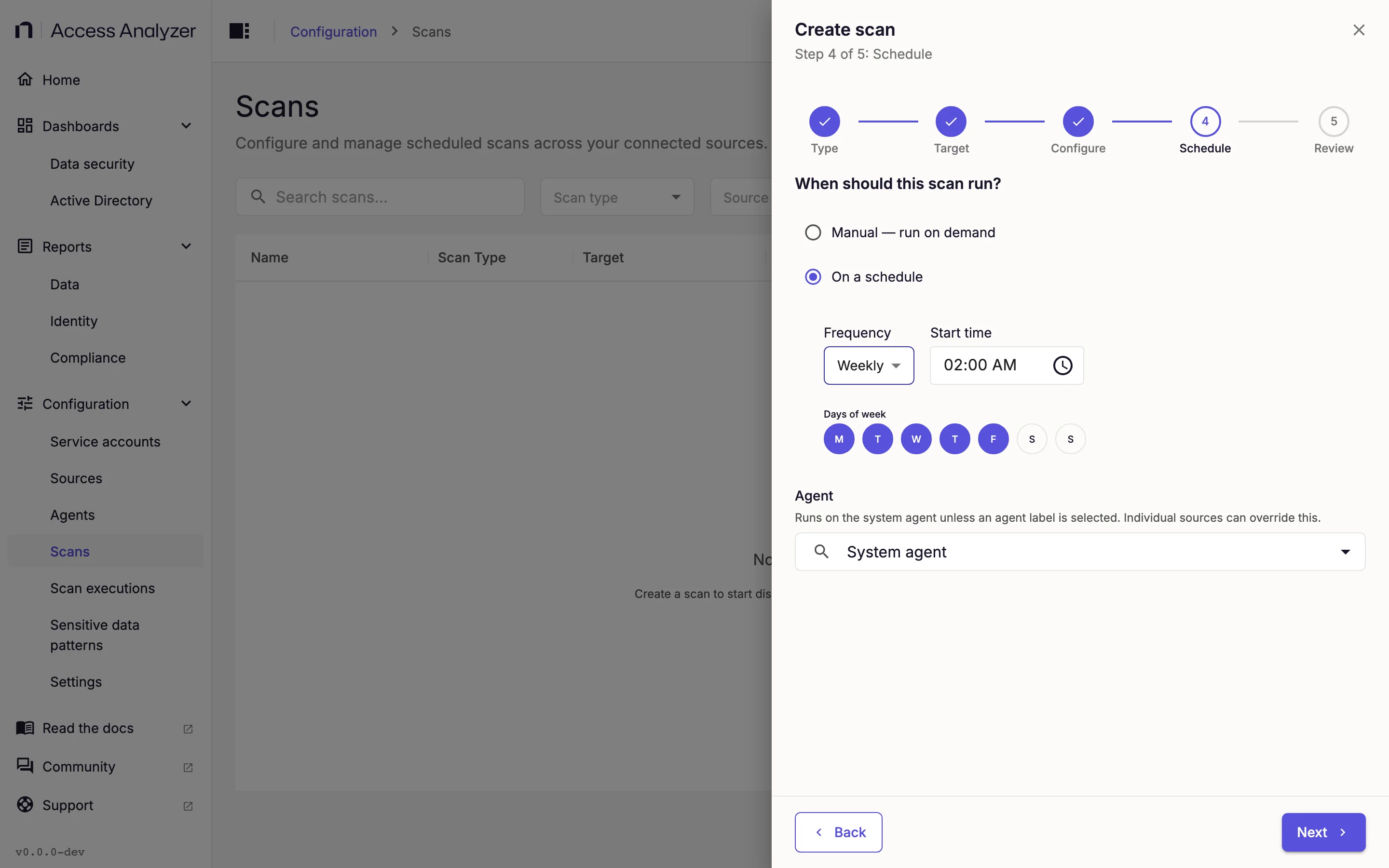

Days of week is a row of day buttons from Mon to Sun. Click a day to toggle it; at least one day must stay selected, so you can't turn off the last one. Day of Month offers 1st through 31st.
Create scan step 4 with a weekly schedule and day-of-week toggles
