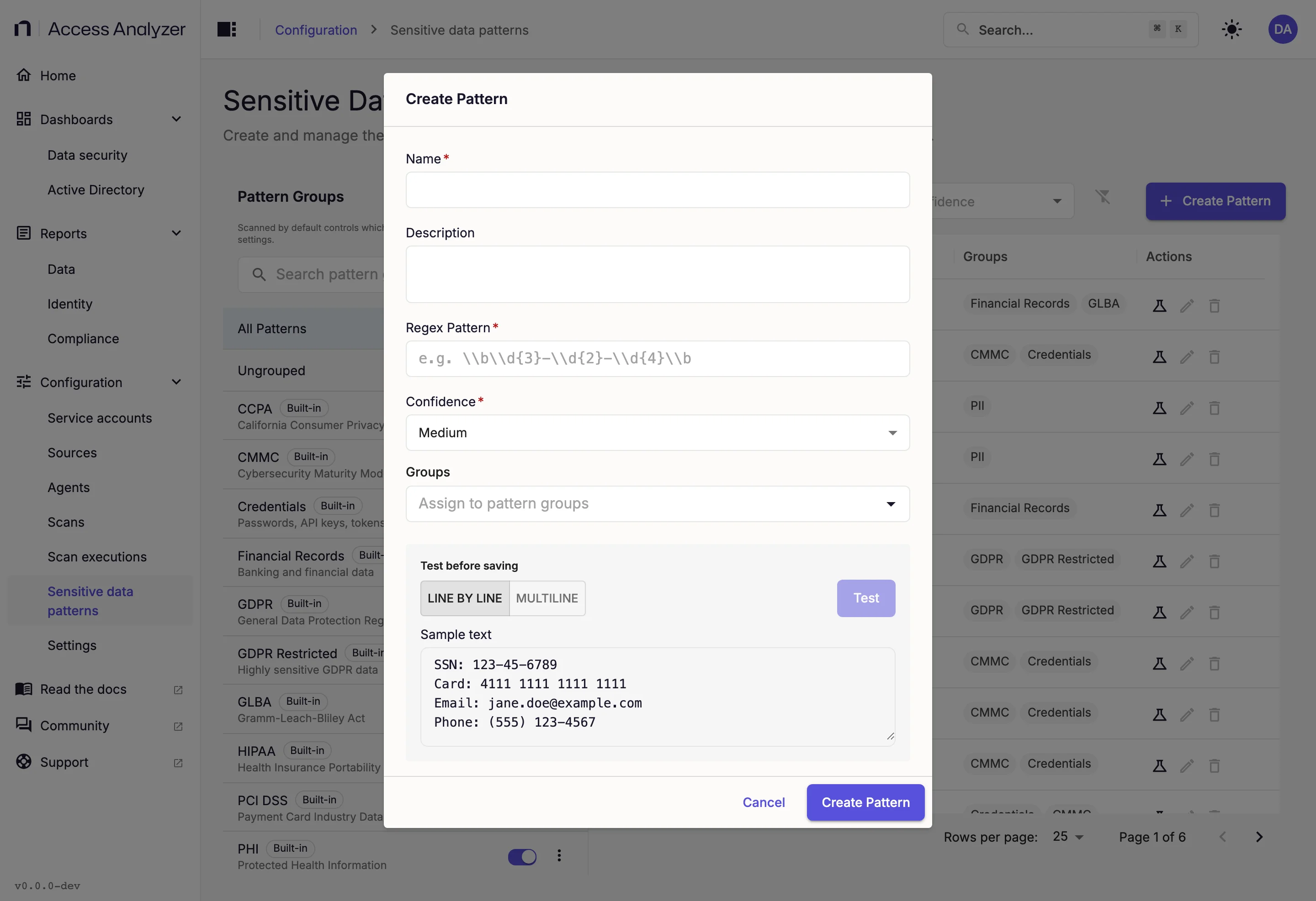

Create a Custom Pattern​
  1. Go to Configuration > Sensitive data patterns.
  2. Click Create Pattern.
  3. In Name, enter a name for the pattern.
  4. In Description, describe what the pattern detects.
  5. In Regex Pattern, enter the regular expression.
  6. In Confidence, select Low, Medium, or High.
  7. In Groups, select the pattern groups the pattern should belong to.
  8. Under Test before saving, replace the sample text with values that should match and values that shouldn't, one per line.
  9. Click Test.
  10. Adjust the expression until the results are right.
  11. Click Create Pattern.
Create Pattern dialog with Name, Description, Regex Pattern, Confidence, Groups, and Test before saving
The pattern appears in the table, and a message confirms the save: Pattern "<name>" created successfully.

Example: An Internal Employee ID​
Suppose employee IDs at your organization are the letters EMP, a hyphen, and six digits, and you want scans to flag documents that contain them.
Fill in the Create Pattern dialog like this:
FieldValue
NameEmployee ID
DescriptionInternal employee identifiers in the form EMP- followed by six digits.
Regex Pattern\bEMP-\d{6}\b
ConfidenceMedium
GroupsPII (personally identifiable information)
The word boundaries keep the pattern from matching inside longer tokens such as TEMP-123456 or EMP-1234567. Medium confidence is the right fit: the prefix is distinctive, but there is no checksum to rule out a made-up number. Putting the pattern in PII, a built-in group, means any scan that classifies that group picks it up without further configuration. Scans that inherit the global default set pick it up too, as long as PII is scanned by default.
Paste this into Sample text with Line by line selected and click Test:
Employee: EMP-004821
Manager: EMP-000317
Badge: 4821
Cost center: CC-004821
The tester tints the first two lines green and the last two red, and the status reads 2 of 4 lines matched. Click Create Pattern.
