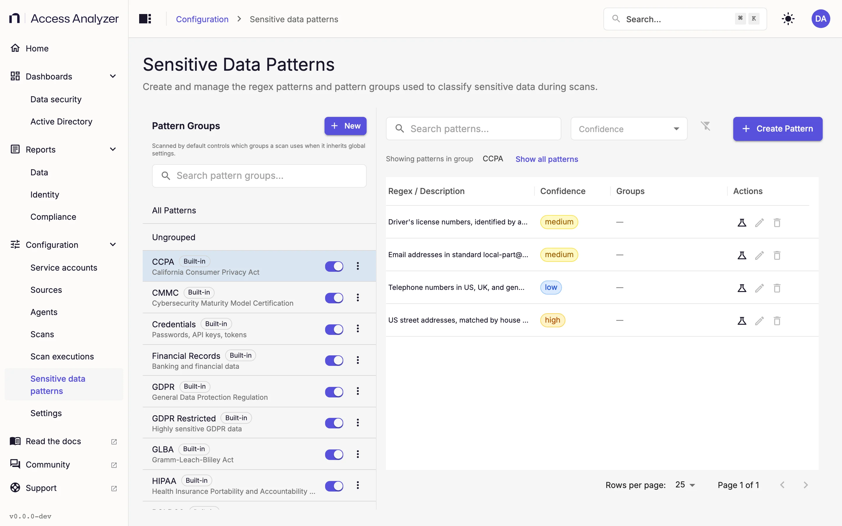

View the Patterns in a Group​
Click a group in the Pattern Groups panel. The patterns table filters to that group's patterns and shows Showing patterns in group together with the group name. Search and the Confidence filter keep working within the group.
Sensitive Data Patterns page filtered to the CCPA group
Click Show all patterns to return to the full list. The Ungrouped row works the same way for patterns that belong to no group.

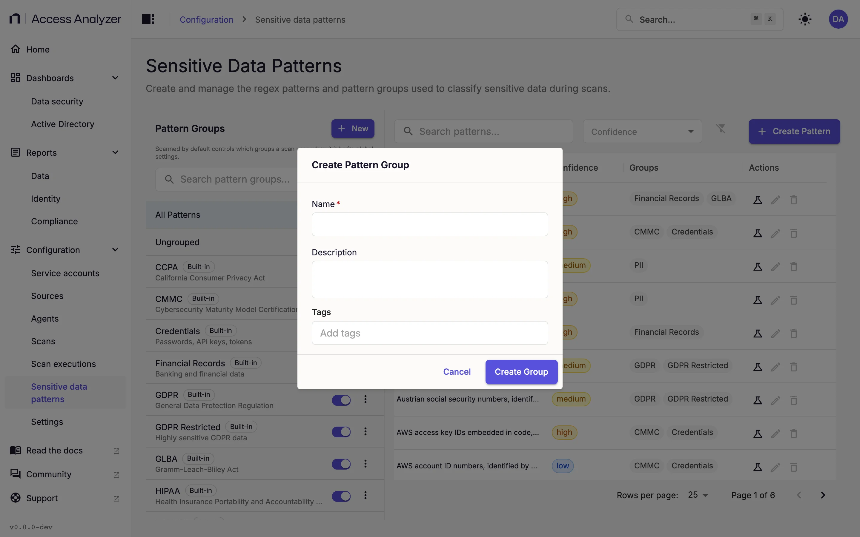

Create a Pattern Group​
  1. Go to Configuration > Sensitive data patterns.
  2. In the Pattern Groups panel, click New.
  3. In Name, enter a name for the group.
  4. In Description, describe what the group is for.
  5. In Tags, add any tags you want to attach to the group.
  6. Click Create Group.
Create Pattern Group dialog with Name, Description, and Tags
The group appears in the panel without a Built-in badge, and a message confirms the save: Pattern group "<name>" created successfully.
FieldRequiredDetails
NameYes1 to 255 characters. Group names are unique regardless of case, so hr data can't coexist with HR Data.
DescriptionNoUp to 2,000 characters. Shown under the group name in the panel and in the scan's group picker.
TagsNoFree-text keywords attached to the group.
A new group is empty. Add patterns to it with Manage patterns, or set the group in a pattern's Groups field when you create or edit the pattern.

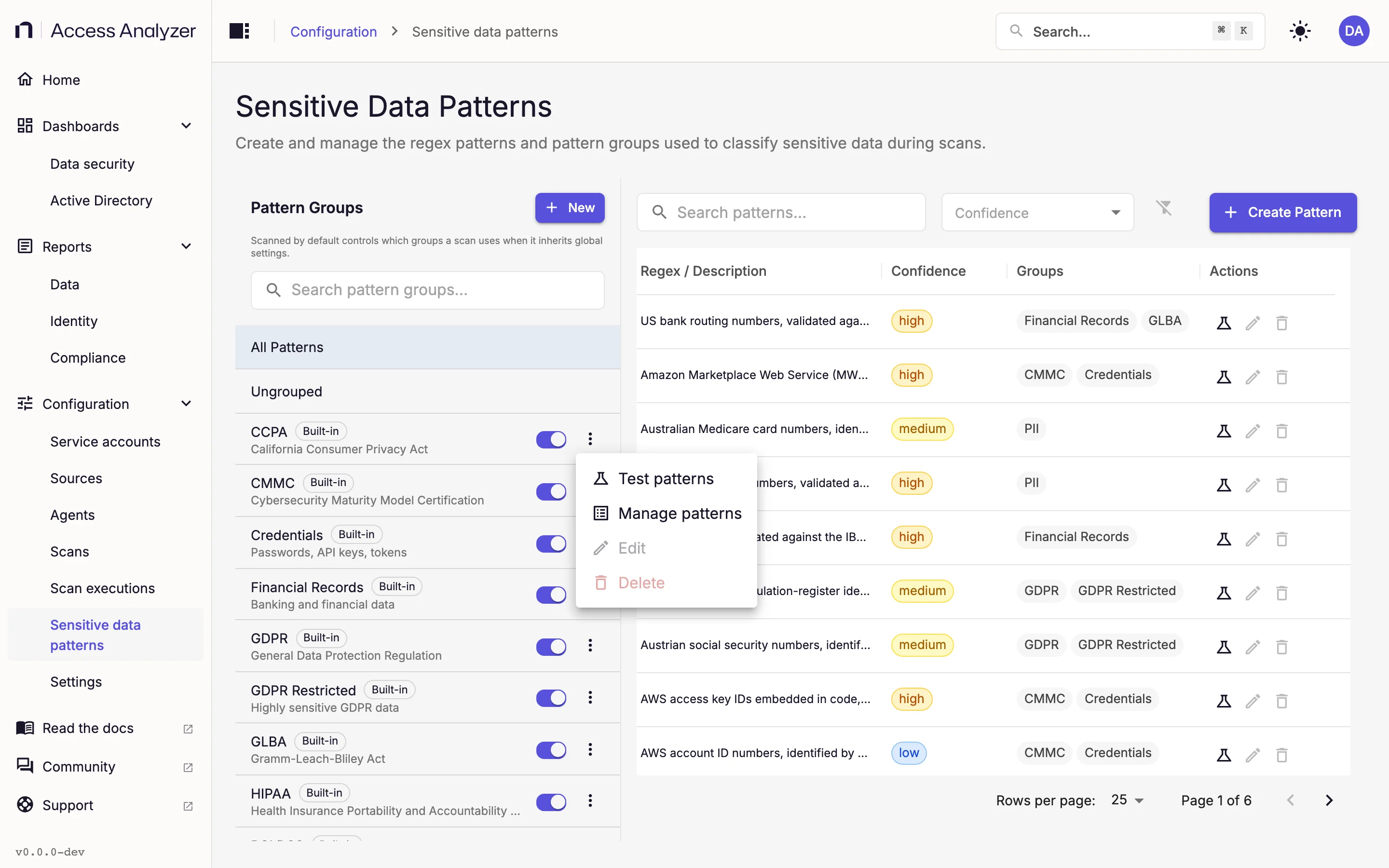

Edit a Pattern Group​
  1. In the Pattern Groups panel, open the group's actions menu.
  2. Click Edit.
  3. Change Name, Description, or Tags.
  4. Click Save Changes.
Pattern group menu with Test patterns, Manage patterns, Edit, and Delete
You can't edit or delete built-in groups. Scans and the default set refer to groups by name. After you rename a custom group, reselect it in any scan that picks its own groups, and check its Scanned by default switch.
Manage the Patterns in a Group​
  2. Click Manage patterns.
  3. Under Add existing patterns, select one or more patterns in Select patterns to add.
  4. Click Add Selected.
  5. To remove a pattern, click the remove icon next to it under Current patterns.
  6. Click Close.
A message confirms each change: Patterns added to the group. or Pattern removed from the group. Changes apply immediately; there is no separate save.
Manage patterns works on custom patterns only, in built-in and custom groups alike. Built-in patterns keep the memberships they ship with, so in a built-in group you can add your own patterns but can't change the built-in ones. A group with nothing added yet shows No patterns in this group yet.

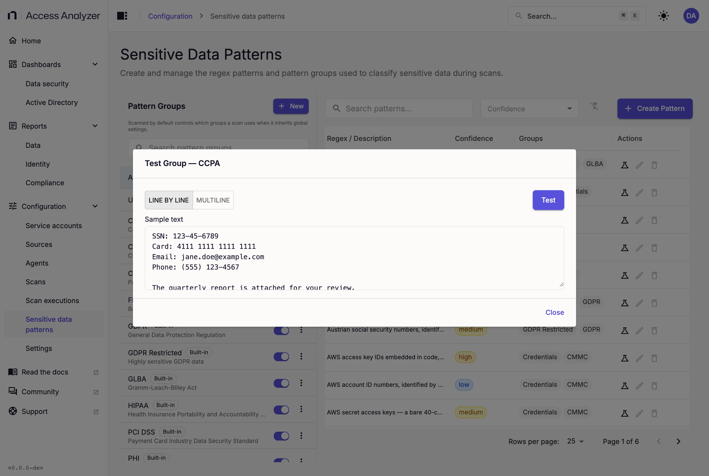

Test a Group's Patterns​
  2. Click Test patterns.
  3. Select Line by line or Multiline.
  4. In Sample text, paste text that should trigger the group's patterns.
  5. Click Test.
Test patterns dialog for a pattern group
The Test Group — <name> dialog shows one highlighted section per pattern in the group, headed by the pattern name, so you can see which patterns fired on which parts of the text. A pattern that fails to compile shows its error in red inside its own section, and the other patterns still run.
A group test shares a single 2-second limit across every pattern in the group, so keep samples short for large groups such as GDPR (General Data Protection Regulation). See Test patterns for the modes and result formats.

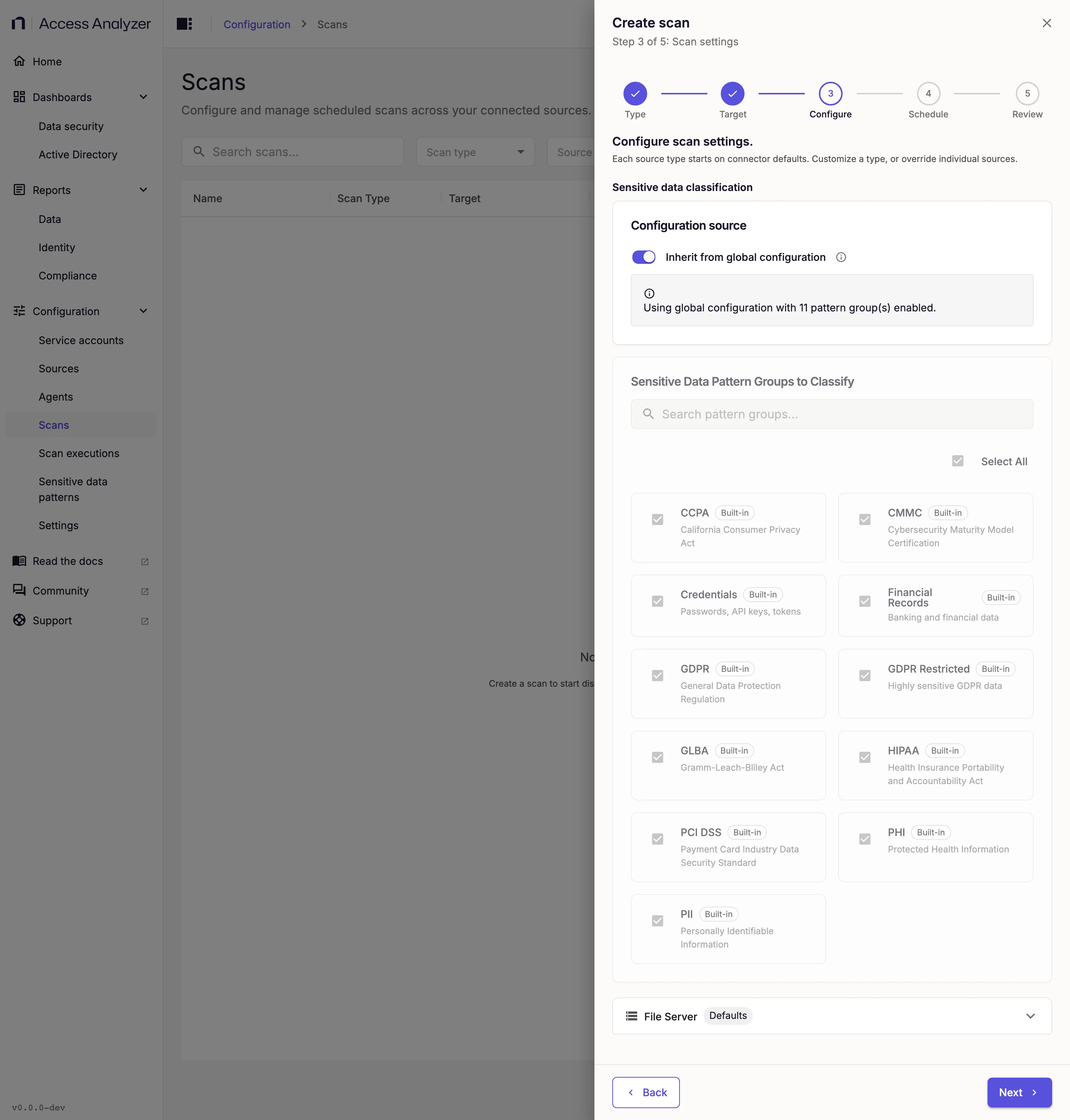

How a Scan Picks Its Groups​
On a Sensitive data scan's Configure step, the Sensitive data classification section has two cards. Configuration source holds the Inherit from global configuration switch, on for new scans. While it's on, the alert Using global configuration with <N> pattern groups enabled. tells you how many groups the default set holds. Turn it off to pick groups for this scan alone in Sensitive Data Pattern Groups to Classify, where you can search, select individual groups, or click Select All.
Sensitive data scan settings with pattern groups to classify
When the scan runs, it resolves its groups like this:
Two things follow from this:
  • An empty set means everything, not nothing. If no group is scanned by default and a scan inherits, or a scan overrides with no groups selected, the scan classifies against all groups, built-in and custom.
  • The scan matches groups by name. When the set isn't empty, it keeps findings only for patterns in groups with those names, so a scan that names a deleted group records nothing for it.
For the other Configure settings and their defaults, see Scan types; for creating, editing, and running a scan, see Scans.
