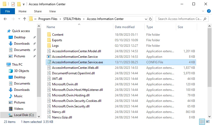

Step 1 – Open the AccessInformationCenter.Service.exeWeb.config file in a text editor, such as Notepad. The file is located in the Access Information Center installation directory:
…\Program Files\STEALTHbits\Access Information Center
AccessInformationCenter.Service.exe config file

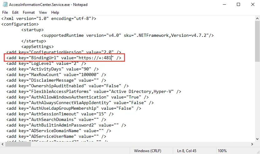

Step 2 – Change the BindingUrl key value to "https://+:481" (ensure the port number matches the port number used in the PowerShell command run to create the SSL Binding).
Step 3 – Save and close the file.
Step 4 – Navigate to Services (services.msc). Restart the Netwrix Access Information Center service.

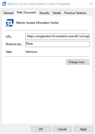

Step 1 – Right click the Access Information Center desktop shortcut and click Properties.
Access Information Center desktop icon properties
Step 2 – On the Web Document tab, enter the updated URL in the text box to: https://[hostname.domain.com]:481/v2/login
Step 3 – Click Apply and then OK to exit.
The URL is now updated.

Step 1 – Open the AccessInformationCenter.Service.exe.config file in a text editor, such as Notepad. The file is located in the Access Information Center installation directory:

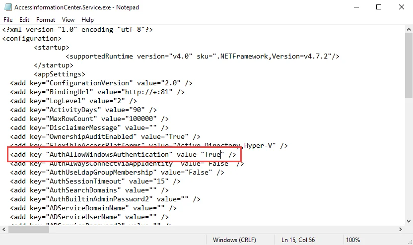

Step 2 – Locate the line containing the AuthAllowWindowsAuthentication parameter. By default, the value will be set to False:
<add key="AuthAllowWindowsAuthentication" value="False" />
Change the value for the AuthAllowWindowsAuthentication parameter to:
<add key="AuthAllowWindowsAuthentication" value="True" />
