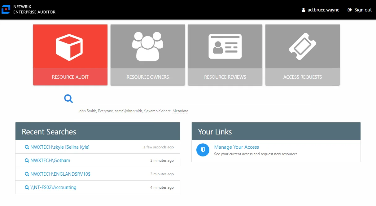

The audit interfaces are accessible from the home page of the Access Information Center.
Home page
The Resource Audit button opens the Resource Audit interface. The search features, which include a search bar and a Recent Searches box, can be used to open any audit interface.

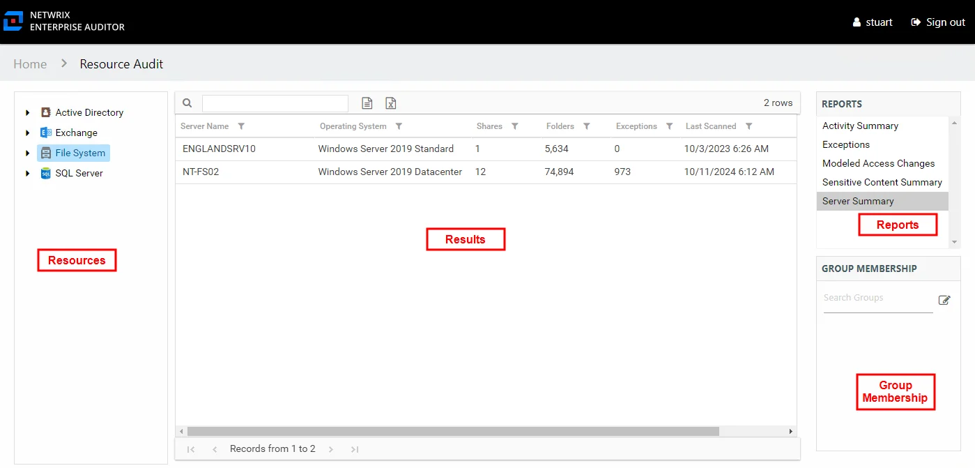

All audit interfaces consist of at least three components, and the Resource Audit interface includes a fourth pane.
Interface components
The main section of the audit interface is the Results pane. On the right-side of the page are the Reports and Group Membership panes. On the Resource Audit interface, the Resources pane is to the left of the Results pane. Theses panes have the following functions:
  • Reports Pane – Lists available reports for the resource type
  • Results Pane – Displays the report content
  • Group Membership Pane – Displays group membership for group trustees selected in the Results pane
  • Resources Pane – Navigation tree for the selected resource (only present in the Resource Audit interface)

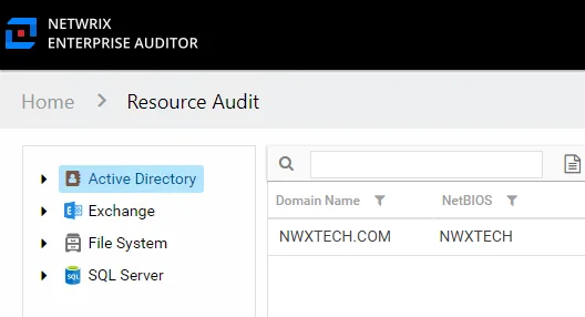

Resource Audit Interface
The Resource Audit interface is where resource reports are located. Summary and detail reports are available for permissions, effective access, activity, and sensitive data. Open the Resource Audit interface by clicking Resource Audit on the home page of the Access Information Center or using the search features to open a filtered view for a resource.
Available reports vary based on the type of resource and the level within the resource. See the following topics for specific report details:

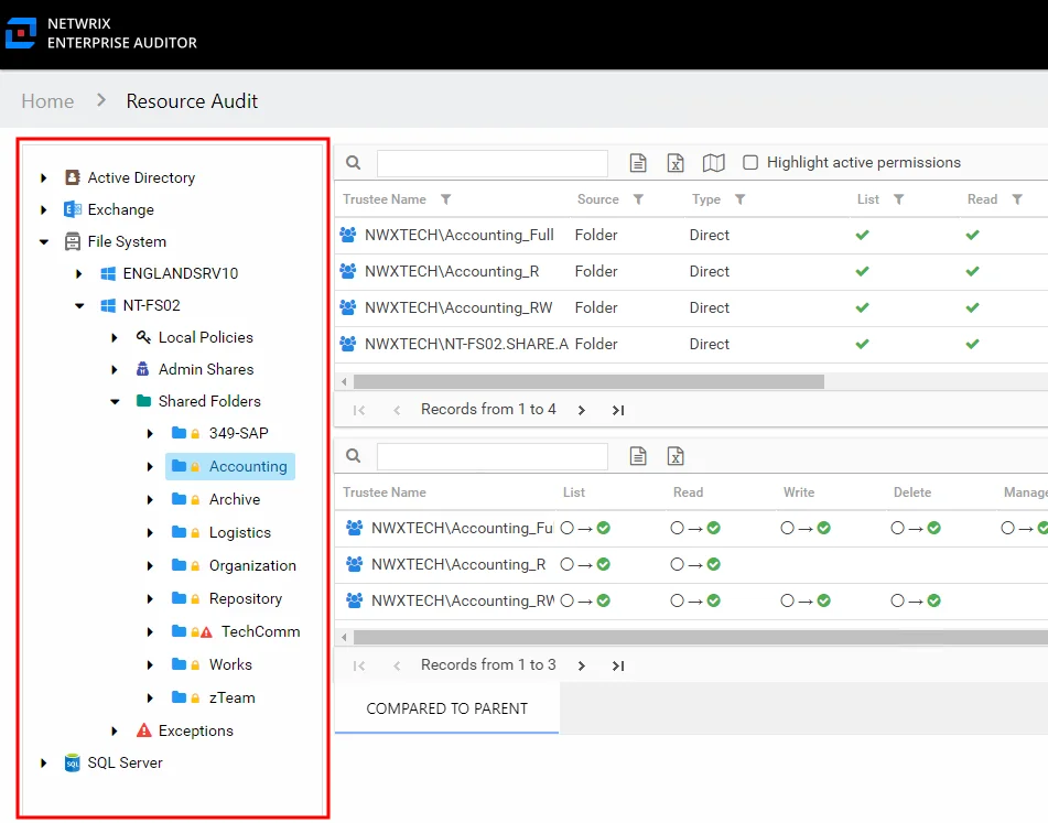

Resources Pane
The Resources pane, which is unique to the Resource Audit interface, displays a navigation view of available resources. Only those resource environments that have been scanned by Enterprise Auditor or introduced to the Access Information Center with Flexible Imports are available. Explore the desired resource by expanding the levels.
Resources pane
Select a resource in the Resources pane and a report in the Reports pane to to view the report data in the Results pane. Hover over any icon in the Access Information Center interface to view its description.
The Explicit Permissions, Exception, and Alert icons can shown next a resource icon in the Resources pane.
  • Explicit Permissions – Indicates permissions for the resource are different than the permission of its parent. This is caused by broken inheritance or adding new permissions to a resource.
