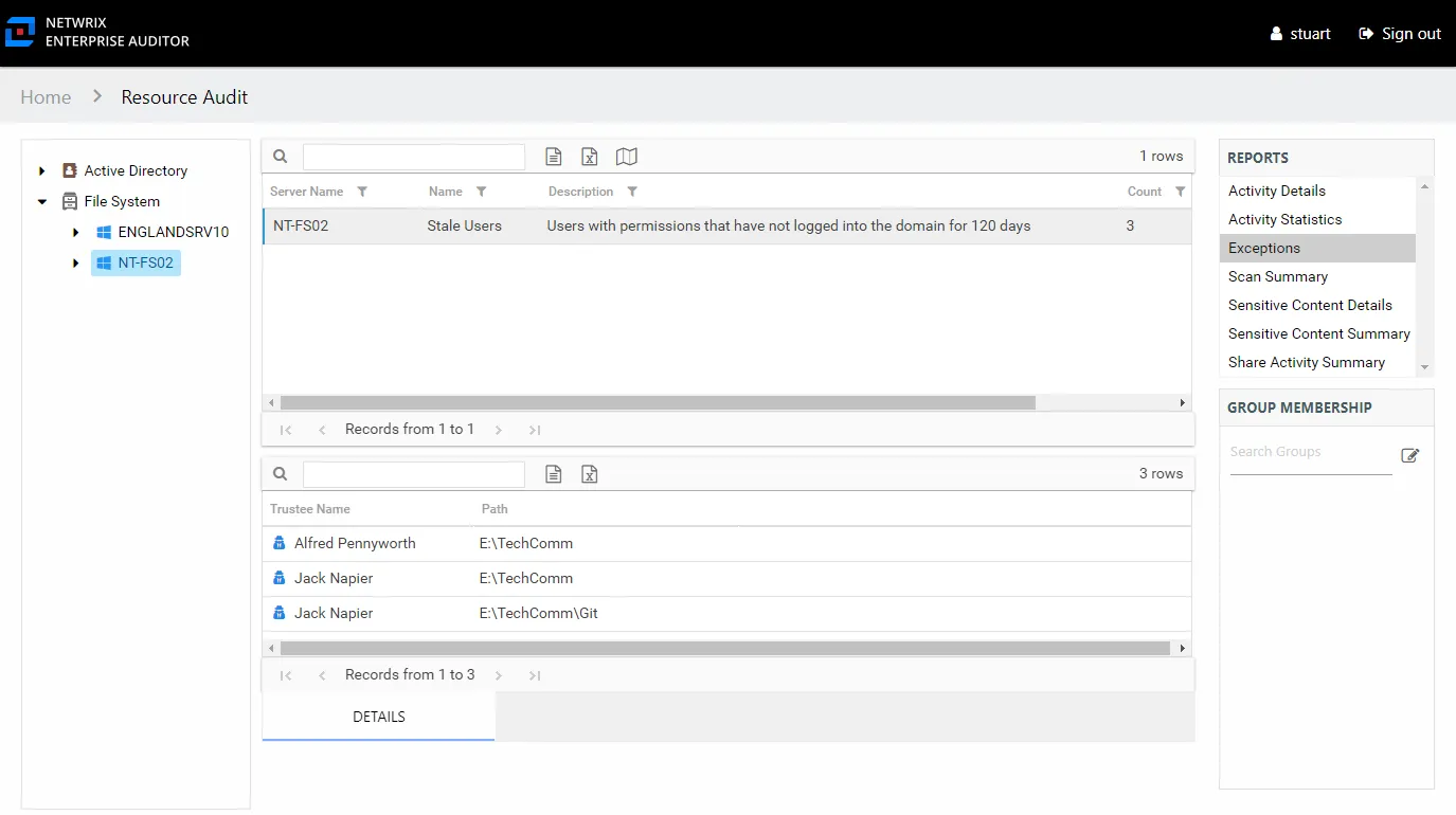

Exceptions Report
The Exceptions report at the server level provides a list of exceptions that were found within shares on the selected server. This report includes a Details table.
An exception is defined as a problem or risk to data governance security. Exceptions include open shares and permissions granted to stale or disabled users. This report will be blank if no exceptions were found on the selected server. It is comprised of the following columns:
  • Server Name – Name of the server
  • Name – Type of exception found
  • Description – Description of the exception type
  • Count – Number of this type of exception found on the server
There is one table at the bottom displaying Details for the selected exception:
  • Path – Location of the resource where the exception exists

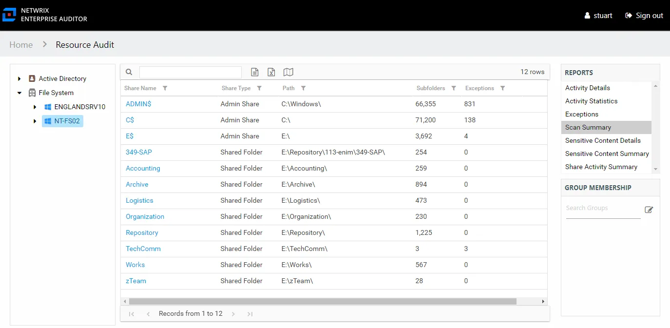

Scan Summary Report
The Scan Summary report at the server level provides a summary view of all shares on the selected server.
  • Share Name – Name of the share
  • Share Type – Admin or Shared type of share, an Admin share is a built-in share (for example, C$)
  • Path – Location of the share
  • Subfolders – Count of subfolders within the share
  • Exceptions – Count of exceptions within the share
