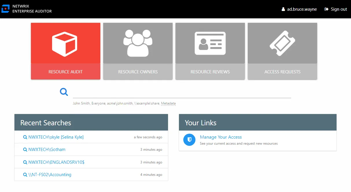

Audit Interfaces
The audit interfaces are accessible from the home page of the Access Information Center.
Home page
The Resource Audit button opens the Resource Audit interface. The search features, which include a search bar and a Recent Searches box, can be used to open any audit interface.

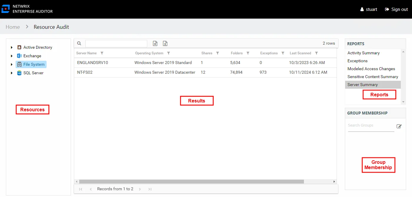

Interface Components
All audit interfaces consist of at least three components, and the Resource Audit interface includes a fourth pane.
Interface components
The main section of the audit interface is the Results pane. On the right-side of the page are the Reports and Group Membership panes. On the Resource Audit interface, the Resources pane is to the left of the Results pane. Theses panes have the following functions:
  • Reports Pane – Lists available reports for the resource type
  • Results Pane – Displays the report content
  • Group Membership Pane – Displays group membership for group trustees selected in the Results pane
  • Resources Pane – Navigation tree for the selected resource (only present in the Resource Audit interface)

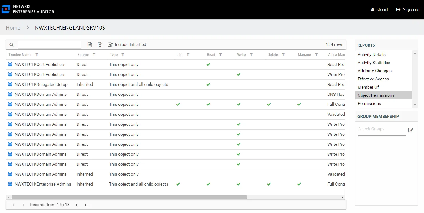

Computer Audit Interface
The Computer Audit interface is opened by searching for a particular computer. See the Search Features topic for additional information. It contains three panes in all audit interfaces: Reports, Results, and Group Membership.
The computer being audited is identified at the top of the interface as part of the interface breadcrumb. See the Computer Reports topic for additional information.

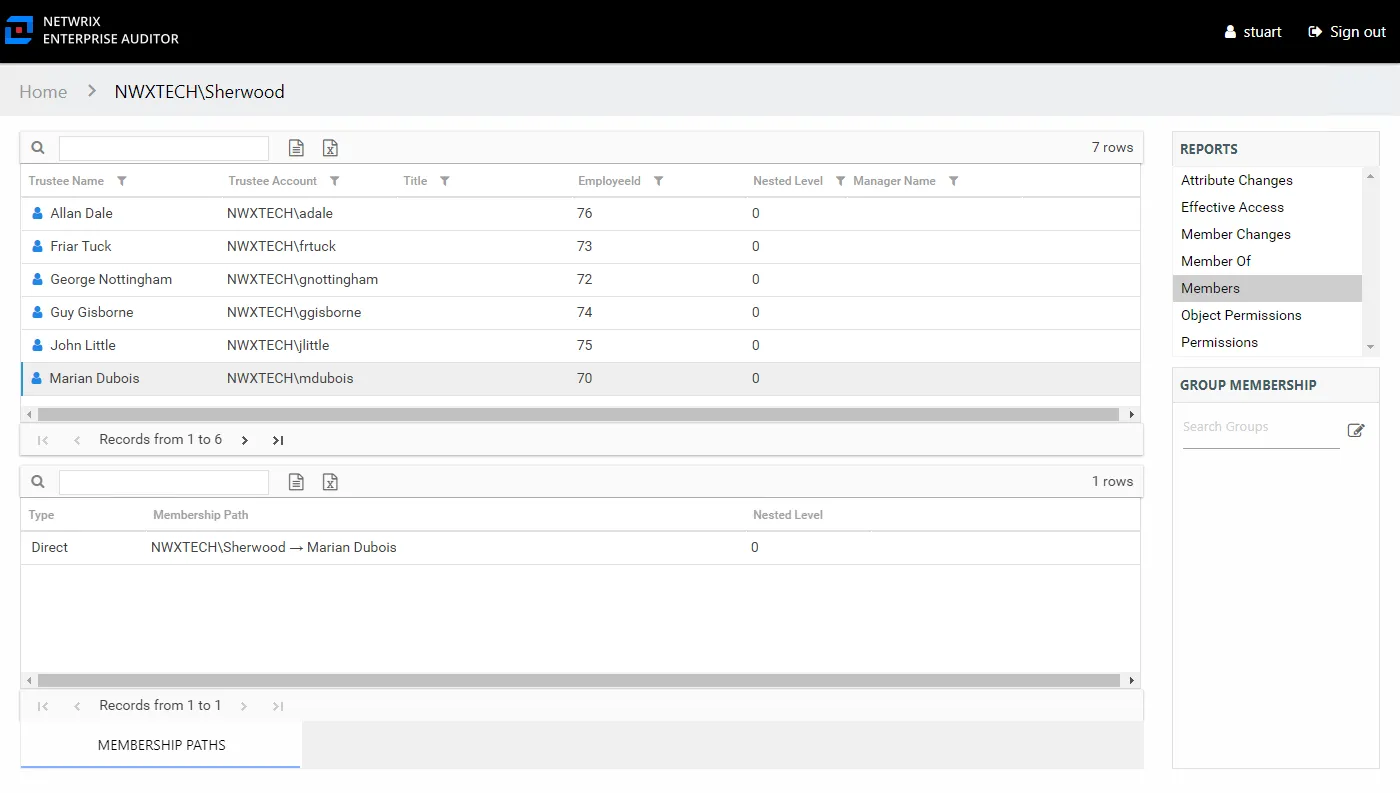

Group Audit Interface
The Group Audit interface is opened by searching for a particular Active Directory or Entra ID group. See the Search Features topic for additional information. It contains three panes in all audit interfaces: Reports, Results, and Group Membership.
The group being audited is identified at the top of the interface as part of the interface breadcrumb. See the Group Reports topic for additional information.

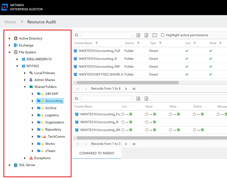

Resources Pane
The Resources pane, which is unique to the Resource Audit interface, displays a navigation view of available resources. Only those resource environments that have been scanned by Access Analyzer or introduced to the Access Information Center with Flexible Imports are available. Explore the desired resource by expanding the levels.
Resources pane
Select a resource in the Resources pane and a report in the Reports pane to to view the report data in the Results pane. Hover over any icon in the Access Information Center interface to view its description.
The Explicit Permissions, Exception, and Alert icons can shown next a resource icon in the Resources pane.
  • Explicit Permissions – Indicates permissions for the resource are different than the permission of its parent. This is caused by broken inheritance or adding new permissions to a resource.

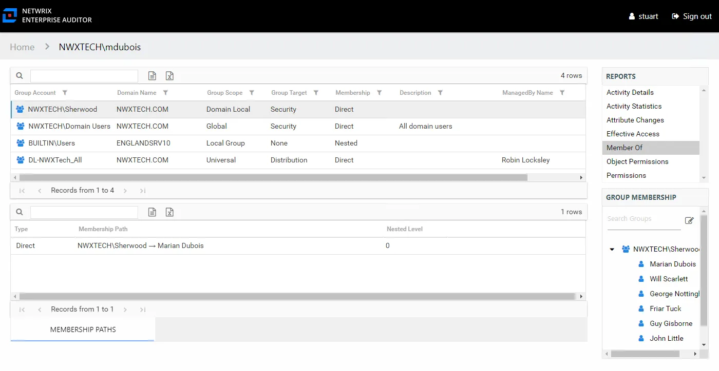

User Audit Interface
The User Audit interface is opened by searching for a particular Active Directory or Entra ID user. See the Search Features topic for additional information. It contains three panes in all audit interfaces: Reports, Results, and Group Membership.
The user being audited is identified at the top of the interface as part of the interface breadcrumb. See the User Reports topic for additional information.
