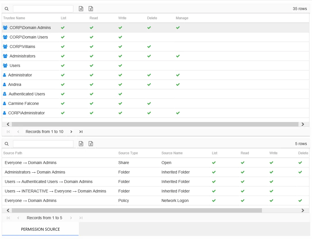

The Results pane displays report data based on the selections in both the Resources pane and the Reports pane. Reports may consist of multiple tables and graphs.
Results pane
Tables and graphs that display at the bottom of the pane vary according to the selected report. See the Data Grid Features topic for additional information on table options. See the individual report topics for specific information on columns and displayed data for a report.
Additional Report Options
There are two checkbox options depending on the report selected:
  • Include Subfolders – Select to include subfolders of the selected share or folder in the report
  • Highlight Active Permissions – Select to show permissions that are in use. When a user or effective member of a group that has permissions to a resource also has activity on the resource, a yellow icon is displayed for the permission type to indicate the access level used to perform the activity. Therefore, access level cells not highlighted when activity is being monitored represent stale permissions. See the Stale Permissions topic for additional information.
