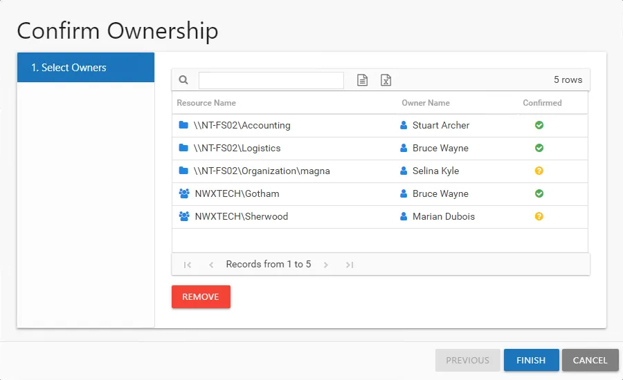

The Confirm Ownership wizard is opened with the Request Confirmation button in the Resource Owners interface. It can be opened for one or multiple resources.
Confirm Ownership wizard showing 1.Select Owners page
It contains one page:
  • 1. Select Owners — Lists the current owners for each selected resource and confirmation status

Step 1 – In the Resource Owners interface, select the resource or resources you want and click Request Confirmation. The Confirm Ownership wizard opens.
Step 2 – On the Select Owners page, you can optionally remove owners you don't want or need ownership confirmation from. Select those owners and click Remove. Those owners will not receive the confirmation email. After the list is set as desired, click Finish. The Access Information Center begins to send the confirmation email. The table provides the following information:
  • Resource Name — The icon indicates the type of resource. The resource name includes its location, such as the UNC path for a file system resource, the URL for SharePoint resource, or Group name (e.g., [Domain][Group]).
  • Owner Name — Name of the assigned owner
  • Confirmed — Indicates whether the assigned owner has confirmed ownership of that resource. Tool-tips display when hovering over the icons indicating whether the resource ownership has been confirmed, declined, pending response, or that a confirmation has not been requested.
