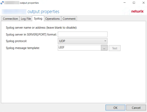

Syslog Tab
The Syslog tab on an output Properties window is where the SIEM integration settings can be modified. These settings are initially configured when the output is added. For a monitored hosts output, this tab can also be used for integration with Netwrix Threat Manager.
Select a Syslog output from either the Monitored Domains tab or the Monitored Hosts tab and click Edit to open the output Properties window. The tab varies based on the type of domain/host selected.

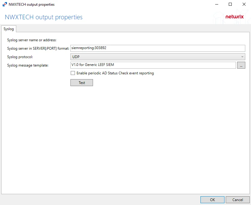

For Active Directory Domains
The tab contains the following settings:
Syslog server in SERVER:PORT format – Server name of the SIEM server and the communication port being used between the applications. The format must be SERVER:PORT, e.g. newyorksrv20:10000.
- The server name can be short name, fully qualified name (FQDN), or IP Address, as long as the organization’s environment can resolve the name format used.
Syslog protocol – Identifies which protocol is used for the Event stream. The drop-down menu includes: UDP, TCP, and TLS.
Message framing – The TCP and TLS Syslog protocols require Message framing to be set. The drop-down menu includes: LS (ASCII 10) delimiter, CR (ASCII 13) delimiter, CRLF (ASCII 13, 10) delimiter, NUL (ASCII 0) delimiter, and Octet Count (RFC 5425).
Syslog message template – Template that controls what data is sent in the event stream. The ellipsis (…) button opens the Syslog Message Template window. See the Message Template Window topic for additional information.
Enable periodic AD Status Check event reporting – Indicates periodic AD Status Check event reporting is enabled, which means the agent will send out status messages every five minutes to verify whether the connection is still active.
The Test button sends a test message to the Syslog server to check the connection. A green check mark or red x will indicate whether the test message has been sent or failed to send. Test messages vary by Syslog protocol:
- UDP protocol – Sends a test message and does not verify connection
- TCP protocol – Sends test message and verifies connection
- TLS protocol – Sends test message and verifies connection and shows an error if TLS handshake fails
Click OK to commit the modifications. Click Cancel to discard the modifications. The output Properties window closes.

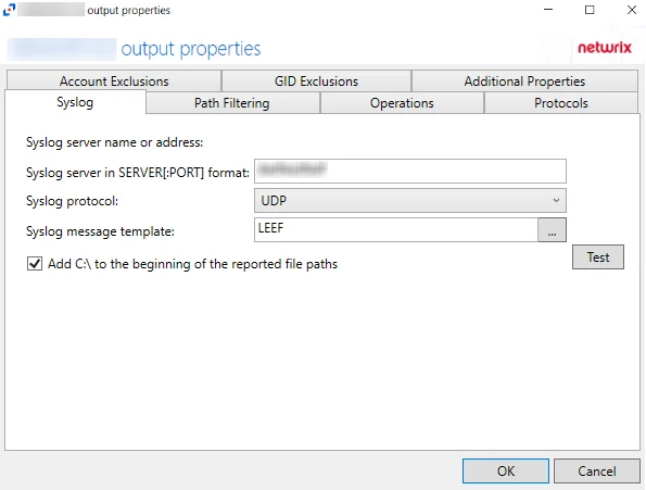

For Linux Hosts
- The default port for Netwrix Threat Manager is 10001.
- UPD is the only protocol supported for Threat Manager.
Add C:\ to the beginning of the reported file paths – Indicates a Windows-style drive path (C:) is added to the beginning of the NAS file paths in the activity data stream, e.g.
C:\Folder\file.txt

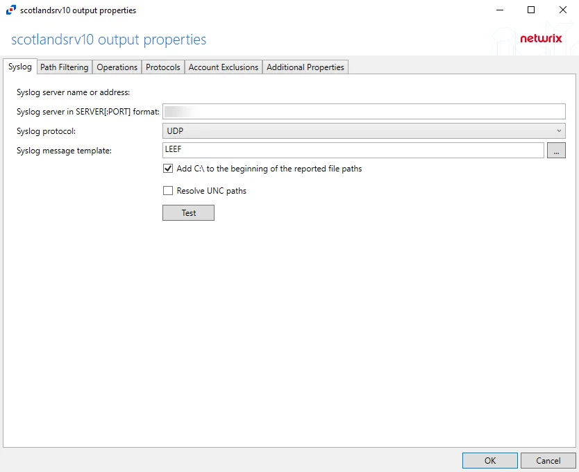

Resolve UNC paths

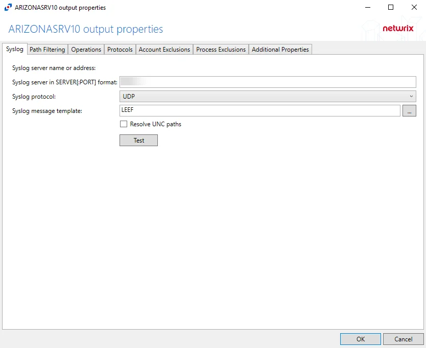

For Windows File Server Hosts
Resolve UNC paths

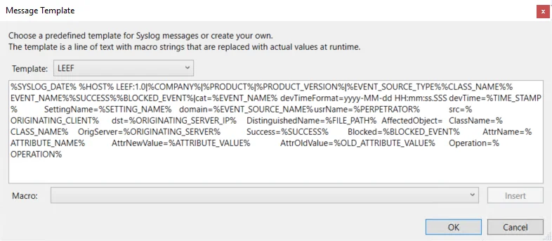

The Message Template window is opened from the ellipsis (…) button for the Syslog Message Template field on the Syslog tab of the output Properties window.
You can select a preconfigured template from the drop-down menu or create a custom template. The available preconfigured templates vary based on the type of domain/host selected.

SharePoint SharePoint Online | %EVENT_SOURCE% | Originating source of the event (SharePoint or ObjectModel) |
File Servers & NAS Devices | %EVENT_SOURCE_NAME% | Domain name |
SharePoint SharePoint Online | %EVENT_TYPE% | Event type |
File Servers & NAS Devices | %FILE_NAME% | File name |
File Servers & NAS Devices | %FILE_PATH% | Full path |
File Servers & NAS Devices | %FILE_SIZE% | Size of File |
File Servers & NAS Devices | %FILE_TYPE% | File extension |
SharePoint | %FULL_PATH% | Full Path |
File Servers & NAS Devices SharePoint SharePoint Online | %HOST% | Hostname of Agent |
SharePoint Online | %ID% | Unique ID of the audit record |
File Servers & NAS Devices | %IO_TYPE% | Type of I/O: Filesystem/VSS |
SharePoint | %ITEM_ID% | Item ID |
SharePoint SharePoint Online | %ITEM_TITLE% | Item title |
SharePoint SharePoint Online | %ITEM_TYPE% | Item type (File, Folder, Web, Site, Tenant, DocumentLibrary, Page) |
SharePoint Online | %LIST_ID% | ID of the List |
SharePoint Online | %LIST_ITEM_ID% | ID of the List Item |
SharePoint Online | %LIST_NAME% | Name of the List |
SharePoint Online | %LIST_URL% | URL of the List |
SharePoint | %LOCATION_TYPE% | Location type of the SharePoint document location |
SharePoint Online | %MACHINE_DOMAIN_INFO% | Information about device sync operation |
SharePoint Online | %MACHINE_ID% | Information about device sync operation |
SharePoint Online | %NEW_DOC_LOCATION% | A relative URL to which the object is copied or moved |
File Servers & NAS Devices | %NEW_FILE_NAME% | Rename event only: New file name |
File Servers & NAS Devices | %NEW_FILE_PATH% | Rename event only: New full path |
File Servers & NAS Devices | %NEW_FILE_TYPE% | New File Extension |
File Servers & NAS Devices | %OBJECT_TYPE% | Object type: FILE/FOLD/UNK |
File Servers & NAS Devices | %OLD_ATTRIBUTE_VALUE% | Rename only: Old file path |
File Servers & NAS Devices | %OPERATION% | Operation type: Read/Create/Update/Delete/Access Rights Change/Rename/Unknown |
SharePoint Online | %ORGANIZATION_ID% | Organization tenant ID |
File Servers & NAS Devices | %ORIGINATING_CLIENT% | IP Address of originating client or process name |
File Servers & NAS Devices | %ORIGINATING_CLIENT_HOST% | Hostname of originating client |
File Servers & NAS Devices | %ORIGINATING_SERVER% | Hostname of monitored host |
File Servers & NAS Devices | %ORIGINTAING_SERVER_IP% | IP Address of monitored host |
SharePoint | %PARAM% | Parameters that come with the event |
SharePoint | %PATH% | Truncated path |
File Servers & NAS Devices | %PERMISSIONS_SDDL_DESCRIPTION% | Windows events only: Permission change details in readable format |
File Servers & NAS Devices | %PERMISSIONS_SDDL_DIFF% | Windows events only: Permission change details in SDDL format, '<REMOVED> <ADDED>' |
File Servers & NAS Devices | %PERPETRATOR% | User name |
File Servers & NAS Devices SharePoint SharePoint Online | %PRODUCT% | Fixed string: Activity Monitor |
File Servers & NAS Devices SharePoint SharePoint Online | %PRODUCT_VERSION% | Product Version |
File Servers & NAS Devices SharePoint SharePoint Online | %PROTOCOL% | Protocol type: CIFS/NFS/VSS/FTP/HDFS/HTTP/HTTPS/Unknown |
File Servers & NAS Devices | %PROTOCOL_VERSION% | NetApp Data ONTAP Cluster-Mode device events only: Protocol Version |
File Servers & NAS Devices | %RENAMEUNCPATH% | Rename events only: New UNC path / New NFS export path |
SharePoint Online | %RESULT_STATUS% | Succeeded, PartiallySucceeded, Failed, True, or False |
SharePoint Online | %SCOPE% | online or onprem |
SharePoint Online | %SHARING_ID% | Unique ID of the sharing operation |
SharePoint SharePoint Online | %SITE_ID% | ID of the Site |
SharePoint Online | %SITE_NAME% | Name of the Site |
SharePoint SharePoint Online | %SITE_URL% | URL of the Site |
SharePoint Online | %SOURCE% | Source (SharePoint, SharePointFileOperation, …) |
SharePoint Online | %SOURCE_FILE_EXT% | File extension |
SharePoint Online | %SOURCE_FILENAME% | File or folder name |
SharePoint | %SOURCE_NAME% | Source Name |
SharePoint Online | %SOURCE_RELATIVE_PATH% | URL of the folder that contains the file accessed by the user |
File Servers & NAS Devices SharePoint SharePoint Online | %SUCCESS% | True if the operation was allowed, False otherwise |
File Servers & NAS Devices SharePoint SharePoint Online | %SYSLOG_DATE% | Timestamp of event (server time, Syslog format: MMM dd HH:mm:ss) |
File Servers & NAS Devices | %TAGS% | Operation Tags. Reports 'Copy' for events that are probable copies |
SharePoint Online | %TARGET_NAME% | UPN or name of the target user or group that a resource was shared with |
SharePoint Online | %TARGET_TYPE% | Type of target user or group that a resource was shared with (Member, Guest, Group, or Partner) |
File Servers & NAS Devices SharePoint SharePoint Online | %TIME_STAMP% | Timestamp of event (server time, format: yyyy-MM-dd HH:mm:ss.zzz) |
SharePoint Online | %TIME_STAMP_OFFSET% | Timestamp of event with timezone offset (server time, format: yyyy-MM-ddTHH:mm:ss.zz+HH:mm) |
File Servers & NAS Devices SharePoint SharePoint Online | %TIME_STAMP_UTC% | Timestamp of event (UTC, format: yyyy-MM-dd HH:mm:ss.zzz) |
SharePoint Online | %TIME_STAMP_Z% | Timestamp of event (UTC, format: yyyy-MM-ddTHH:mm:ss.zzZ) |
File Servers & NAS Devices | %UNCPATH% | UNC path / NFS export path |
SharePoint Online | %UPDATE_TYPE% | Added, Removed, or Updated |
SharePoint Online | %USER_AGENT% | User client or browser |
SharePoint SharePoint Online | %USER_ID% | - For SharePoint, ID of the SharePoint user - For SharePoint Online, UPN of the user who performed the operation |
SharePoint SharePoint Online | %USER_LOGIN% | - For SharePoint, SharePoint User Login / Encoded Claim - For SharePoint Online, An alternative ID of the user. “DlpAgent” for DLP events. |
SharePoint SharePoint Online | %USER_NAME% | SharePoint user name |
File Servers & NAS Devices SharePoint | %USER_SID% | User SID or UID |
SharePoint Online | %USER_TYPE% | Type of the user performed the operation |
SharePoint Online | %VERSION% | New version of the document/version of deleted document |
SharePoint | %WEB_APPLICATION_NAME% | Title of the SharePoint Web Application |
SharePoint SharePoint Online | %WEB_TITLE% | Title of the Site Collection |
SharePoint Online | %WORKLOAD% | Office 356 service where the activity occurred |
