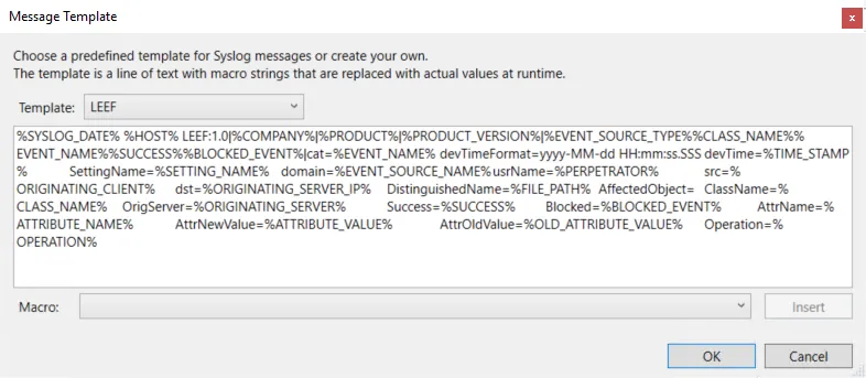

Syslog – Sends activity events to the configured SIEM server

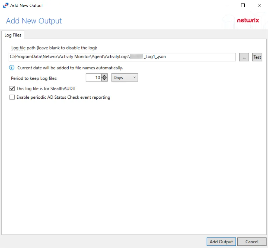

Add File Output
Follow the steps to add a File output.
Step 1 – On the Monitored Domains tab, select the desired domain and click Add Output.
Step 2 – Select File from the drop-down menu. The Add New Output window opens.
Step 3 – Configure the tab(s) as desired.
Step 4 – Click Add Output to save your settings. The Add New Output window closes.
The new output displays in the table. Click the Edit button to open the Output properties window to modify these settings. See the Output Types topic for additional information.

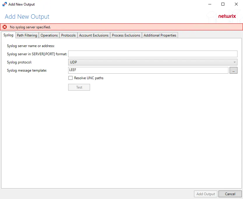

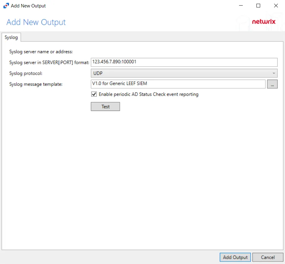

Add Syslog Output
Follow the steps to add a Syslog output.
Step 2 – Select Syslog from the drop-down menu. The Add New Output window opens.

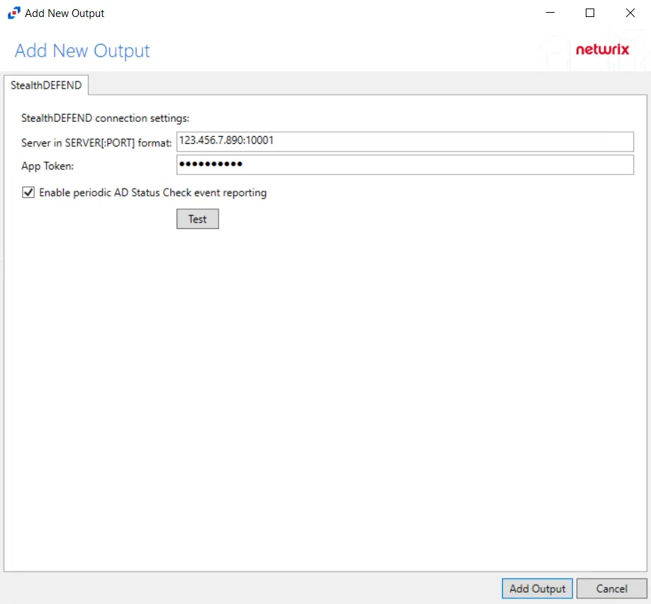

Add Netwrix Threat Manager Output
NOTE: An App Token created by Netwrix Threat Manager is used to authenticate connection between the applications. See the App Tokens Page topic of the Netwrix Threat Manager Documentation for additional information.
Follow the steps to add a Netwrix Threat Manager output.
Step 2 – Select Netwrix Threat Manager (StealthDEFEND) from the drop-down menu. The Add New Output window opens.

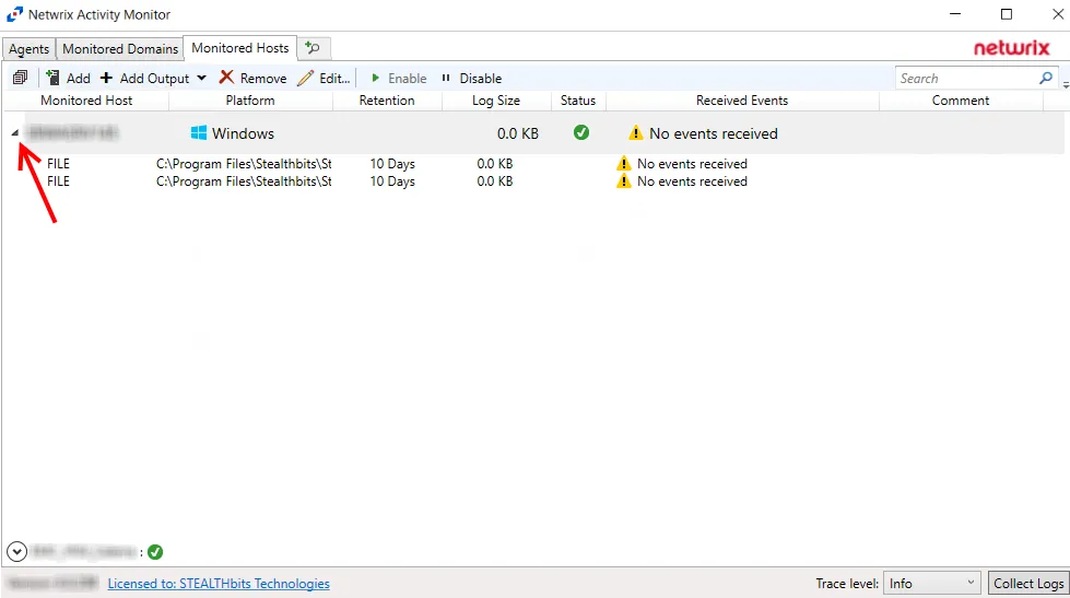

Additional Properties Tab
The Additional Properties tab on an output Properties window is where comments and displayed host name can be modified. These settings are initially configured when the output is added.
Select an output from the Monitored Hosts tab and click Edit to open the output Properties window.
The options are:
- Report hostname as – The value entered here will customize the hostname that is reported for the event in the activity log outputs
- Comment – The value entered here will appear in the Comments column in the Monitored Hosts tab table.
Often, the Additional Properties Tab is used to indicate the purpose of the output, e.g. for Netwrix Access Analyzer (formerly Enterprise Auditor). This can be useful if using multiple outputs with different configurations for different purposes. For example, a SharePoint site could be added as a host and configured for Netwrix Access Analyzer (formerly Enterprise Auditor) data collection. It can be added again with different monitoring options and be configured for SIEM notification.
Click OK to commit the modifications. Click Cancel to discard the modifications. The output Properties window closes.

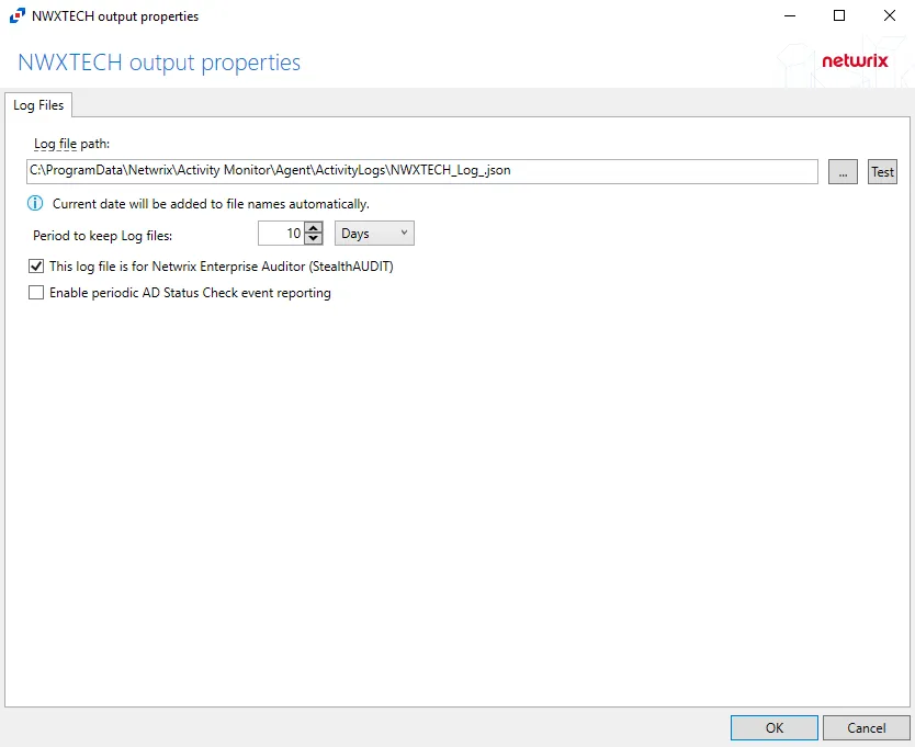

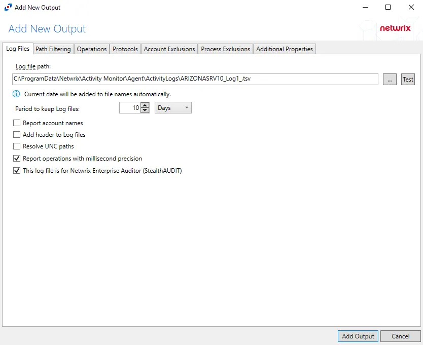

Log Files Tab
The Log Files tab on an output Properties window is where the activity log settings can be modified. These settings are initially configured when the output is added.
Select a File output from either the Monitored Domains tab or the Monitored Hosts tab and click Edit to open the output Properties window. The tab varies based on the type of domain/host selected.
For Active Directory Domains
The tab contains the following settings:
Log file path – Identifies the full path of the activity log files on the activity agent server. The date timestamp is appended to the file name automatically.
Period to keep Log files – Activity logs are deleted after the number of days entered. The default is 10 days. The Active Directory activity log settings also affect log size by controlling the information recorded per event.
NOTE: This setting effects activity log retention whether or not the archiving feature is enabled.
RECOMMENDED: Keep a minimum of 10 days of activity logs. Raw activity logs should be retained to meet an organization’s audit requirements.
This log file is for Netwrix Access Analyzer (formerly Enterprise Auditor) (StealthAUDIT) – Indicates whether Netwrix Access Analyzer (formerly Enterprise Auditor) collect the data from this configured output
NOTE: While the Activity Monitor can have multiple configurations per host, Netwrix Access Analyzer (formerly Enterprise Auditor)can only read one of them.
Enable periodic AD Status Check event reporting – Indicates periodic AD Status Check event reporting is enabled, which means the agent will send out status messages every five minutes to verify whether the connection is still active.

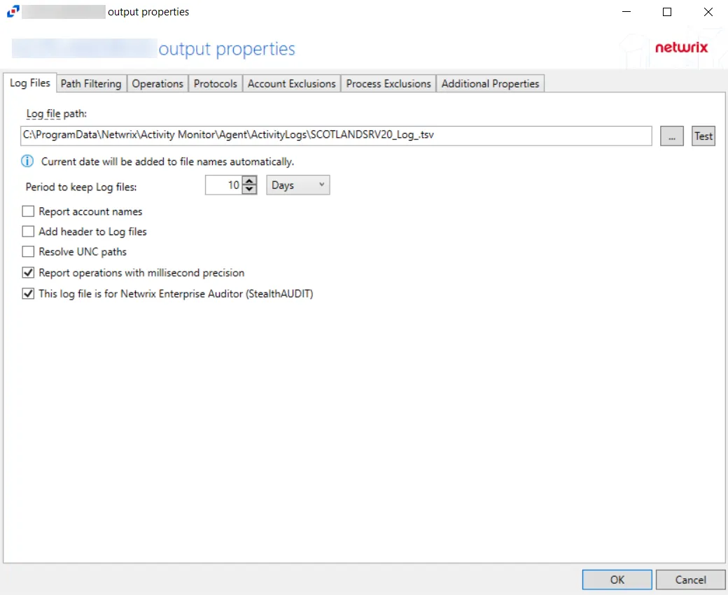

For File Server and NAS Device Hosts
- For integration with Netwrix Access Analyzer (formerly Enterprise Auditor) File System Solution, this value must be higher than the number of days between the 0.Collection > 1-FSAC System Scans Job scans. See the Netwrix Access Analyzer Documentation for additional information.
- For integration with Netwrix Threat Prevention NAS monitoring, this setting only controls the log retention period for NAS devices, as Netwrix Threat Prevention does not read Windows file server activity from Activity Monitor.
Report account names – Indicates if an Account Name column is added in the activity log files
Add header to Log files – Indicates if headers are added in the activity log filesAdd header to Log files – Indicates if headers are added in the activity log files
NOTE: This is needed to feed data into Splunk in a Syslog output. However, Netwrix Access Analyzer (formerly Enterprise Auditor) does not support log files with headers. Therefore, do not select this option for a File output designed for Netwrix Access Analyzer (formerly Enterprise Auditor).
Report UNC paths – Indicates if a UNC Path column and a Rename UNC Path column are added in the activity log files. This option corresponds to the REPORT_UNC_PATH parameter in the INI file. When the option is enabled, the added columns are populated when a file is accessed remotely through the UNC Path. If a file is accessed locally, these columns are empty.
The UNC Path is in the following format:
- For CIFS activity – The path is in
\\[HOST]\[SHARE]\[PATH]
format, e.g.\\ExampleHost\TestShare\DocTeam\Temp.txt
- For NFS activity – The path is in
[HOST]:/[VOLUME]/[PATH]
format, e.g.ExampleHost:/ExampleVolume/DocTeam/Temp.txt
NOTE: When this option is selected, a warning message might be displayed.
Report operations with millisecond precision – Indicates the timestamps of events being recorded in the activity log file has been changed for better ordering of events if multiple events occur within the same second

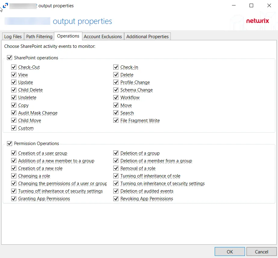

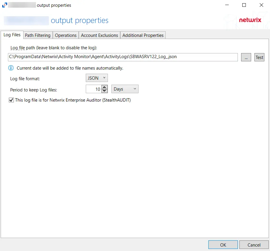

For SharePoint Hosts
Log file format – Indicates the file type used for the activity log. The default is JSON. See SharePoint JSON Log File topic and the SharePoint TSV Log File topic for additional information.

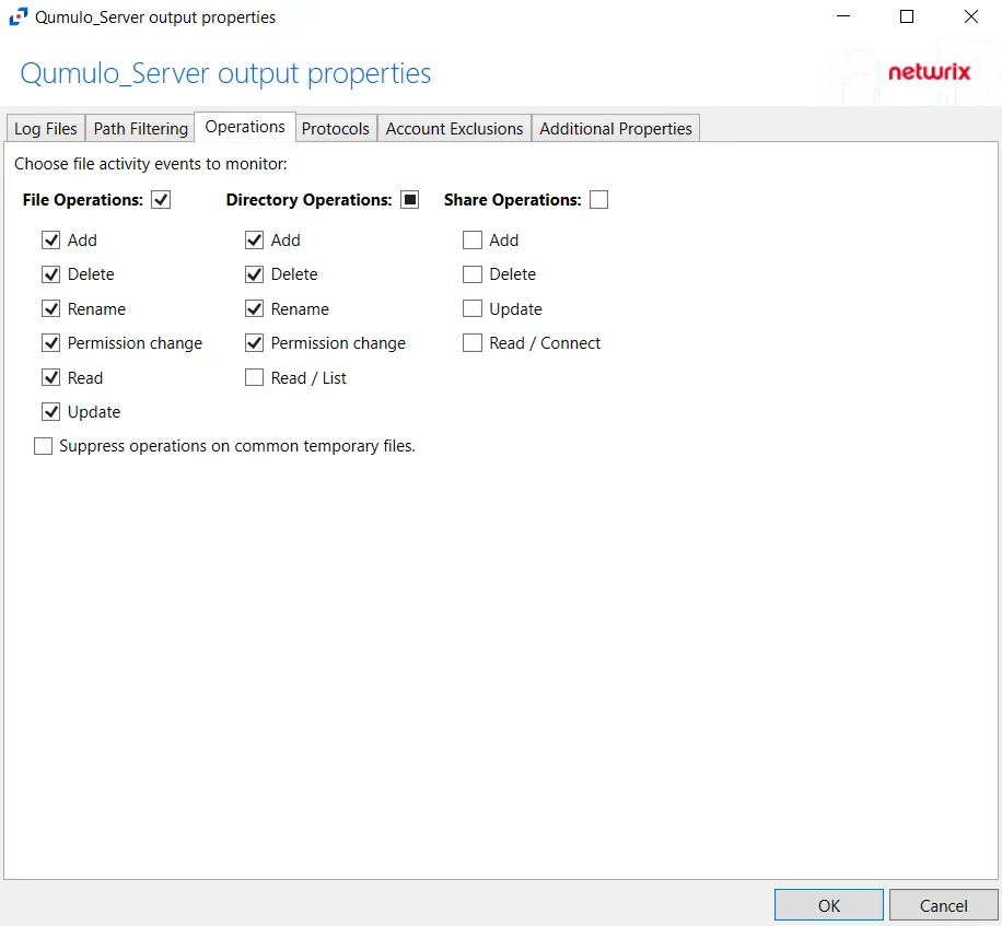

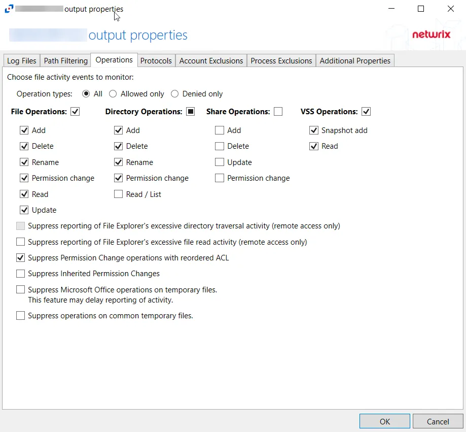

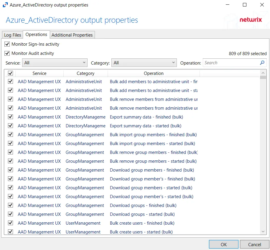

Operations Tab
The Operations tab on an output Properties window is where monitoring scope by operation can be modified. These settings are initially configured when the output is added.
Select an output from the Monitored Hosts tab and click Edit to open the output Properties window. The tab varies based on the type of host selected.
For Linux Hosts
The tab contains the following settings and features:
Use the options in the Operations tab to filter the list of available audit activities. The options are:
- File Operations – Scope by file operation events: Add, Delete, Rename, Permission change, Read, Update
- Directory Operations – Scope by directory operation events: Add, Delete, Rename, Permission change, Read / List
For Microsoft Entra ID Hosts
- Monitor Sign-Ins activity – Indicates if user sign-ins activity is monitored
- Monitor Audit activity – Indicates if audit for all operations is monitored
- Service – Filter the table by Service using the drop-down menu
- Category – Filter the table by Category using the drop-down menu
- Operation – Filter the table by Operation using the textbox
The table lists operations being monitored, displaying columns for Service, Category, and Operation.

For Qumulo Hosts
- Share Operations – Scope by share operation events: Add, Delete, Update, Read / Connect
- Suppress operations on common temporary files – Filters out events for common temporary files. With this option enabled, events for these common temporary files are ignored.
For SharePoint Host
- SharePoint operations – Scope by SharePoint operation events: Check-Out, View, Update, Child Delete, Undelete, Copy, Audit Mask Change, Child Move, Custom, Check-In, Delete, Profile Change, Schema Change, Workflow, Move, Search, File Fragment Write
- Permission Operations – Scope by permission operation events: Creation of a user group, Addition of a new member to a group, creation of a new role, Changing a role, Changing the permissions of a user or group, Turning off inheritance of security settings, Granting App Permissions, Deletion of a group, Deletion of a member from a group, Removal of a role, Turning off inheritance of role, Turning on inheritance of security settings, Deletion of audited events, Revoking App Permissions

For Windows File Server Hosts
Operation Type – Scope events by operation type:
- All – Both allowed and denied operations
- Allowed only – Only allowed operations
- Denied only – Only denied operations
Share Operations – Scope by share operation events: Add, Delete, Update, Permission change
VSS Operations – Scope by VSS operation events: Snapshot add, Snapshot delete, Read
Suppress reporting of File Explorer's excessive directory traversal activity – When you open a folder, Windows File Explorer tends to read all sub-folders to display proper icons and meta-data. This activity occurs without the explicit intent of the user. This option tries to suppress such automatic activity. It is only available when the Read / List option for Directory Operations is selected.
Suppress reporting of File Explorer's excessive file read activity – When you open a folder, Windows File Explorer tends to read files in the folder to display proper icons and meta-data. This activity occurs without the explicit intent of the user. This option tries to suppress such automatic activity. It is only available when the Read option for File Operations is selected.
Suppress Permission Change operations with reordered ACL – Prevents tracking events where permission updates occurred resulting in reordered ACEs, but with no other changes in the ACL
Suppress Inherited Permissions Changes – Prevents tracking events where changes for inherited permissions occurred. This option is provided to improve overall performance and reduce output log volume.
Suppress Microsoft Office operations on temporary files – Filters out events for Microsoft Office temporary files. When Microsoft Office files are saved or edited, many temporary files are created. With this option enabled, events for these temporary files are ignored.
Suppress duplicate operations for [VALUE] seconds

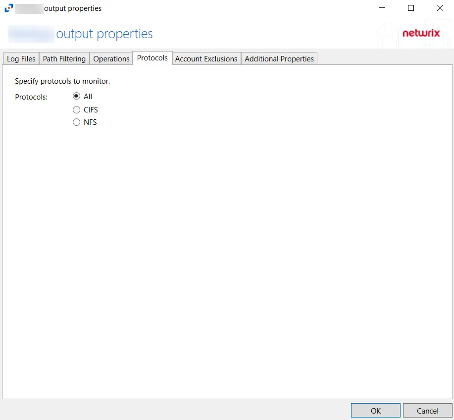

Protocols Tab
The Protocols tab on an output Properties window is where monitoring scope by protocol can be modified. These settings are initially configured when the output is added.
- Protocols – Indicates if All protocols, only CIFS protocols, or only NFS protocols are included
Message Template Window
The Message Template window is opened from the ellipsis (…) button for the Syslog Message Template field on the Syslog tab of the output Properties window.
You can select a preconfigured template from the drop-down menu or create a custom template. The available preconfigured templates vary based on the type of domain/host selected.
For Monitored Domains
Monitored Domains Syslog outputs have the following preconfigured Templates:
- V 1.0 for AlienVault SIEM
- V 1.0 for Generic CEF SIEM – Incorporates the CEF message format
- V 1.0 for Generic LEEF SIEM – Incorporates the LEEF message format
- V 1.0 for Generic SYSLOG SIEM
- V 1.0 for HP ArcSight SIEM
- V 1.0 for LogRhythm SIEM
- V 1.0 for McAfee ESM SIEM
- V 1.0 for IBM QRadar SIEM
- V 1.0 for Splunk SIEM
- V 2.0 for IBM QRadar SIEM 7.2.4
- V 2.0 for Splunk SIEM
Custom templates can be created. Select the desired template or create a new template by modifying an existing template within the Message Template window. The new message template will be named Custom. Macro variables are also available to customize the Syslog message template.
Macro Variables for Monitored Domains
Macros are text strings that are replaced with actual values at run time. The following Macro variables are available to customize the Syslog message template:

For Monitored Hosts
Monitored Hosts Syslog outputs have the following preconfigured Templates:
- AlienVault / Generic Syslog
- CEF – Incorporates the CEF message format
- HP Arcsight
- LEEF – Incorporates the LEEF message format
- LogRhythm
- McAfee
- QRadar – Use this template for IBM QRadar integration. See the Netwrix File Activity Monitor App for QRadar topic for additional information.
- Splunk – Use this template for Splunk integration. See the Configure the File Activity Monitor App for Splunk topic for additional information.
- Netwrix Threat Manager (StealthDEFEND) – Use this template for Netwrix Threat Manager integration. This is the only supported template for Threat Manager.

Environment | Variable | Definition |
SharePoint Online | %ABSOLUTE_URL% | Absolute URL of the affected object |
SharePoint Online | %ACCESS% | Access granted by the sharing operation |
SharePoint | %APPPRINCIPAL_ID% | App Principal ID |
File Servers & NAS Devices | %ATTRIBUTE_NAME% | Rename events only: Fixed string: Filename |
File Servers & NAS Devices | %ATTRIBUTE_VALUE% | Rename events only: New file path |
File Servers & NAS Devices SharePoint | %BLOCKED_EVENT% | True if the operation was denied, False otherwise |
SharePoint SharePoint Online | %CLIENT_IP% | IP address of the user |
File Servers & NAS Devices SharePoint SharePoint Online | %COMPANY% | Fixed string: Stealthbits |
SharePoint Online | %CUSTOM_EVENT% | Custom Event information |
SharePoint Online | %DEST_FILE_EXT% | New file extension of copied or moved file |
SharePoint Online | %DEST_FILENAME% | Name of the file that is copied or moved |
SharePoint Online | %DEST_RELATIVE_PATH% | URL of the destination folder where a folder is copied or moved |
SharePoint Online | %DLP_EXCEPTION% | Reasons why a policy no longer applies and any information about false positive or override |
SharePoint Online | %DLP_POLICY% | Policy(s) that triggered the event |
SharePoint Online | %DLP_SENSITIVE% | Indicates whether the event contains the value of the sensitive data type (true/false) |
SharePoint SharePoint Online | %DOC_LOCATION% | A relative URL of the file or document accessed by the user |
SharePoint SharePoint Online | %EVENT_DATA% | - For SharePoint, raw event data - Fore SharePoint Online, additional event data |
File Servers & NAS Devices | %EVENT_NAME% | Operation type: Read/Create/Update/Delete/Access Rights Change/ Rename/ <empty> . The same as %OPERATION% |
SharePoint SharePoint Online | %EVENT_SOURCE% | Originating source of the event (SharePoint or ObjectModel) |
File Servers & NAS Devices | %EVENT_SOURCE_NAME% | Domain name |
SharePoint SharePoint Online | %EVENT_TYPE% | Event type |
File Servers & NAS Devices | %FILE_NAME% | File name |
File Servers & NAS Devices | %FILE_PATH% | Full path |
File Servers & NAS Devices | %FILE_SIZE% | Size of File |
File Servers & NAS Devices | %FILE_TYPE% | File extension |
SharePoint | %FULL_PATH% | Full Path |
File Servers & NAS Devices SharePoint SharePoint Online | %HOST% | Hostname of Agent |
SharePoint Online | %ID% | Unique ID of the audit record |
File Servers & NAS Devices | %IO_TYPE% | Type of I/O: Filesystem/VSS |
SharePoint | %ITEM_ID% | Item ID |
SharePoint SharePoint Online | %ITEM_TITLE% | Item title |
SharePoint SharePoint Online | %ITEM_TYPE% | Item type (File, Folder, Web, Site, Tenant, DocumentLibrary, Page) |
SharePoint Online | %LIST_ID% | ID of the List |
SharePoint Online | %LIST_ITEM_ID% | ID of the List Item |
SharePoint Online | %LIST_NAME% | Name of the List |
SharePoint Online | %LIST_URL% | URL of the List |
SharePoint | %LOCATION_TYPE% | Location type of the SharePoint document location |
SharePoint Online | %MACHINE_DOMAIN_INFO% | Information about device sync operation |
SharePoint Online | %MACHINE_ID% | Information about device sync operation |
SharePoint Online | %NEW_DOC_LOCATION% | A relative URL to which the object is copied or moved |
File Servers & NAS Devices | %NEW_FILE_NAME% | Rename event only: New file name |
File Servers & NAS Devices | %NEW_FILE_PATH% | Rename event only: New full path |
File Servers & NAS Devices | %NEW_FILE_TYPE% | New File Extension |
File Servers & NAS Devices | %OBJECT_TYPE% | Object type: FILE/FOLD/UNK |
File Servers & NAS Devices | %OLD_ATTRIBUTE_VALUE% | Rename only: Old file path |
File Servers & NAS Devices | %OPERATION% | Operation type: Read/Create/Update/Delete/Access Rights Change/Rename/Unknown |
SharePoint Online | %ORGANIZATION_ID% | Organization tenant ID |
File Servers & NAS Devices | %ORIGINATING_CLIENT% | IP Address of originating client or process name |
File Servers & NAS Devices | %ORIGINATING_CLIENT_HOST% | Hostname of originating client |
File Servers & NAS Devices | %ORIGINATING_SERVER% | Hostname of monitored host |
File Servers & NAS Devices | %ORIGINTAING_SERVER_IP% | IP Address of monitored host |
SharePoint | %PARAM% | Parameters that come with the event |
SharePoint | %PATH% | Truncated path |
File Servers & NAS Devices | %PERMISSIONS_SDDL_DESCRIPTION% | Windows events only: Permission change details in readable format |
File Servers & NAS Devices | %PERMISSIONS_SDDL_DIFF% | Windows events only: Permission change details in SDDL format, '<REMOVED> <ADDED> ' |
File Servers & NAS Devices | %PERPETRATOR% | User name |
File Servers & NAS Devices SharePoint SharePoint Online | %PRODUCT% | Fixed string: Activity Monitor |
File Servers & NAS Devices SharePoint SharePoint Online | %PRODUCT_VERSION% | Product Version |
File Servers & NAS Devices SharePoint SharePoint Online | %PROTOCOL% | Protocol type: CIFS/NFS/VSS/FTP/HDFS/HTTP/HTTPS/Unknown |
File Servers & NAS Devices | %PROTOCOL_VERSION% | NetApp Data ONTAP Cluster-Mode device events only: Protocol Version |
File Servers & NAS Devices | %RENAMEUNCPATH% | Rename events only: New UNC path / New NFS export path |
SharePoint Online | %RESULT_STATUS% | Succeeded, PartiallySucceeded, Failed, True, or False |
SharePoint Online | %SCOPE% | online or onprem |
SharePoint Online | %SHARING_ID% | Unique ID of the sharing operation |
SharePoint SharePoint Online | %SITE_ID% | ID of the Site |
SharePoint Online | %SITE_NAME% | Name of the Site |
SharePoint SharePoint Online | %SITE_URL% | URL of the Site |
SharePoint Online | %SOURCE% | Source (SharePoint, SharePointFileOperation, …) |
SharePoint Online | %SOURCE_FILE_EXT% | File extension |
SharePoint Online | %SOURCE_FILENAME% | File or folder name |
SharePoint | %SOURCE_NAME% | Source Name |
SharePoint Online | %SOURCE_RELATIVE_PATH% | URL of the folder that contains the file accessed by the user |
File Servers & NAS Devices SharePoint SharePoint Online | %SUCCESS% | True if the operation was allowed, False otherwise |
File Servers & NAS Devices SharePoint SharePoint Online | %SYSLOG_DATE% | Timestamp of event (server time, Syslog format: MMM dd HH:mm:ss) |
File Servers & NAS Devices | %TAGS% | Operation Tags. Reports 'Copy' for events that are probable copies |
SharePoint Online | %TARGET_NAME% | UPN or name of the target user or group that a resource was shared with |
SharePoint Online | %TARGET_TYPE% | Type of target user or group that a resource was shared with (Member, Guest, Group, or Partner) |
File Servers & NAS Devices SharePoint SharePoint Online | %TIME_STAMP% | Timestamp of event (server time, format: yyyy-MM-dd HH:mm:ss.zzz) |
SharePoint Online | %TIME_STAMP_OFFSET% | Timestamp of event with timezone offset (server time, format: yyyy-MM-ddTHH:mm:ss.zz+HH:mm) |
File Servers & NAS Devices SharePoint SharePoint Online | %TIME_STAMP_UTC% | Timestamp of event (UTC, format: yyyy-MM-dd HH:mm:ss.zzz) |
SharePoint Online | %TIME_STAMP_Z% | Timestamp of event (UTC, format: yyyy-MM-ddTHH:mm:ss.zzZ) |
File Servers & NAS Devices | %UNCPATH% | UNC path / NFS export path |
SharePoint Online | %UPDATE_TYPE% | Added, Removed, or Updated |
SharePoint Online | %USER_AGENT% | User client or browser |
SharePoint SharePoint Online | %USER_ID% | - For SharePoint, ID of the SharePoint user - For SharePoint Online, UPN of the user who performed the operation |
SharePoint SharePoint Online | %USER_LOGIN% | - For SharePoint, SharePoint User Login / Encoded Claim - For SharePoint Online, An alternative ID of the user. "DlpAgent" for DLP events. |
SharePoint SharePoint Online | %USER_NAME% | SharePoint user name |
File Servers & NAS Devices SharePoint | %USER_SID% | User SID or UID |
SharePoint Online | %USER_TYPE% | Type of the user performed the operation |
SharePoint Online | %VERSION% | New version of the document/version of deleted document |
SharePoint | %WEB_APPLICATION_NAME% | Title of the SharePoint Web Application |
SharePoint SharePoint Online | %WEB_TITLE% | Title of the Site Collection |
SharePoint Online | %WORKLOAD% | Office 356 service where the activity occurred |
