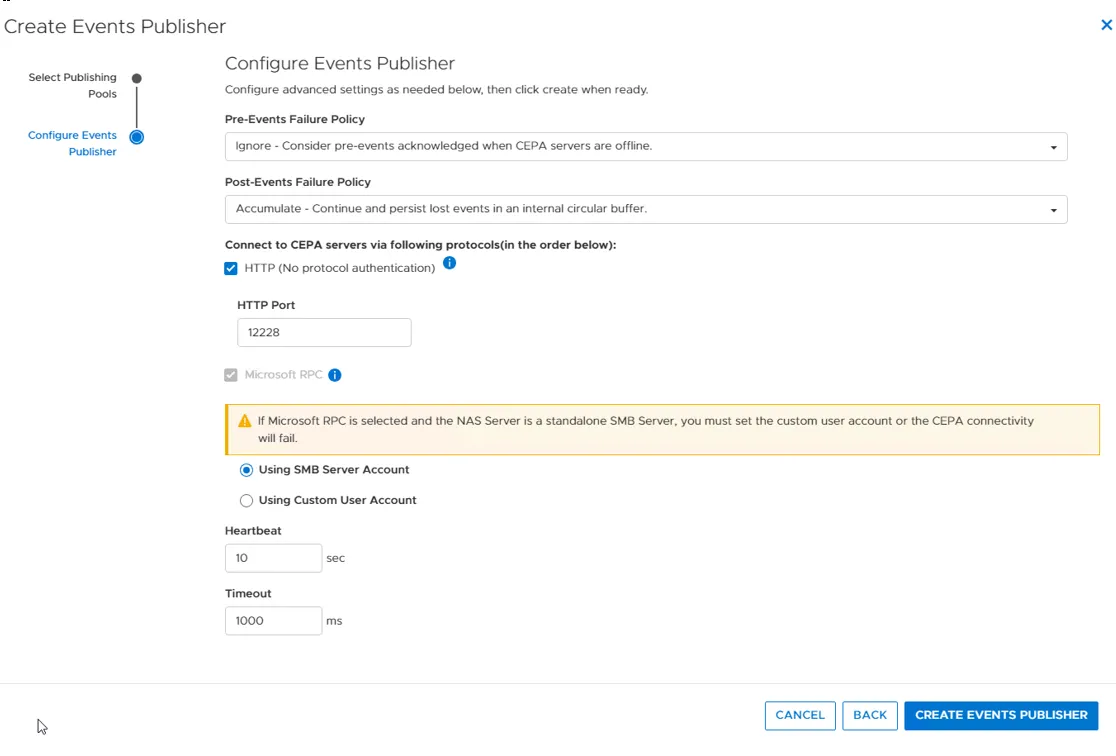

Connect Data Movers to the Dell CEE Server
The cepp.conf file contains information that is necessary to connect the Data Movers to the Dell CEE server. An administrator must create a configuration file which contains at least one event, one pool, and one server. All other parameters are optional. The cepp.conf file resides on the Data Mover.
Step 1 – Log into the Dell Celerra or VNX server with an administrator account. The administrative account should have a $ character in the terminal.
NOTE: Do not use a # charter.
Step 2 – Create or retrieve the cepp.conf file.
If there is not a cepp.conf file on the Data Mover(s), use a text editor to create a new blank file in the home directory named cepp.conf. The following is an example command if using the text editor 'vi' to create a new blank file:
$ vi cepp.conf
If a cepp.conf file already exists, it can be retrieved from the Data Movers for modification with the following command:
$ server_file [DATA_MOVER_NAME] -get cepp.conf cepp.conf
Step 3 – Configure the cepp.conf file. For information on the cepp.conf file, see the Dell Using the Common Event Enabler for Windows Platforms guide instructions on how to add parameters or edit the values or existing parameters.
NOTE: The information can be added to the file on one line or separate lines by using a space and a """ at the end of each line, except for the last line and the lines that contain global options: cifsserver, surveytime, ft, and msrpcuser.
The Activity Monitor requires the following parameters to be set in the cepp.conf file:
  • pool name=
    • This should equal the name assigned to the configuration container. This container is composed of the server(s) IP Address or FQDN where the Dell CEE is installed and where the list of events to be monitored is located. It can be named as desired but must be a pool name.
  • servers=
    • This should equal the IP Address or FQDN of the Windows server where the Dell CEE is installed. If several servers are specified, separate them with the vertical bar (|) or a colon (:).
  • postevents=
    • The following events are required (separated with the vertical bar): CloseModified|CloseUnmodified|CreateDir|CreateFile|DeleteDir|DeleteFile|RenameDir|RenameFile|SetAclDir|SetAclFile
    • If "Directory Read/List" operations are needed, append OpenDir to the list.
  • msrpcuser=
    • This should equal the domain account used to run the Dell CEE Monitor and Dell CAVA services on the Windows server. This parameter is a security measure used to ensure events are only sent to the appropriate servers.
      All unspecified parameters use the default setting. For most configurations, the default setting is sufficient.
    Example cepp.conf file format:
    msrpcuser=[DOMAIN\DOMAINUSER]
    pool name=[POOL_NAME] \
    servers=[IP_ADDRESS1]|[IP_ADDRESS2]|... \
    postevents=[EVENT1]|[EVENT2]|...
    Example cepp.conf file format for the Activity Monitor:
    msrpcuser=[DOMAIN\DOMAINUSER running CEE services]
    pool name=[POOL_NAME for configuration container] \
    servers=[IP_ADDRESS where CEE is installed]|... \
    Example of a completed cepp.conf file for the Activity Monitor:
    msrpcuser=example\user1
    pool name=pool \
    servers=192.168.30.15 \
    postevents=CloseModified|CloseUnmodified|CreateDir|CreateFile|DeleteDir|DeleteFile|RenameDir|RenameFile|SetAclDir|SetAclFile
Step 4 – Move the cepp.conf file to the Data Mover(s) root file system. Run the following command:
$ server_file [DATA_MOVER_NAME]‑put cepp.conf cepp.conf
NOTE: Each Data Mover which runs Celerra Event Publishing Agent (CEPA) must have a cepp.conf file, but each configuration file can specify different events.
Step 5 – (This step is required only if using the msrpcuser parameter) Register the MSRPC user (see Step 3 for additional information on this parameter). Before starting CEPA for the first time, the administrator must issue the following command from the Control Station and follow the prompts for entering information:
/nas/sbin/server_user server_2 -add -md5 -passwd [DOMAIN\DOMAINUSER for msrpcuser]
Step 6 – Start the CEPA facility on the Data Mover. Use the following command:
server_cepp [DATA_MOVER_NAME] -service –start
Then verify the CEPA status using the following command:
server_cepp [DATA_MOVER_NAME] -service –status
Once the cepp.config file has been configured, it is time to configure and enable monitoring with the Activity Monitor. See the Netwrix Activity Monitor Documentation for additional information.

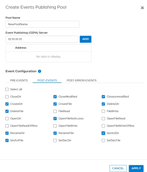

Create an Event Publishing Pool
Follow the steps tTo create a new event publishing pool.:
Step 1 – Select Storage > NAS Servers > NAS Settings > Publishing Pools.
Step 2 – Click Create and specify the name of the pool.
Step 3 – Specify CEE's address or addresses.
Create Event Publishing Pool
  • For SMB shares monitoring (CIFS) enable following Post-Events: –
    • CloseModified
    • CloseUnmodified
    • CreateDir
    • CreateFile
    • DeleteDir
    • DeleteFile
    • OpenFileNoAccess
    • RenameDir
    • RenameFile
    • SetAclDir
    • SetAclFile
  • For NFS exports monitoring enable following Post-Events: –
    • CloseModified,
    • CloseUnmodified
    • CreateDir
    • CreateFile
    • DeleteDir
    • DeleteFile
    • FileRead
    • FileWrite
    • OpenFileNoAccess
    • RenameDir
    • RenameFile
    • SetAclDir
    • SetAclFile
    • SetSecDir
    • SetSecFile
Step 4 – Click Apply.

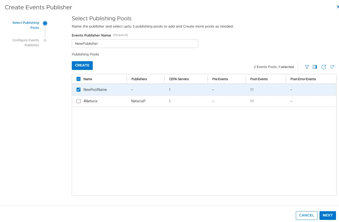

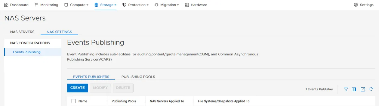

Create an Event Publisher
Follow the steps tTo create a an event publisher.:
Step 1 – Select Storage > NAS Servers > NAS Settings > Events Publishers.
Events Publishing
Step 2 – Click Create.
publishingpools
Step 3 – Specify the name of the publisher.
Step 4 – Select the pool and click Next.
configeventpublisher
Step 5 – Specify Pre-Events Failure Policy as "Ignore - Consider pre-event acknowledged when CEPA servers are offline".
Step 6 – Specify Post-Events Failure Policy as "Accumulate - Continue and persist lost events in an internal circular buffer".
Step 7 – Click Create Events Publisher.
The events publisher is created.

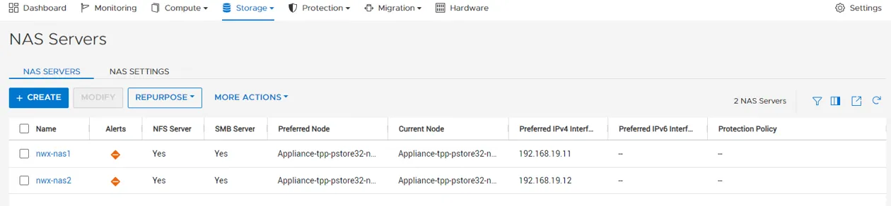

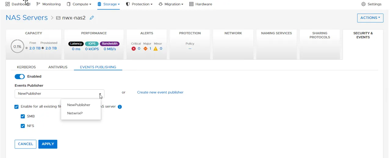

Enable Event Publishing for the NAS Server
Follow the steps tTo enable or disable event publishing for the NAS Server.:
Step 1 – Select Storage > NAS Servers.
NAS Servers
Step 2 – Go to [NAS SERVER] > Security & Events > Events Publishing.
Step 3 – Enable and select the publisher.
nasserver1
Step 4 – You can enable the event publishing for all file systems on the NAS by checking the box and selecting protocols.
Dell PowerStore is enabled for auditing.

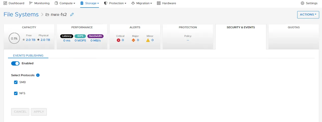

Enable or Disable Event Publishing for File System
Follow the steps toYou can enable or disable the feature for each file system individually. using the following:
Step 1 – Select Storage > File Systems > [FILE SYSTEM] > Security & Events > Events Publishing.
Event Publising Option for File System
Step 2 – Enable and select protocols needed.

Step 1 – Edit the NAS Server > Protection and Events > Events Publishing > Select Pool settings:
  • Add CEPA server – This is the server where CEE is installed. It is recommended that this is also the server were the Activity Monitor activity agent is deployed.
  • Enable the following events for Post Events.
Required Unity events needed for CIFS Activity:
NAM Required Events For CIFS
Required Unity events needed for NFS Activity:
NAM Required Events For NFS
Step 2 – Enable Events Publishing:
  • Edit the FileSystem > Advanced settings:
    • NFS Events Publishing – Enabled (required for NFS protocol monitoring)
    • SMB Events publishing – Enabled (required for SMB / CIFS protocol monitoring)
