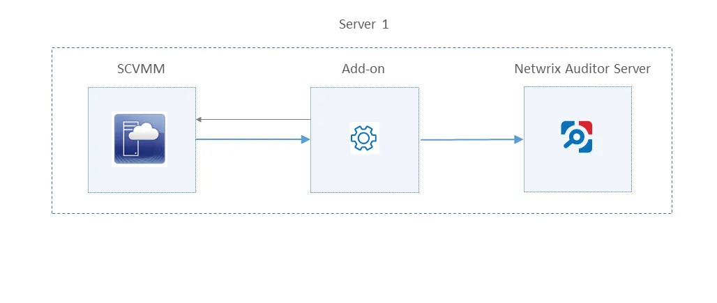

The add-on can be deployed on any computer in your environment. For example, you can run the add-on on the computer where Auditor is installed, or on a remote server. Also, consider different SCVMM deployment scenarios. Possible deployment options are as follows (here it is assumed that the add-on is installed together with Auditor server):
- Add-on running on the same machine as SCVMM server (with Management Console):

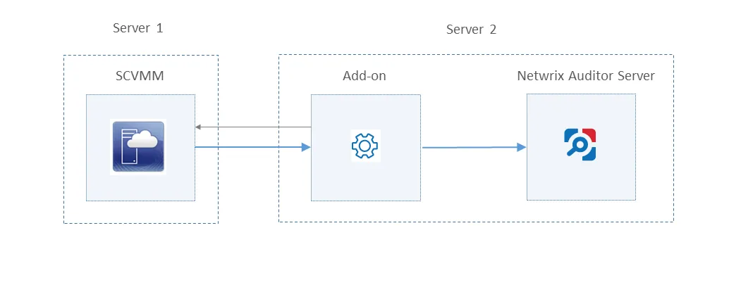

- Add-on and SCVMM server (with Management Console) running on different machines:
In this scenario, the account used to access SCVMM server must be a member of the Remote Management Users local group on the SCVMM server.

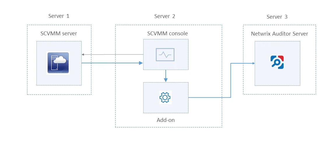

- Add-on running on the same machine as SCVMM Management Console; SCVMM server running on the remote machine:
In this scenario, make sure to specify SCVMM server address in the DataCollectionServer parameter (not the machine where SCVMM console runs) in the settings.xml configuration file. See the Add-On Parameterstopic for additional information.

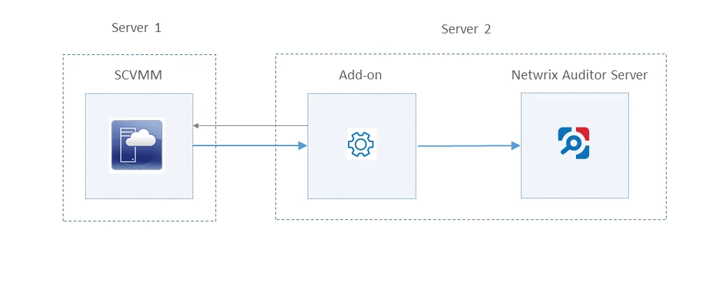

Example 1
- The add-on runs on the Auditor server.
- The System account is used to launch the add-on via Task Scheduler (default configuration).
- Configuration parameters to specify in settings.xml (sample values):
https://172.28.6.19:9699/netwrix/api/v1/activity_records</NetwrixAuditorEndpoint>```
```<NetwrixAuditorUserName/>```
```<NetrixAuditorPassword/>```
Configuration parameters __NetwrixAuditorUserName__ and __NetrixAuditorPassword__ are not required.

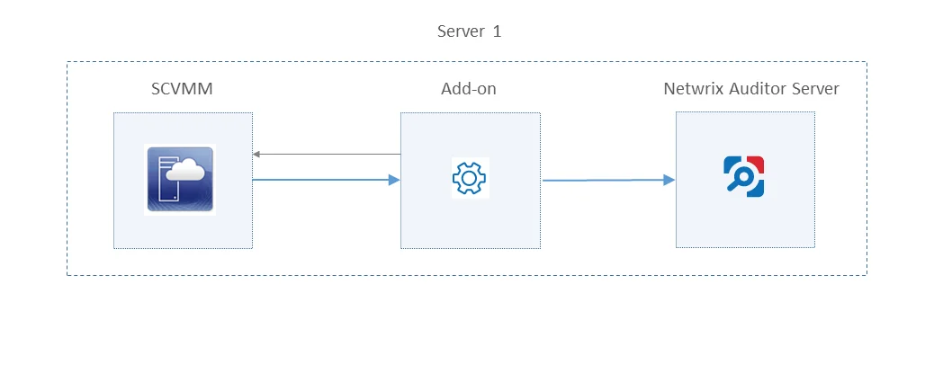

## Example 2
- The add-on runs on the Auditor server with the explicitly specified user credentials.
- Configuration parameters to specify in __settings.xml__ (sample values):
```<NetwrixAuditorEndpoint>
```<NetwrixAuditorUserName>SecurityOfficer```
```</NetwrixAuditorUserName>```
```<NetwrixAuditorPassword>NetwrixUser```
```</NetwrixAuditorPassword>```
## Example 3
- The add-on runs on the machine with SCVMM.
- The _System_ account is used to launch the add-on via Task Scheduler (default configuration).
- Configuration parameters to specify in __settings.xml__:
```<DataCollectionServer/>
<DataCollectionUserName/>
<DataCollectionPassword/>
Credentials for Data Collection Server (that is, SCVMM) are not required.

- If the solution was deployed using the third scenario (that is, SCVMM server and add-on are running on different machines), then the following error may be written in the solution log:
The WinRM client cannot process the request.
See the Deployment Scenariostopic for additional information.
If the authentication scheme is different from Kerberos, or if the client computer is not joined to a domain, then HTTPS transport must be used or the destination machine must be added to the TrustedHosts list. To configure this list, use winrm.cmd.
Computers included in the TrustedHosts list might not be authenticated. To get more information about their settings, you can run the following command:
winrm help config
For details on remote troubleshooting and authentication issues, see the following Microsoft article: about_Remote_Troubleshooting.
To work around, add the remote SCVMM server to the TrustedHosts list on the machine were the add-on runs. For that, use the following commands:
winrm quickconfig
Set-Item WSMan:\localhost\Client\TrustedHosts -Value "ServerNameOrIP"
here:
ServerNameOrIP
– SCVMM server name or IP address.
