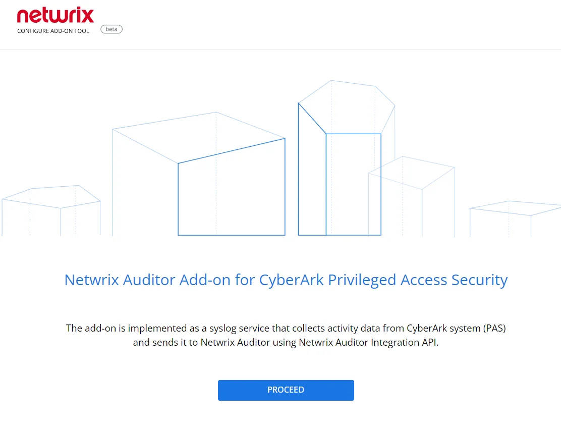

Configure Add-on Parameters
The configuration wizard opens in the default web browser:
Click Proceed and complete the following fields:
