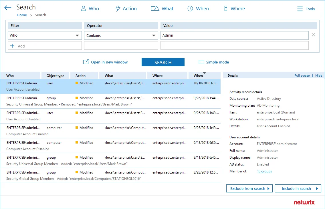

Use Filters in Advanced Mode
Netwrix Auditor provides an advanced set of filters and match type operators that enable you to customize your searches even more precisely.
Switch to Advanced mode to review your current search in details and modify it if necessary. Click Add to add a new filter to your search.

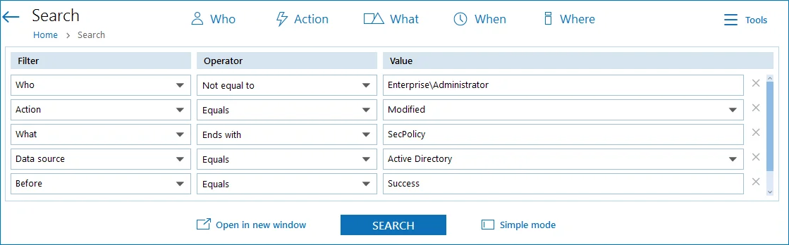

To modify conditions for the selected filters, make sure you have switched to the Advanced search mode.
The image below represents the same search filters as they are shown in the Search field in the Simple mode.
