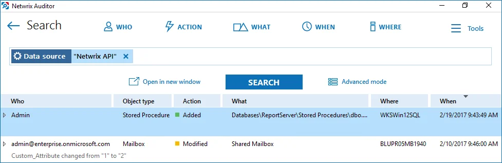

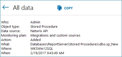

__Step 4 –__ Check that posted data is now available in the Audit Database. Run a search request to [/netwrix/api/v1/activity_records/search](/docs/auditor/10.6/api/searchactivityrecords.md) endpoint or use interactive search in the Netwrix Auditor client. For example:
__Step 5 –__ For input Activity Records, the data source is set to Netwrix API.
