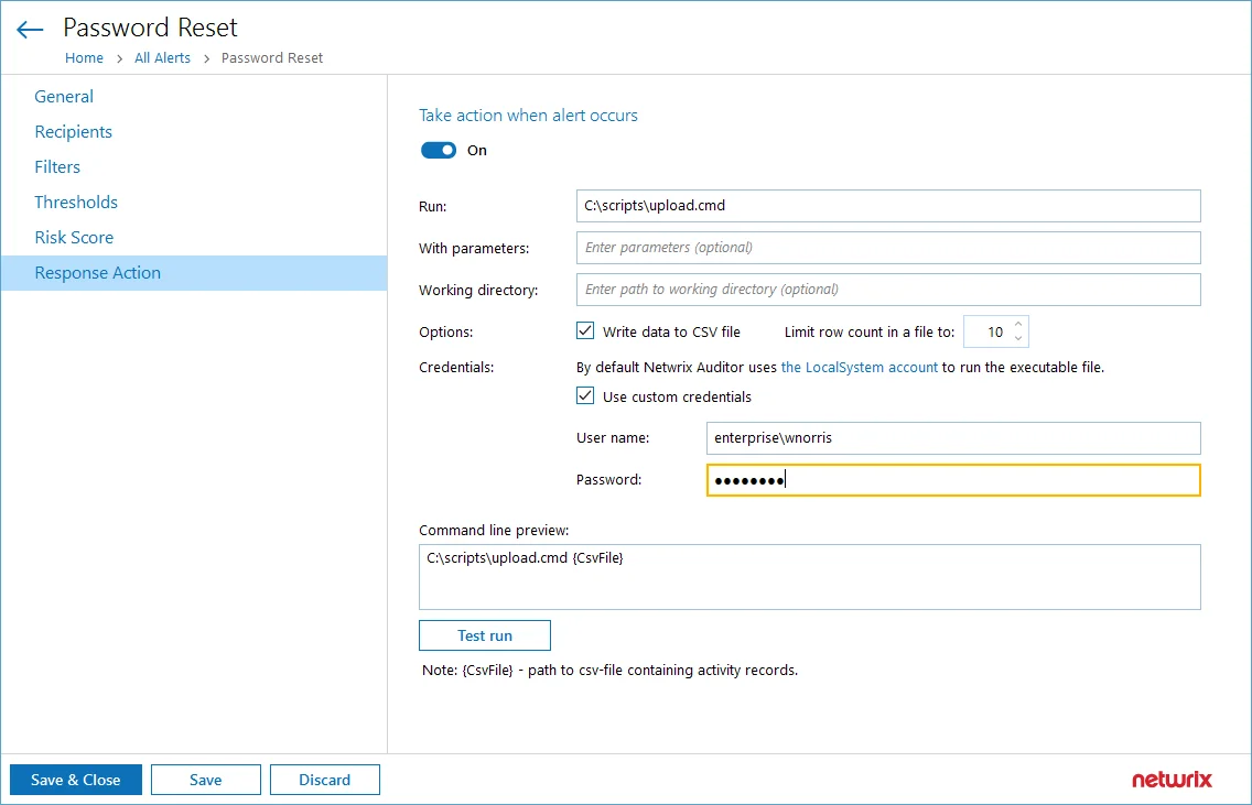

Response Action settings contain the following configuration options:
  • Take action when alert occurs - Toggle this setting to On to enable alert responses
  • Run – Indicates the location of the script file you want to run as your response action
  • With parameters – If your script contains parameters, specify them here
  • Working directory – If you need to specify a working directory for your script to perform the operation, insert the path here
  • Write data to CSV file – If this checkbox is selected, Netwrix Auditor will save activity records in a CSV file. You can use it to pass information into your response action to receive a more targeted response.
  • Limit row count in a file to – Select the desired number of rows you want for the file
  • Use custom credentials – Enter the username and password if you want the script to be run as an account different from LocalSystem
  • Command line preview – Showing a preview of the command line script. Click Test run button to test its performance.

Step 1 – Turn the switch to On if you want a response action to be taken when the alert occurs.
Step 2 – In the Run field, specify the path to the executable file (.exe, .cmd, .bat; for .ps1 files see step 3 below). The file must be located on the machine where Netwrix Auditor server runs.
Step 3 – In the With parameters field, enter the parameters to be used by the executable file. Use space character as a separator.
Step 4 – To run .exe, .cmd and .bat files, you can enter the path to your command-line or batch file directly in the Run field, for example:
command
To run the .ps1 files, you will need to enter the path to powershell.exe and path to your script. For example:
  • In the Run field, enter C:\Windows\system32\WindowsPowerShell\v1.0\powershell.exe
  • In the With parameters field, enter –File <path_to_your_ps_script>
powershell

Step 5 – In the Working directory field, specify path to the working directory of the executable file on NAuditor server.
Step 6 – In the Working directory field, specify path to the working directory of the executable file on NAuditor server.
If you leave this field empty, then the path to the file specified in the Run field will be used as a working directory. As shown in the example with the .ps file, this may be the system directory. So, to avoid system directory cluttering, it is recommended not to leave the Working directory field empty but to explicitly specify the directory where your executable file is located, or a dedicated directory for that purpose. In the latter case, make sure the directory exists on Auditor server.

By default, the executable file will be launched under the LocalSystem account. If you want to use another account, select the Use custom credentials checkbox and specify user name and password. Make sure this account has Log on as batch job privilege.
The resulting command line including executable file name and execution parameters will appear in the Command line preview.
If you selected to Write data to CSV file, the command line will include {CsvFile}, i.e. the file path. Alternatively, the command line will include {AlertID} and {RecordID}, i.e. related IDs

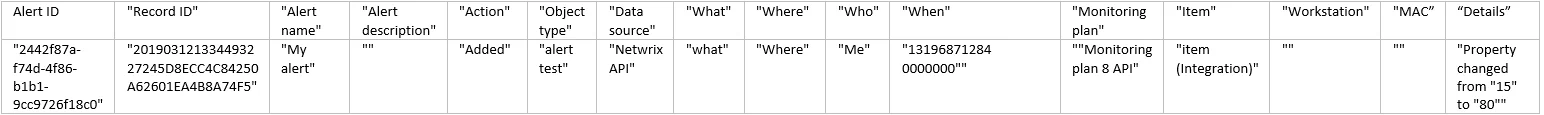

Write Data to a CSV File
To pass certain activity record fields to the executable file, you can instruct the program to write the fields and their values in a structured way to a CSV file.
Here is an example of a CSV file structure:
csvfile
The number of activity records retrieved per every response action launch will be only limited by user (see below for details). If the number of records associated with the alert exceeds this limit, the program will create multiple CSV files, storing data in chunks.
For example, if there are 50 records associated with the alert (e.g., “Scanning threat is detected on network device” alert), and the number of records for one CSV is set to 10, the program will create 5 CSV files, with 10 records in each chunk. Also notice that the response action will be launched once for every such chunk (5 times in this example), and will retrieve multiple activity records per launch (not more than the specified limit, i.e. 10 records in this example).
A CSV file is named using the timestamp and GUID and stored in the subfolder of Netwrix Auditor working folder (by default, %ProgramData%\Netwrix Auditor\AuditCore\AuditArchive\AlertsToolLauncher\Csv). Note that a CSV file will exist only while the executable file is running – after the execution is completed, the CSV file will be deleted. So if you plan, for example, to obtain some data from that file for further processing, you may need to copy it to a permanent location in a timely manner, e.g., using a script.
