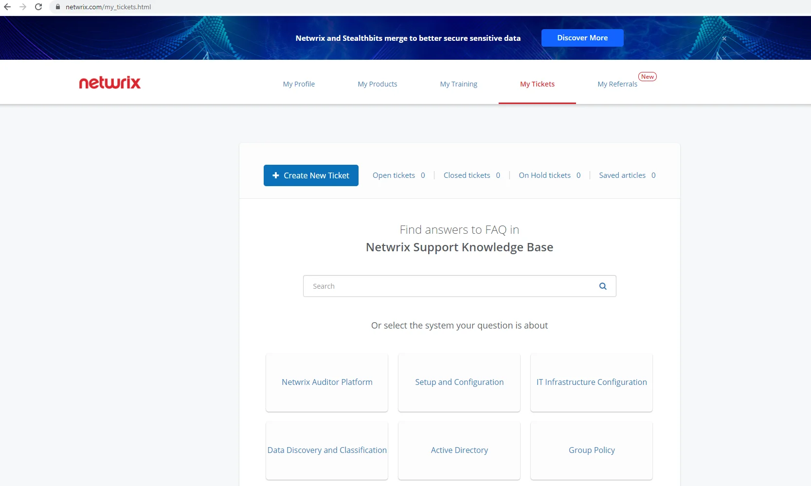

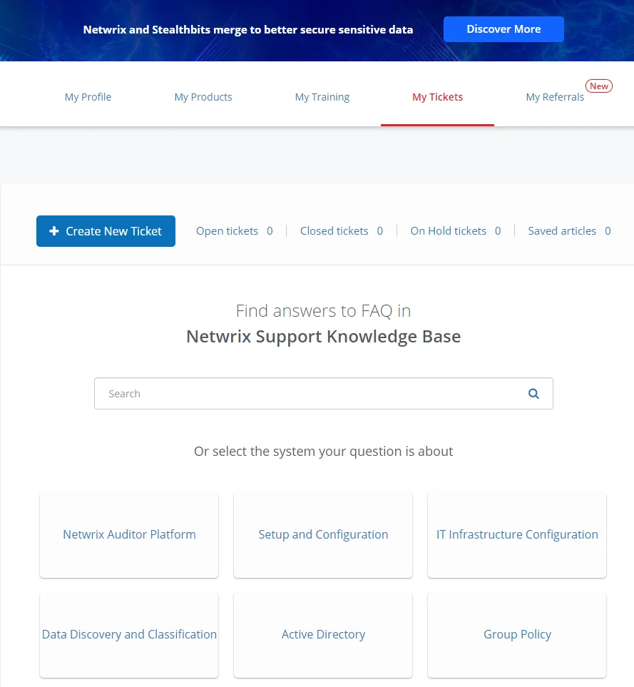

Creating a ticket with Customer portal
  1. Sign in at https://www.netwrix.com/my_tickets.html.
  2. You can search or browse through the Knowledge Base articles here, or click Create New Ticket:
    support_ticket_customer_portal_fixed
  3. Fill in the form, describing the issue, and click Open a ticket.
  4. After that, you will be able to attach the files you need (screenshots, emails, reports, etc.).
