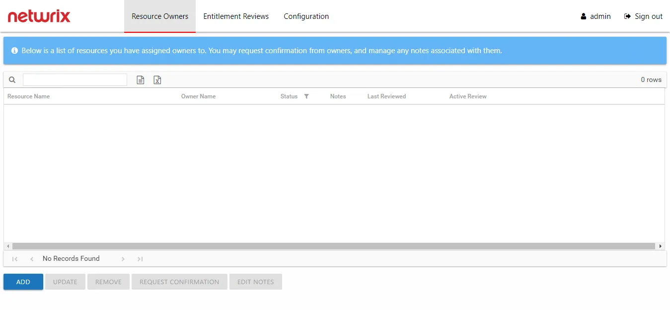

The installer places the following icon on the desktop which opens the Access Reviews Console:
Use this icon to launch the Access Reviews Console for the first time.

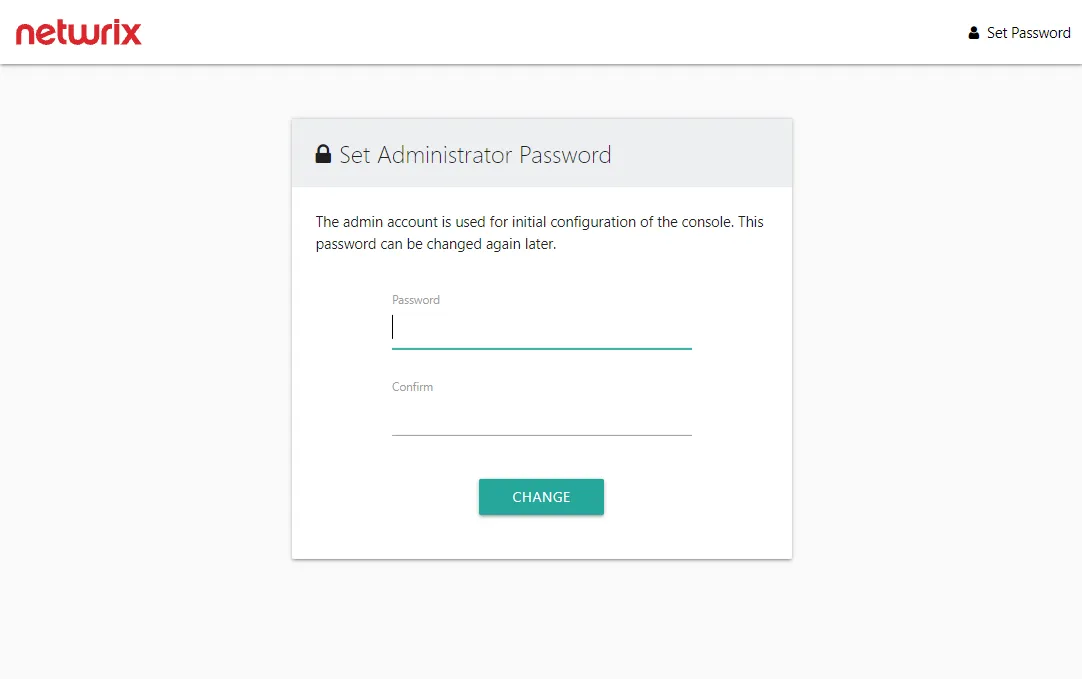

The Access Reviews application is installed with a Builtin Administrator account; "admin" is the User Name. You will be prompted to set the account's password. It must be eight or more characters long. After setting the password, you will need to login with the "admin" account.
Using the Configuration interface, the Builtin Administrator account can be disabled once a domain account has been granted the Administrator role. You can also change the password for the Builtin Administrator account. See the Modify the Builtin Administrator Account topic for additional information.
The Resource Owners interface opens. The first thing that should be done is to configure console access for domain users and configure notification settings. Select the Configuration tab. See the Console Access Page and Notifications Page topics for additional information.
The interfaces available to console users are controlled by the role assigned. Owners do not need to be assigned console access. See the URL & Login topic for information on how users will log in and where they are directed after login.
See the Navigation topic for information on each of the interfaces.

Administrator Role
Users granted the Administrator role are directed to the Resource Owners interface upon login.
Administrators are the only ones with access to the Configuration interface. The My Reviews interface is available if the logged in user is also assigned ownership of a resource.

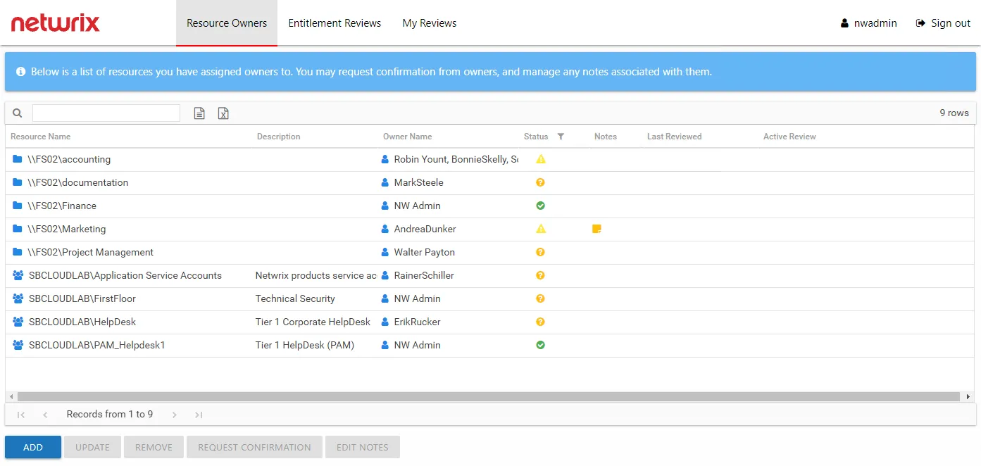

Security Team Role
Users granted the Security Team role are directed to the Resource Owners interface upon login.
Security Team members only lack access to the Configuration interface, which is only available to Administrators. The My Reviews interface is available if the logged in user is also assigned ownership of a resource.

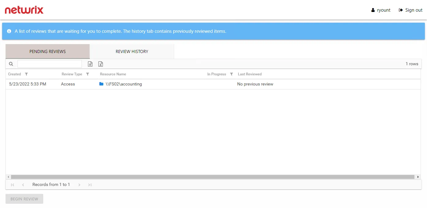

Owners Without Role
Users assigned ownership of a resource but not granted a user role are directed to the My Reviews interface upon login.
Owners can view pending reviews and view historical reviews.

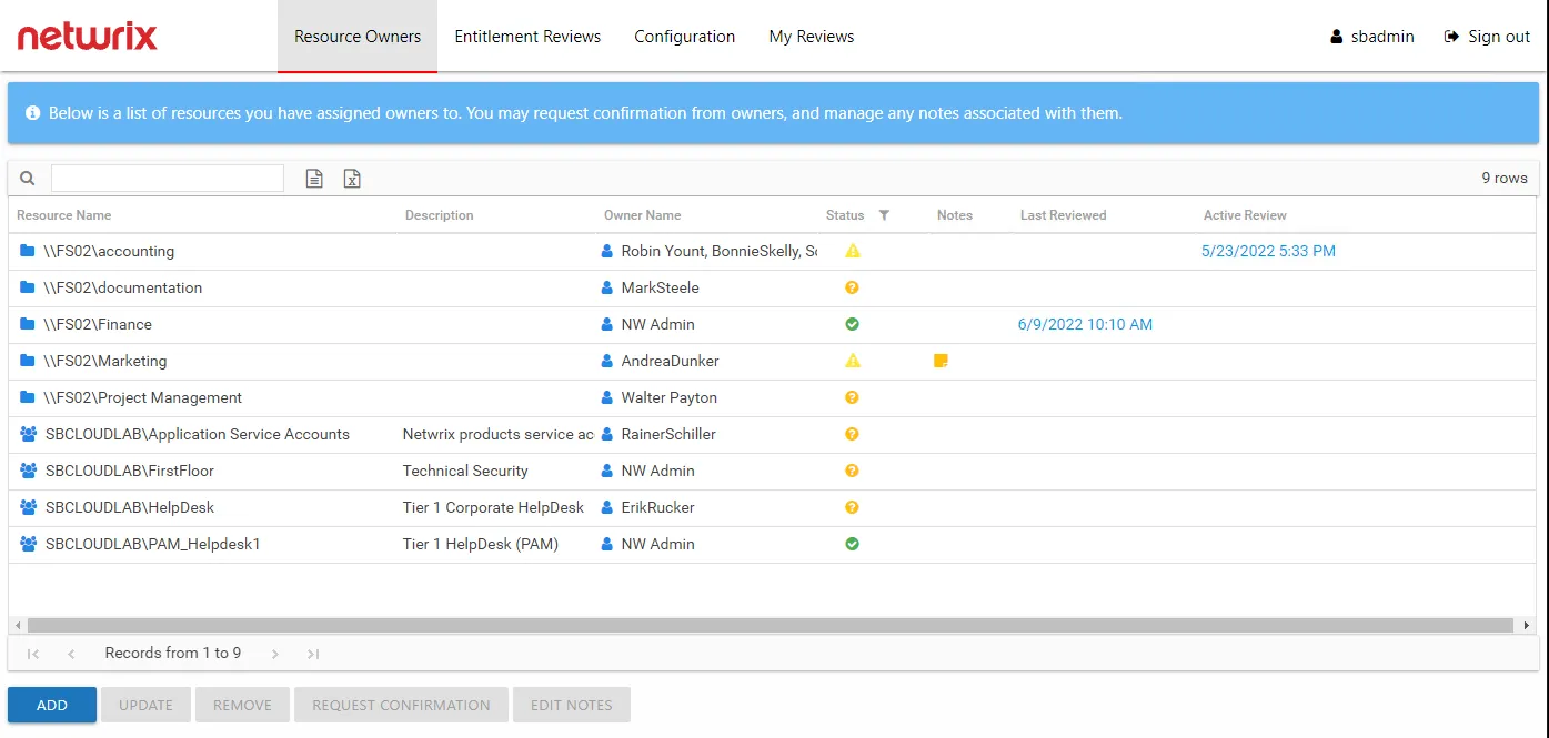

The Configuration tab opens the Configuration interface. Configure console access, Active Directory service account, notification settings, database access, and diagnostic logging level.
This interface is available only to users with the Administrator role. See the Configuration Interface Overview topic for additional information.
For Security Team & Administrator
The Resource Owners tab opens the Resource Owners interface. Manage resource ownership by assigning owners to resources and requesting ownership confirmation. Resources to be included in the Access Reviews workflow must first be assigned at least one owner within the Resource Owners interface. Assigned owners can log in to complete reviews.
This interface is available only to users with either the Security Team or Administrator role. See the Resource Owners Interface topic for additional information.
The Entitlement Reviews tab opens the Entitlement Reviews interface. Create and manage reviews. There are two types of reviews for resources being managed within the Access Reviews application: resource Access reviews and group Membership reviews. This does require the Access Reviews application to be configured to send notifications.
This interface is available only to users with either the Security Team or Administrator role. See the Entitlement Reviews Interface topic for additional information.

The My Reviews tab opens the My Reviews interface. It is only visible if the logged in user is also an assigned owner of at least one resource. Assigned owners without a user role are directed to the My Reviews interface at login.
The My Reviews interface is available to any domain user who has been assigned ownership of a resource. See the Owners & Access Reviews topic for additional information.

Interface | Purpose | Opened By | Accessible To |
Configuration | Configure console access, Active Directory service account, notification settings, database access, and diagnostic logging level. | Configuration tab | Administrator role |
Resource Owners | Manage resource ownership by assigning owners to resources and requesting ownership confirmation. | Resource Owners tab | Administrator role Security Team role |
Entitlement Reviews | Create and manage reviews. | Entitlement Reviews tab | Administrator role Security Team role |
My Reviews | View and process pending reviews. Also view historical reviews. | My Reviews tab Direct from login for owners without a role | Assigned Resource Owners |
