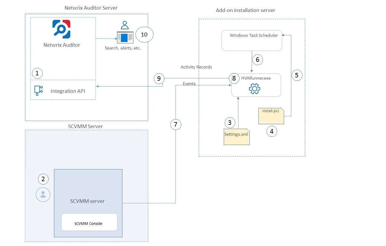

How It Works​
The add-on is implemented as a stand-alone application that collects activity data from Virtual Machine Manager and sends it to Auditor using the Integration API.
HIW
On a high level, the solution works as follows:
  1. An IT administrator configures the Integration API settings to enable data collection and storage to the Netwrix database for further reporting, search, etc.
    It is recommended to create a dedicated monitoring plan in Auditor and add a dedicated item of Integration type to it — then you will be able to filter data in reports and search results by monitoring plan or item name.
  2. On SCVMM side, the IT administrator prepares a dedicated user account for accessing SCVMM server. This account requires administrative rights.
  3. Then the IT administrator opens the settings.xml configuration file and specifies the necessary parameters for add-on operation, including Netwrix Auditor server settings, etc.
  4. The IT administrator selects the deployment scenario and runs install.ps1 PowerShell script file to deploy and configure the add-on components on the target server.
  5. This script creates a Windows scheduled task that will run periodically (every 15 minutes) to collect audit data from VMM server.
    See the Monitoring Scope for additional information on the default list of the events supported out-of-the box.
  6. The add-on component HVARunner.exe starts collecting activity data from VMM. Data communication is performed using TCP protocol.
  7. The add-on processes this data into Auditor-compatible format (Activity Records). Each Activity Record contains the Who-What-When-Where-Action information (that is, initiator's account, time, action, and other details).
See the Integration API topic for additional information on the structure of the Activity Record and the capabilities of the Integration API.
  1. The add-on uses the Integration API to send the Activity Records to Auditor Server, where this data becomes available for search, reporting, and alerting.
  2. Users open Auditor Client to work with collected data:
