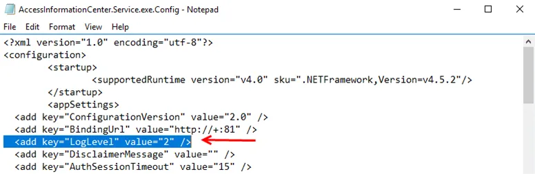

The AccessInformationCenter.Service.exe.Config file is located in the Logs folder of the Access Reviews installation directory:
...\Netwrix\Access Reviews
Follow the steps to modify the log level.
Step 1 – Open the AccessInformationCenter.Service.exe.Config file in a text editor, e.g. Notepad.
AccessInformationCenter.Service.exe.Config file in Notepad
Step 2 – The level value is set in the LogLevel parameter, where "2" is the default level. As the logging level increases from 0 to 3, the types of information and level of detail included within the log file also increase. Change to the desired log level:
  • Error level is when value="0"
  • Warning level is when value="1"
  • Info level is when value="2"
  • Debug level is when value="3"
    • Debug logging can be enabled from the Diagnostics page of the Configuration interface
Step 3 – Save and close the AccessInformationCenter.Service.exe.Config file.
Once troubleshooting has finished, it is recommended to return the log level to the default level, Info = 2, to prevent the log file from growing too large.

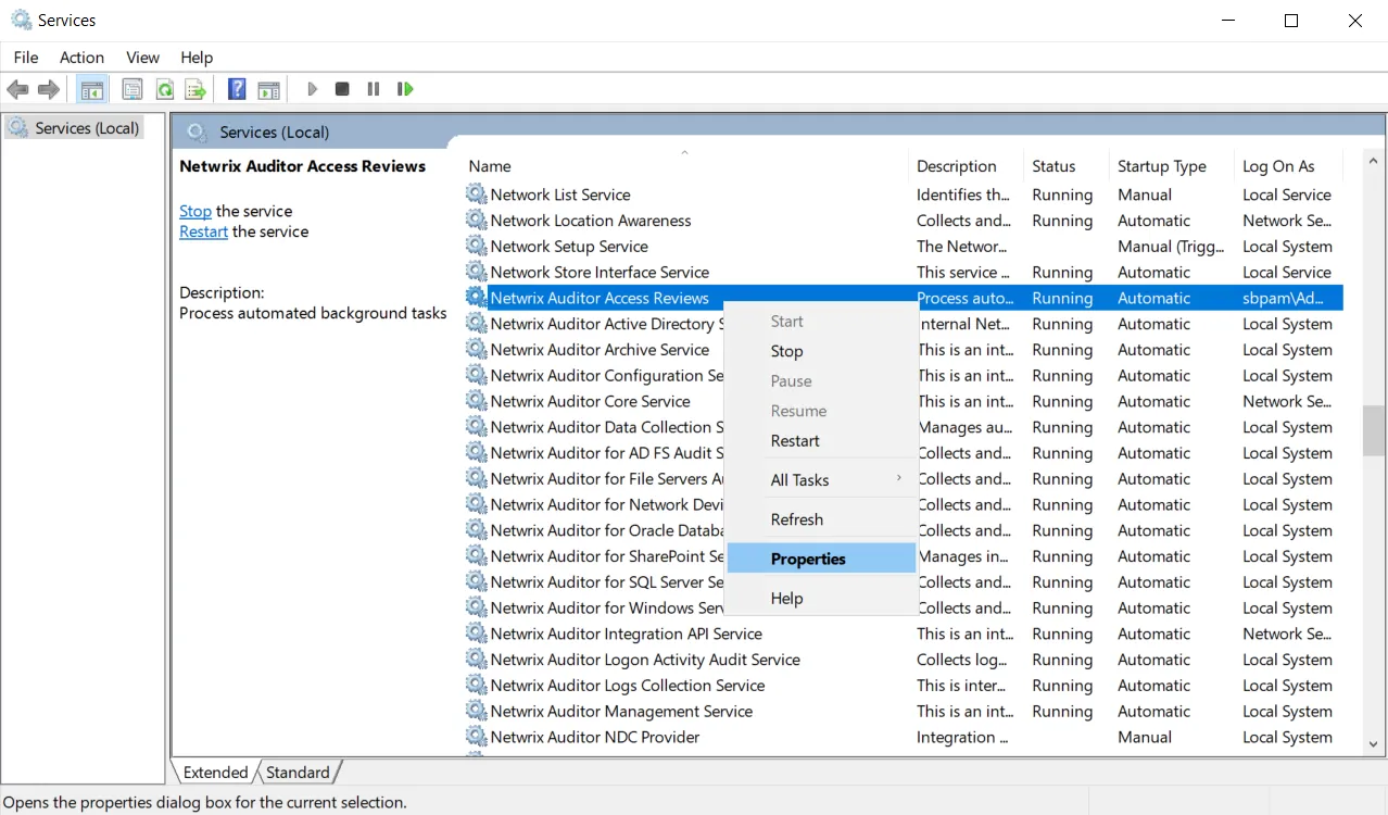

Step 1 – Navigate to Service Control Manager (services.msc). The Services Control Manager opens.
Services Manager Console showing the Netwrix Access Information Center service and the right-click Menu

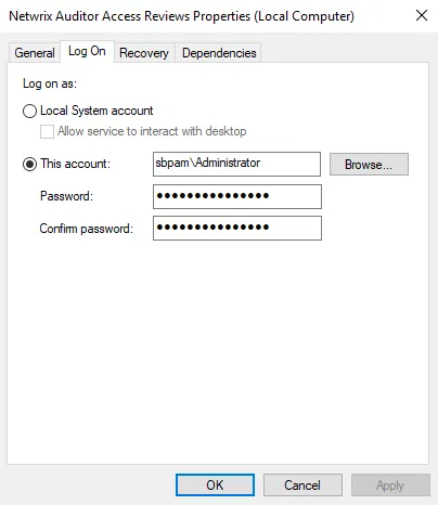

Step 2 – Right-click on the Netwrix Auditor Access Reviews service and select Properties. The service Properties window opens.
Netwrix Access Information Center service Properties window with Select User browser window
Step 3 – On the Log On tab, select the This account radio button. Enter the account name using NTAccount format [DOMAIN\username]. Optionally, use the Browse button to search for the account. Enter the account's password in both the Password and Confirm password fields. Then click OK. The Properties window closes.
Step 4 – The selected account is displayed in the Log On As column for the service. Either Restart or Stop and Start the service for this change to take affect.
The Netwrix Auditor Access Reviews service is now running with the supplied Windows account.

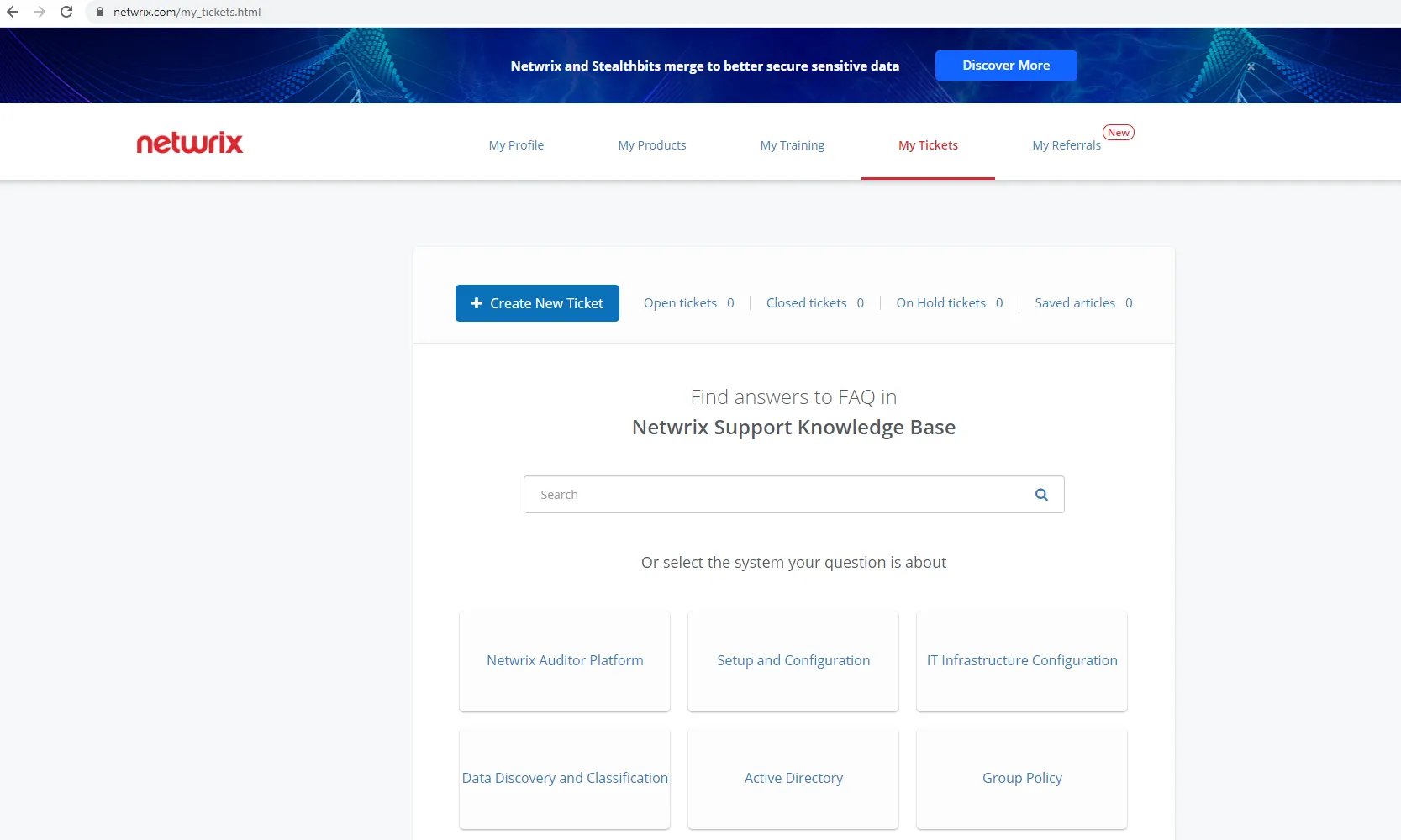

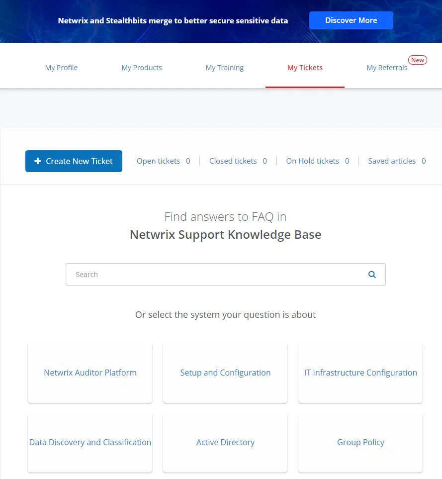

Creating a ticket with Customer portal
  1. Sign in at https://www.netwrix.com/my_tickets.html.
  2. You can search or browse through the Knowledge Base articles here, or click Create New Ticket:
    support_ticket_customer_portal_fixed
  3. Fill in the form, describing the issue, and click Open a ticket.
  4. After that, you will be able to attach the files you need (screenshots, emails, reports, etc.).
