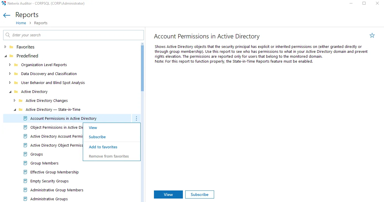

Step 1 – On the main Auditor page, click the Reports tile in the upper left corner.
Step 2 – Open a report you are interested in; for example, Account Permissions in Active Directory:
scenario_reports_1
Step 3 – Click the report menu (three dots) to the right and select Add to favorites. (Alternatively, click the star icon in the upper right corner of the report description.)
The report is added to the Favorite reports section on the home page and you can run it instantly.

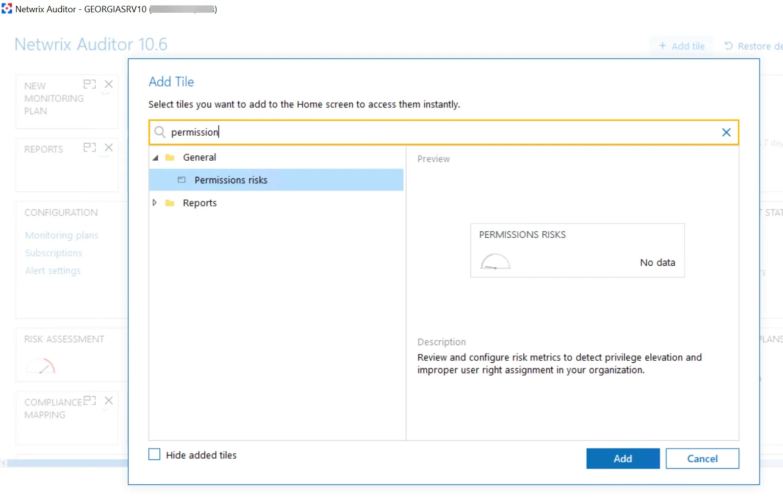

Review and Pin Risks
Follow the steps to review risks and pin important ones to the Home Screen.
Step 1 – On the main Auditor page, click the Risk Assessment tile.
Step 2 – Review the Risk Assessment Overview dashbord and select the risk you are interested in, such as "User Accounts with administrative permissions". See the IT Risk Assessment Overview topic for additional information.
Step 3 – To access this risk quickly, pin it to the home page, as follows:
  1. On the main product page, click Customize.
  2. Click Add tile.
  3. Search the group of risks you want to pin to the home page (in this case, the "Permissions" risks group):
    scenario_risks_thumb_0_0
Step 4 – Click Add.
The selected risks group is added to the home screen.

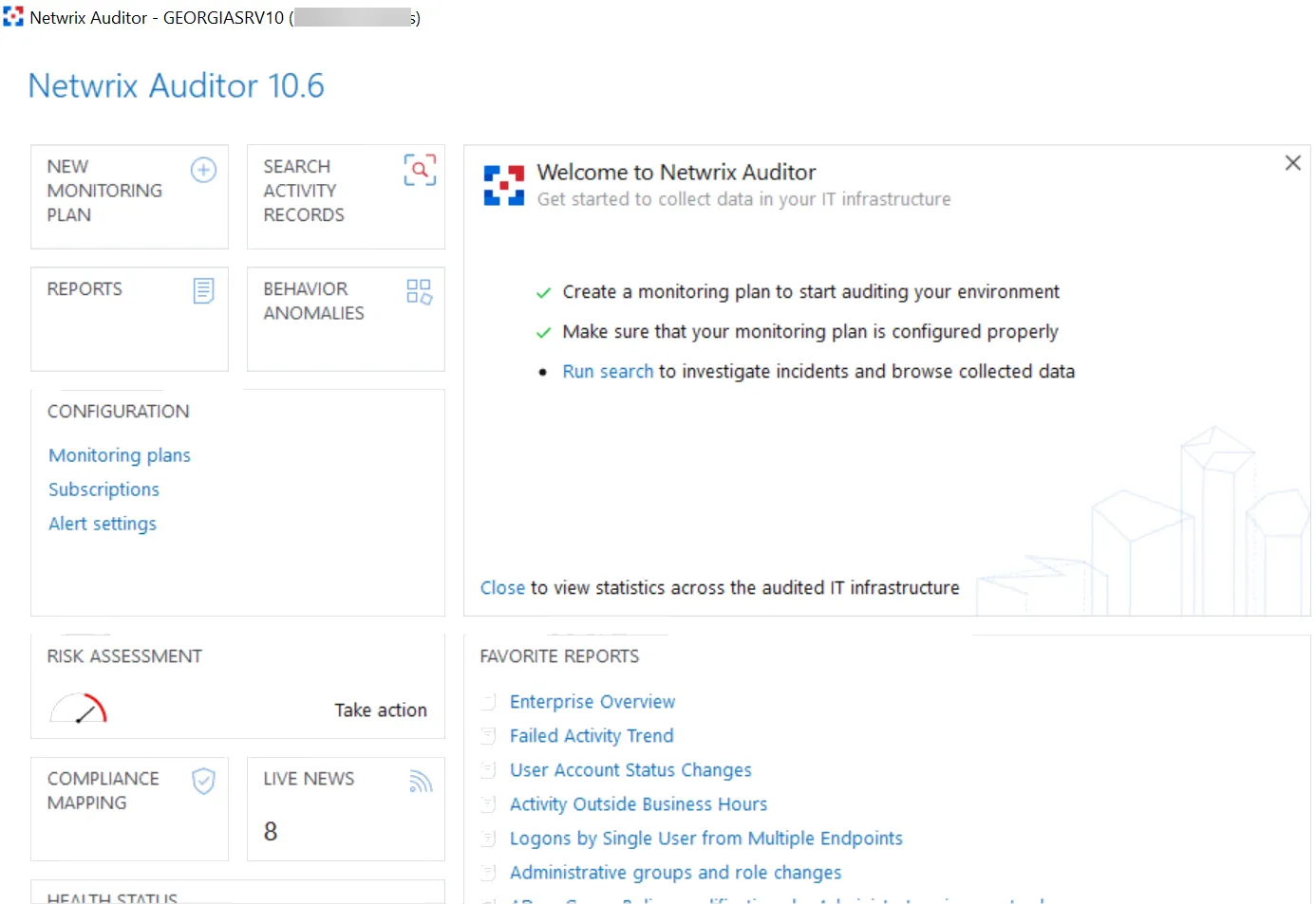

Starting with version 10, you can personalize theHome Screen of Netwrix Auditor to display the tiles that best meet your needs. Be sure to plan your screen space, considering which tiles you want to pin and their dimensions. You can modify the size of any tile; horizontal scrolling is also supported. Rest assured that your configurations and data will not be affected by any changes you make to the home screen.
Add a Tile to the Home Screen
Follow the steps to add tile on the Home Screen.
Step 1 – Click Customize in the upper right corner of the home screen.
Step 2 – Select Add tile.
Either search for the tile you want by name, or select it from the list of tiles. Note that tiles are grouped into menus; to view all tiles within a menu, check Show all menu tiles.
Step 3 – Click Add and the selected tile appears on the home screen.
Step 4 – Drag and drop it to the desired location.
Step 5 – Click Apply.

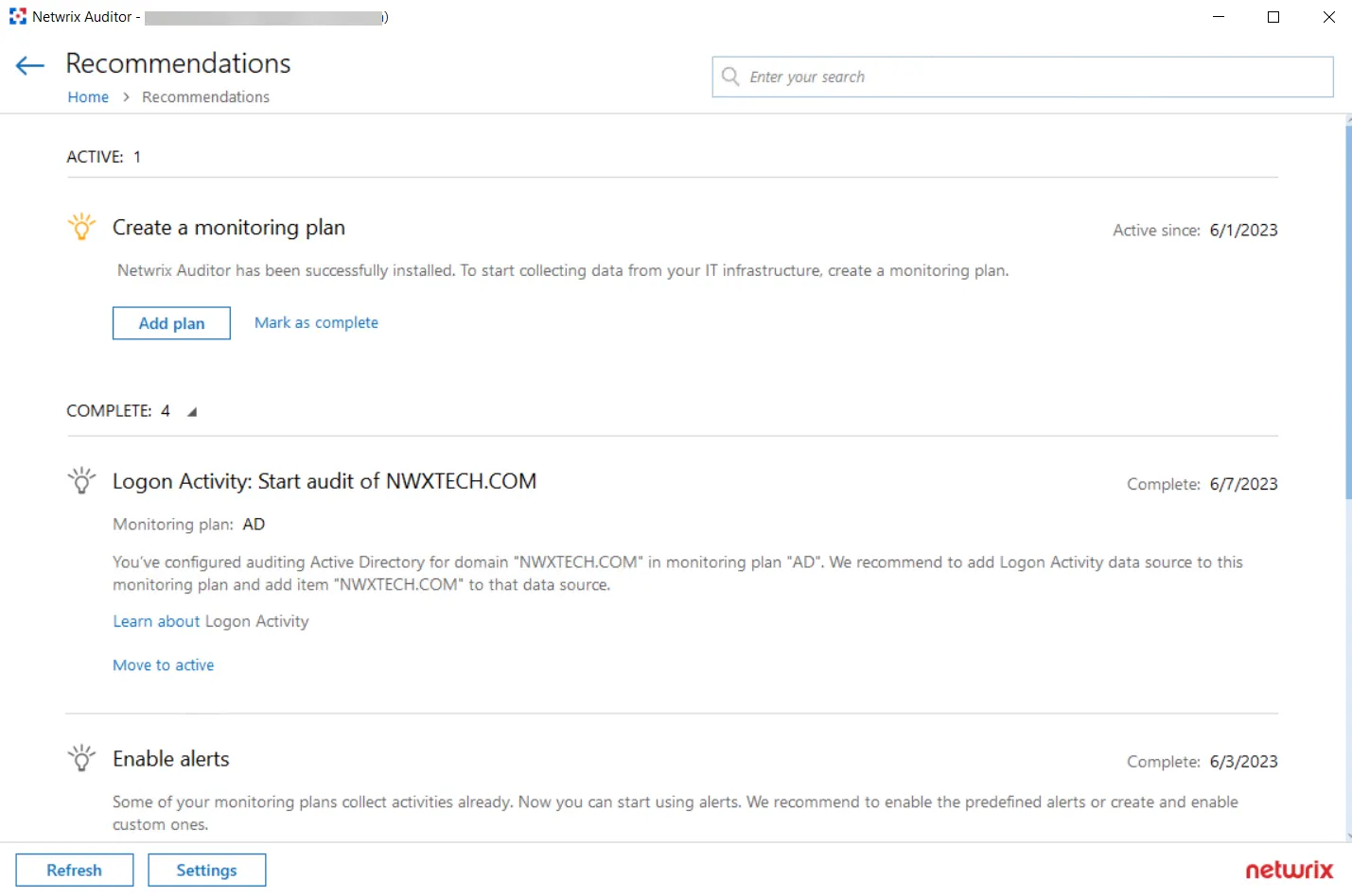

This section covers the Recommendations interface that contains detailed guidance on the Auditor usage patterns. Once you installed the product, configured your IT infrastructure, and prepared Netwrix Service Accounts, you can start collecting data and review it with Netwrix Auditor. The recommendations are based on your current product configuration and help you to experience the Auditor capabilities in earnest.
recommendations
Follow the steps to review the recommendations provided by Netwrix industry experts.
Step 1 – On the Auditor home page, click the Recommendations tile.
Step 2 – Review the recommendations applicable to your current Auditor configuration and take required steps.
Once the required steps are done, the recommendation goes to the 'Complete' list. You can move it back to the active state any time you want by clicking the Move to active link.

Create Your First Monitoring Plan

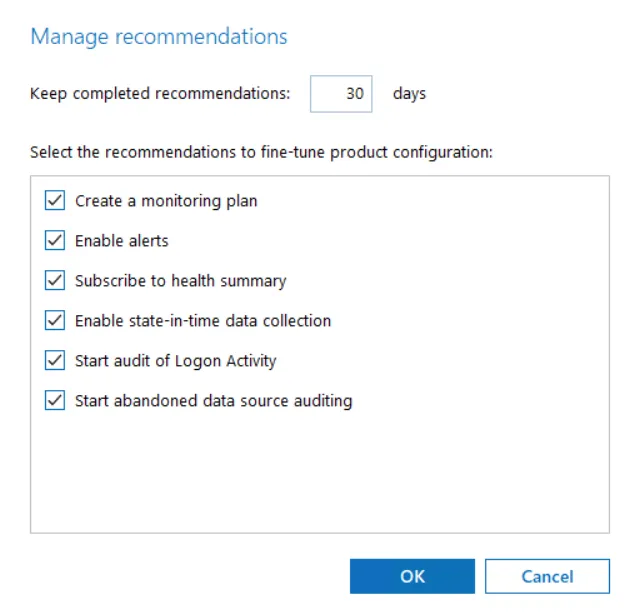

Manage Recommendations
For active recommendations, you can follow the prompts or move them to the completed state by clicking the 'Mark as complete' link.
For completed recommendations, you can configure the retention period to keep them visible and select their categories for further displaying on the tile. If you want to proceed with a completed recommendation, click the 'Move to active' link below the recommendation.
Follow the steps to manage recommendations:
Step 2 – Click Settings at the bottom.
managerecommendations
Step 3 – In the Manage recommendations dialog, do the following:
  • Keep completed recommendations: <30> days – Specify time period in days to keep the completed recommendations visible. The default period is set to 30 days.
  • Select the recommendations to fine-tune product configuration – Select recommendations types you want to be displayed. When checked, the recommendations of the selected type appear once your Auditor configuration meets the recommendation conditions.
    For example, if you selected the 'Enable State-in-Time data collection', this recommendation appears for each new monitoring plan with disabled state-in-time option.
Step 4 – Click OK to save your edits.
