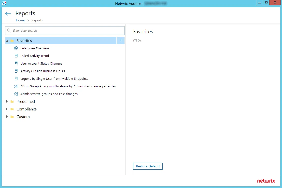

The Home > Reports page opens. This page includes several folders: Favorites, Predefined, Compliance and Custom. Favorite reports are located in the Favorites folder.
Follow the steps to add or remove a Favorite report

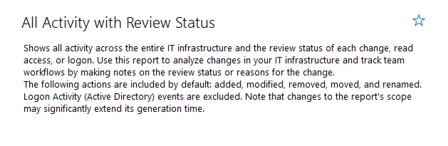

Step 1 – Locate the desired report in one of the other folders.
Step 2 – Click the name of the report to view its description.
Step 3 – To change whether the report is a favorite, click the star icon in the upper right-hand corner of the report description.
Report Summary with Star icon unchecked

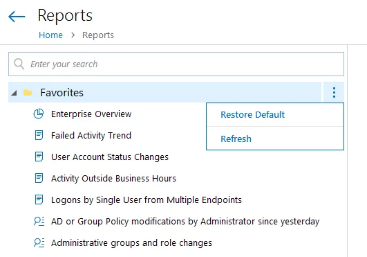

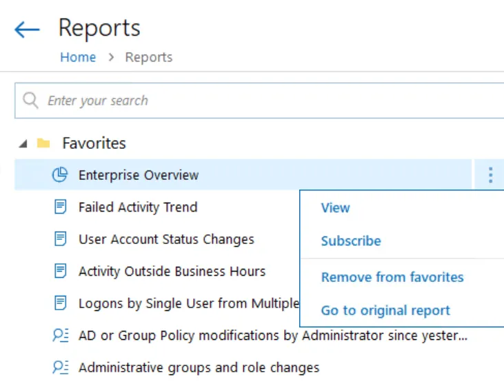

The options on the Reports page for Favorite reports are show below:
Favorites Sub-Folder Options | Favorites > [Report] Options |
Option Name | Description |
Restore Default | Repopulates the Favorites sub-folder with all reports that have been marked Favorite. When using Role-Based Access in Netwrix Auditor, if several users mark the same report as Favorite, then that report will be removed from the Favorites list if a user removes the report from the Favorites list. Using the Restore Default option will re-add the report to the Favorites list for all users that have not removed the Favorite mark. |
Refresh | Runs the reports in the Favorites folder to display the most recent information. |
View | Opens the Preview Report page. There, you can modify report options (such as the timeframe) if desired, and then click View Report to see the resulting report. See the View Reports topic for additional information. |
Subscribe | Opens the Add Subscription to Report page. See the Create Subscriptions topic for additional information. |
Add to Favorites | This option is greyed out when viewing the Favorites list, since all the reports shown have already been added to Favorites. |
Remove from Favorites | Removes a report from the Favorites list. This option provides the same function as removing a report as a favorite using the Star icon. |
Go to Original | Expands the sub-folder in which the report is originally located. For example, clicking Go to Original for the Enterprise Overview report will expand the Predefined > Organization Level Reports sub-folder. |

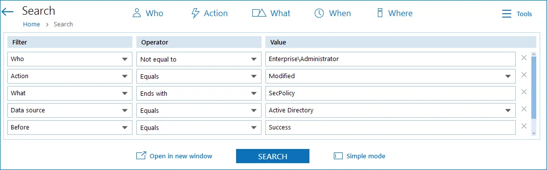

To modify conditions for the selected filters, make sure you have switched to the Advanced search mode.
The image below represents the same search filters as they are shown in the Search field in the Simple mode.

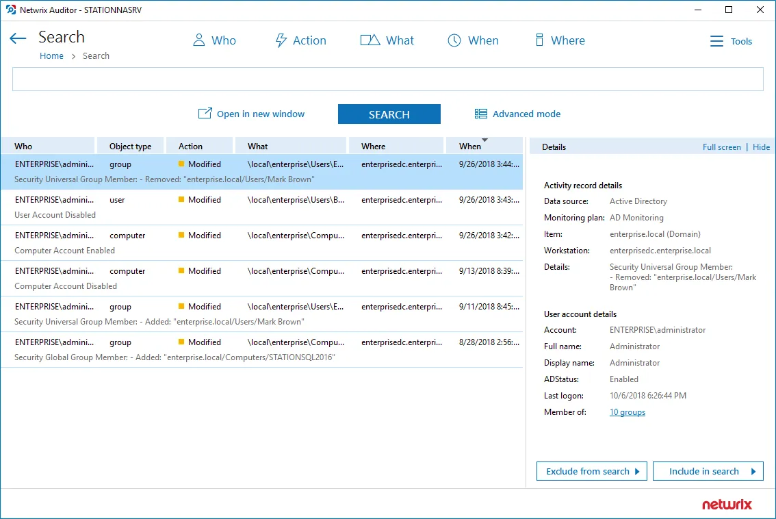

Browsing Your Audit Data
On the main Netwrix Auditor page, click
on the left.
You can add any elements (a dashboard, report, alert, risk, etc.) to the Auditor Home screen to access them instantly. See the Navigation and Customize Home Screen topics for additional information.
There you can use the UI controls to run the variety of search queries that will fecth you exactly the data you need.
To view all audit data stored in all Audit Databases by all monitoring plans, click Search button in the center.
Be aware that this type of search query may take time due to a large amount of data. Thus, it is recommended that instead of retrieveing a massive data set, you pre-configure your search query using filters.
By default, Netwrix Auditor shows only the top 2,000 entries in the search results.
To pre-configure your search query before you click Search, you can add filters. Then the search query will return only data matching your filtering criteria. See Use Filters in Simple Mode for details.
You can also use advanced filtering capabilities based on regular expressions (they involve filter fields and conditions). See Use Filters in Advanced Mode for details.
By default, search results are open in the same window, so the subsequent search results will overwrite the previous search results. To view them in different windows, click Open in new window.
In addition, you can customize your view by selecting columns to display.
Use search results for your own needs: save, share, create search-based alerts, subscribe to periodic delivery of search query results, etc. See Make Search Results Actionnable for more information.

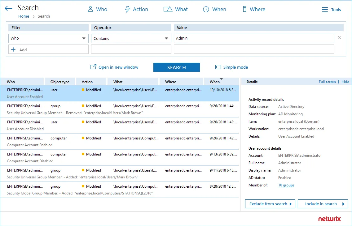

You can also use the Search window to examine details for the selected activity record, or watch a video recording (for User Ativity data).
Examining Activity Record in Detail
To work with a certain activity record:
- Select the activity record which details you want to review. Its key fields and user (initiator) account details will be displayed in the right pane.
- To display all fields and copy them if necessary, click the Full screen... link on the right.
If you are examining User Activity entries, click the Show video... link below the entry. Review details and play a video by clicking the Show video on the right.
- You can instruct Netwrix Auditor to include or exclude this activity record from the search query results, as described in the Include and Exclude Data
