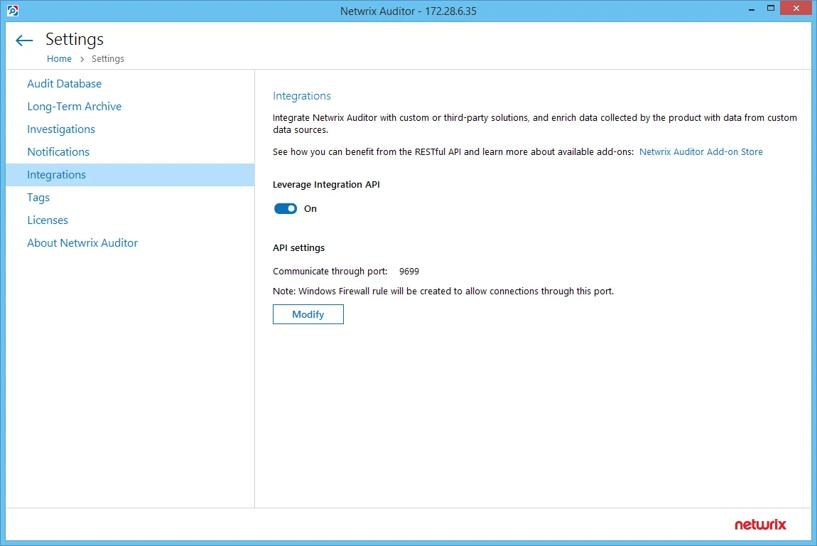

Configure Integration API Settings
Follow the steps to change the port.
Step 1 – In the Netwrix Auditor main window, navigate to the Integration tile.
Step 2 – Make sure the Leverage Integration API option is enabled.
Step 3 – Click Modify under the API settings section and specify a port number. Windows firewall rule will be automatically created.
Step 4 – If you use a third-party firewall, you must create a rule for inbound connections manually.
