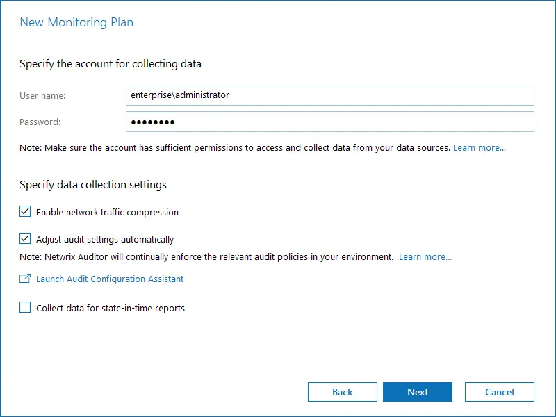

To adjust audit settings automatically, do any of the following:
- When creating a new monitoring plan, at the first step of the wizard select the Adjust audit settings automatically option. See the Create a New Monitoring Plan topic for additional information.

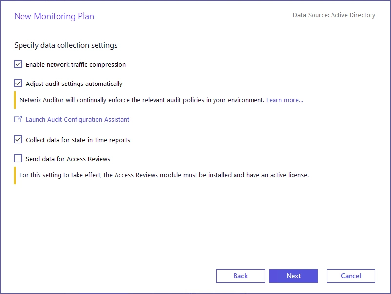

- For the existing monitoring plan, modify data collection settings for Active Directory data
source, selecting Adjust audit settings automatically option.
See the Manage Data Sources and Active Directory topics for additional information. - For both new and existing monitoring plans, you can click Launch Audit Configuration Assistant (in the wizard step or in the plan settings, respectively) to launch a special tool that can detect current infrastructure settings and adjust them as needed for monitoring. See the Audit Configuration Assistant topic for additional information.
If any conflicts are detected with your current audit settings, automatic audit configuration will not be performed. For a full list of audit settings required for Netwrix Auditor to collect comprehensive audit data and instructions on how to configure them, refer to the Active Directory topic.
