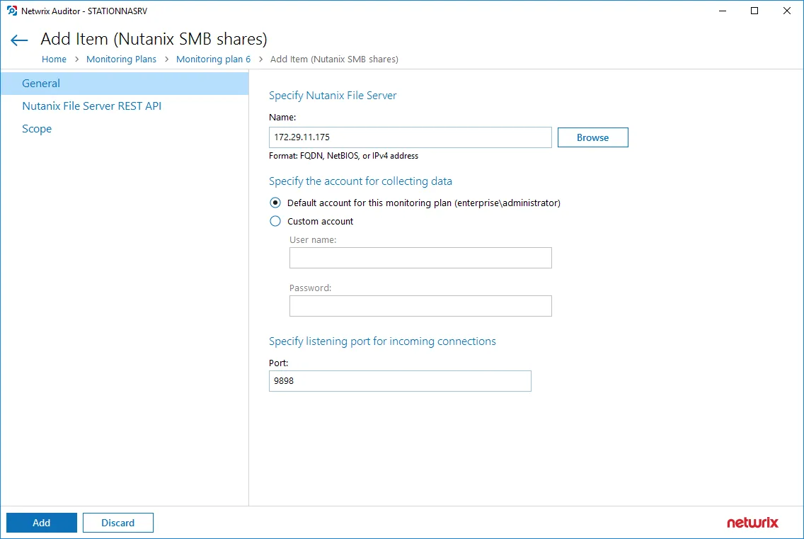

To allow inbound connections to Netwrix Auditor server from Nutanix File Server, a TCP port must be open:
- For the first Nutanix File Server you configure for auditing, the TCP 9898 port will be used.
- For each subsequent server, a new TCP port must be open.

To configure your Nutanix File Server for monitoring SMB shares, you will need to do the following:
Step 1 – Create a user account to access the Nutanix REST API. See the Create User Account to Access Nutanix REST API topic for additional information.
Step 2 – Open a port for inbound connections. See the Nutanix Ports topic for additional information.

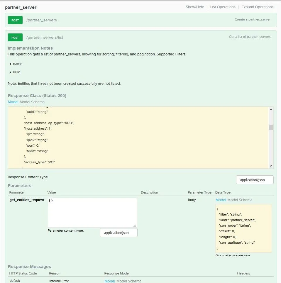

To check that a new partner server was included in the list of existing partner servers, retrieve the list of servers, sending the POST request to the following endpoint:
POST /partner_servers/list
The request body must be empty - for that, enter empty brackets as the value for
get_entities_request parameter: { }
- The response body should contain the list of servers, including new partner server name and other settings.

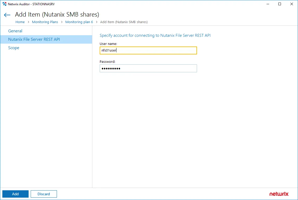

Account for Accessing REST API
You will also need an account that will be used to connect to Nutanix File Server REST API.
This account should be provided in the Nutanix File Server REST API tab of the monitored item (Nutanix SMB shares) settings.
This account must be assigned the REST API access users role for Nutanix File Server you want to audit.

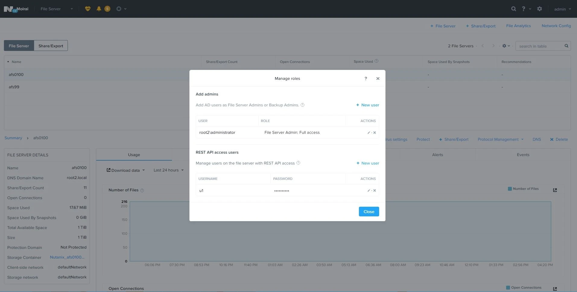

Role Assignment Procedure
Before starting the role assignment, make sure your Nutanix File Server is included in the AD domain.
Follow the steps to assign the required roles to the corresponding accounts using Nutanix Prism.
Step 1 – Open Nutanix Prism web portal.
Step 2 – Select File Server category. In the list of servers, select the server you want to audit.
Step 3 – Click Manage roles.
Step 4 – In the Manage roles dialog locate the Add admins section and click +New user.
Step 5 – Enter the AD user account (to be used as data collection account) in the domain\name format and select the File Server Admin or Backup Admin role to assign
Step 6 – Click Save next to these cells to save the settings.
Step 7 – Next, in the REST API access users section click +New user.
Step 8 – Enter the local user account and password, then click Save next to these cells to save the settings.
Step 9 – When finished, click Close.

Finally, create a new user and specify credentials that will be used to access this Nutanix Files server. For that, run the following command in ncli :
fs add-user uuid=<fs_uuid> user=<username> password=<password>

To create a new user account with Nutanix Prism:
Click Manage roles.
In the Manage roles dialog locate the REST API access user section and click +New user.
Enter local user account name and password, then click Save next to them to save the settings.
Click the Close button to close the Manage roles dialog.
