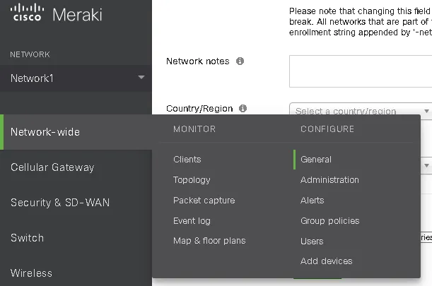

Step 1 – Sign in to Cisco Meraki Dashboard.
Step 2 – Navigate to Network wide > Configure > General.
Step 3 – Locate the Reporting section and click Add a syslog server.
Step 4 – In the dialog that opens, complete the following fields:
Option | Description |
Server IP | Provide the IP address of the computer that hosts your Netwrix Auditor Server. |
Port | Provide the port configured in your monitoring plan for Network Devices (514 by default). See theNetwork Devices topic for additional information. |
Roles | Select the following roles: - Appliance event log - Switch event log - Wireless event log |

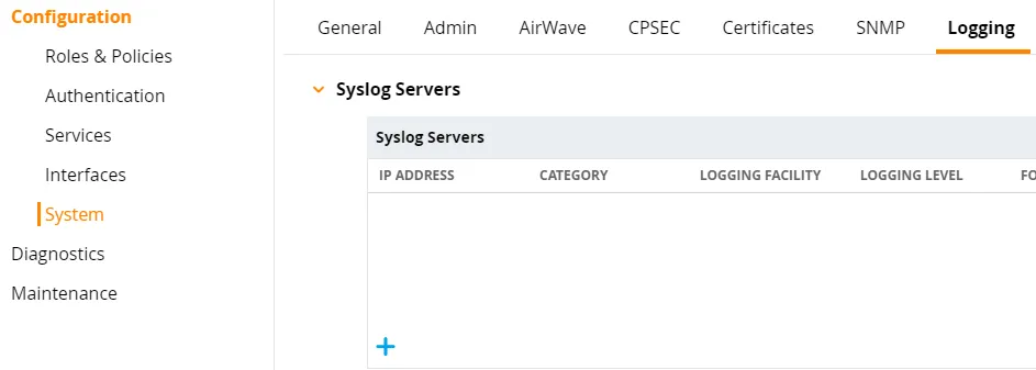

To configure HPE Aruba devices through the Management Console
Log in to HPE Aruba web interface.
Navigate to Mobility Master and select a device or a group of devices you want to monitor with Netwrix Auditor.
Navigate to Configuration → System → Logging and click + to add a new Syslog Server.
In the Add New Syslog Servers dialog, complete the following fields:
Option Description IP address Provide the IP address of the new server. Category Select None. Logging facility Leave empty. Logging level Select Informational. Format Select None. -
Click Submit. The new server is added to the Syslog Servers list.
Click Pending Changes on the right.
In the Pending Changes for
<X>
Managed Controller(s) dialog, select the device you want to apply changes to. -
Click Deploy Changes.
If the configuration is correct, you will see the following wizard:

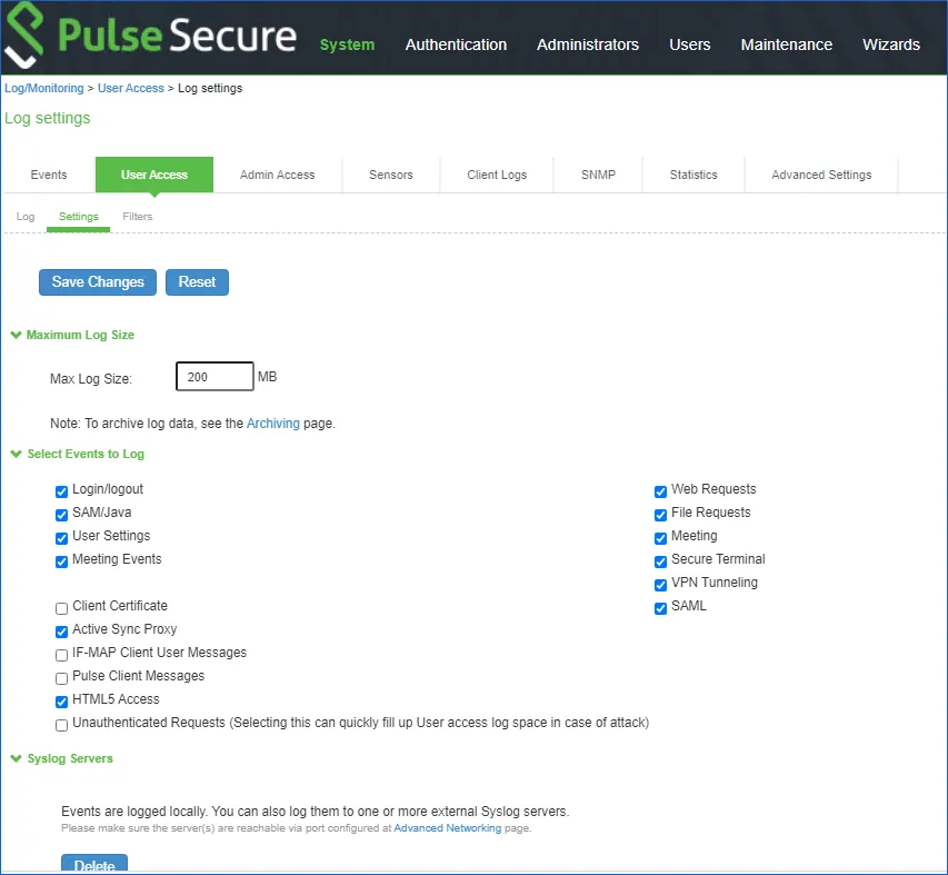

Configure Pulse Secure Devices
Connect to your Pulse Secure device: launch an Internet browser and enter the IP address or device DNS name in the URL field (https://
<IP address / Device DNS name>
/admin). -
In the Web Interface, navigate to System → Log/Monitoring.
Under Log/Monitoring, expand the User Access link.
Locate the Settings tab.
Under the Select Events to Log, select the following (minimal requirement, select other events if needed):
- Login/Logout
- VPN Tunneling
Under the Syslog Servers, complete the following fields:
Option Description Server nameIP Specify the IP address of the computer where resides. Facility Select desired facility. Type Select UDP. Client Certificate Use default values. Filter Select Standard. -
Save your changes.
Switch to the Admin Access tab.
- Administrator logins
- Administrator changes
Repeat the step 6 for Syslog Servers configuration.
Save your changes.
Navigate to System → Configuration → Advanced Networking.
Expand the Select the source port to be used for the following features link.
Locate the Syslog parameter and set it to Internal.
Netwrix Auditor must be accessible from the selected network interface
Save your changes.
