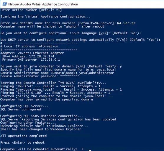

Step 2 – Next, specify a password for the built-in administrator account. Then re-enter your password. Click Finish.
Step 3 – Log in to the virtual machine.
Step 4 – The Windows PowerShell opens and automatically runs the script. Press any key to read the license agreement and then press Y to accept it.
Step 5 – Then you will be prompted to configure the virtual machine. Press Enter to start.
StepDescription
Rename virtual machineSpecify a new name for the virtual machine (e.g., NA-Server). The computer name must be properly formatted. It may contain letters (a-z, A-Z), numbers (0-9), and hyphens (-), but no spaces and periods (.). The name may not consist entirely of digits and may not be longer than 15 characters.
Add additional input languagesSelect Y if you want to specify additional input languages. Select N to proceed with English.
Configure network- Select Y to use DHCP server to configure network settings automatically. - Select N to configure required parameters manually. In this case, you will be prompted to set up IP settings manually.
Join computer to the domain or workgroupTo join a domain Select Y. Specify the fully qualified domain name to join (e.g., corp.local). Then specify domain administrator name and password. For your convenience, the account specified will be added to the local Administrators group and set as account for collecting data from the target systems. Domain Users group will be removed from the local Users group after the machine with the appliance joins the domain. The script is starting to test your domain controller: by NETBIOS name first, then by DNS name and finally, using an IP address. If at least one of the tests is successful, the computer will be added to a domain. In case of failure, you will be prompted to do one of the following: - Re-try to joint to the selected domain. In this case, the script uses the DNS name of your domain controller. The name must be resolved. - Continue with Workgroup. See the procedure below on how to join the computer to a workgroup. - Cancel and Return to Main Menu. Select if you want to cancel the domain join and re-configure the machine. Press Enter and repeat menu section. You will return to step 5. To join a workgroup Select N. Specify the local administrator name and credentials. For your convenience, the account specified will be set as account for collecting data from the target systems. Netwrix Auditor is unable to work in a workgroup. Please confirm if you want to proceed. Otherwise, you will not be able to run reviews on data collected by Auditor. See the Access Reviews topic for additional information about integration with Access Reviews.
Configure SQL ServerThe shell script automatically configures SQL Server instance. The sysadmin server role on SQL Server instance is granted automatically to the BUILTIN\Administrators group.
In the example below, review how the shell script configures the new VM:
appliance_script
Step 6 – When the script execution completes, you will be prompted to reboot the virtual machine for the changes to take effect.
