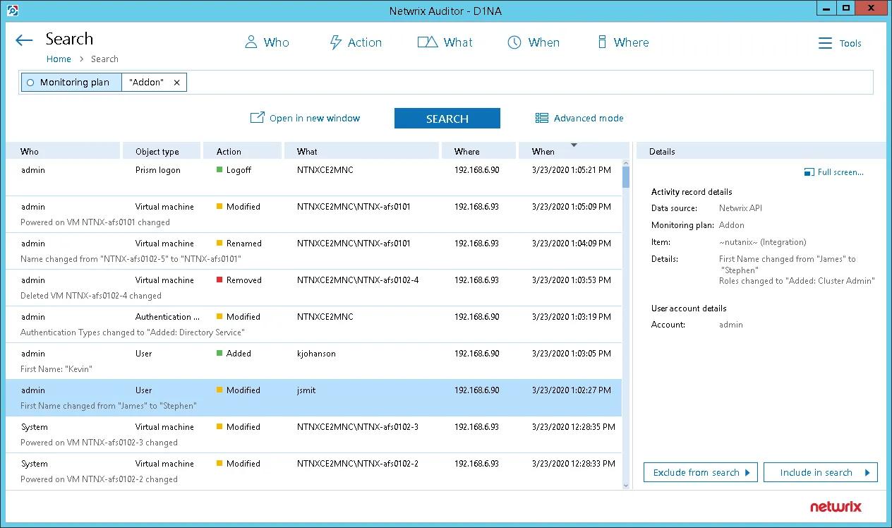

To leverage data collected with the add-on, you can do the following in Auditor:
  • Search for required data. For that, start Auditor client and navigate to Search. After specifying the criteria you need, click Search. You will get a list of activity records with detailed information on who did what in the reported time period.
You might want to apply a filter to narrow down your search results to the NetwrixAPI data source only.
screen_results
  • Also, you can click Tools in the upper-right corner and select the command you need. For example:
    • If you want to periodically receive the report on the results of search with the specified criteria, click Subscribe. Then specify how you want the report to be delivered – as an email or as a file stored to the file share.
    • To create an alert on the specific occurrences, click Create alert.
    • To export filtered data to PDF or CSV, click Export data.
  • You can also configure and receive alerts on the events you are interested in.
