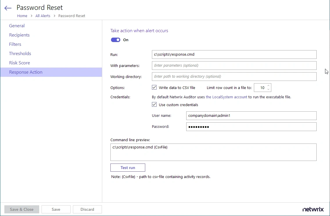

Response Action settings contain the following configuration options:
- Take action when alert occurs - Toggle this setting to On to enable alert responses
- Run – Indicates the location of the script file you want to run as your response action
- With parameters – If your script contains parameters, specify them here
- Working directory – If you need to specify a working directory for your script to perform the operation, insert the path here
- Write data to CSV file – If this checkbox is selected, Netwrix Auditor will save activity records in a CSV file. You can use it to pass information into your response action to receive a more targeted response.
- Limit row count in a file to – Select the desired number of rows you want for the file
- Use custom credentials – Enter the username and password if you want the script to be run as an account different from LocalSystem
- Command line preview – Showing a preview of the command line script. Click Test run button to test its performance.

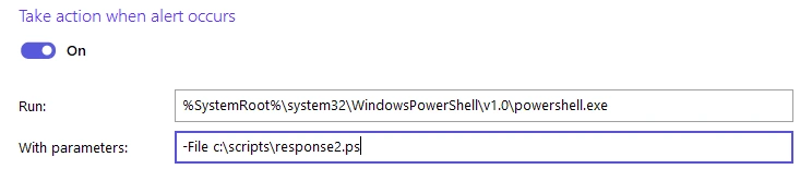

To run the .ps1 files, you will need to enter the path to powershell.exe and path to your script. For example:
- In the Run field, enter C:\Windows\system32\WindowsPowerShell\v1.0\powershell.exe
- In the With parameters field, enter
–File <path_to_your_ps_script>

By default, the executable file will be launched under the LocalSystem account. If you want to use another account, select the Use custom credentials checkbox and specify user name and password. Make sure this account has Log on as batch job privilege.
The resulting command line including executable file name and execution parameters will appear in the Command line preview.
