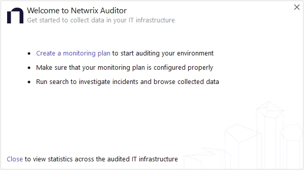

Welcome to Netwrix Auditor Tile
The Welcome to Netwrix Auditor Tile tile provides a checklist you can use to get started collecting and viewing data about your IT ecosystem.
The "Create a monitoring plan" link prompts you to create a monitoring plan for at least one data source (such as Active Directory, Exchange Online or network devices). For detailed instructions on how to create a monitoring plan, see the Monitoring Plans topic for additional information. Wait until the initial data collection completes.
Clicking the second link opens a dashboard that lists all the monitoring plans you’ve created, along with the status and last activity time for each. Review this list and address any errors or warnings. See the Monitoring Overview topic for additional information.
Once have created a monitoring plan and verified that it is properly configured, run one or more searches to get insights into your IT infrastructure. See the View and Search Collected Data topic for additional information.
When you have completed these three steps, you can close this tile by clicking the "Close" link at the bottom. The checklist will be replaced by statistics across your audited systems. See the Customize Home Screen topic for additional information.
