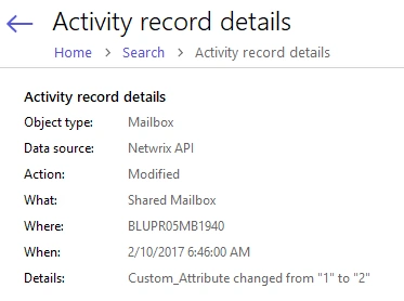

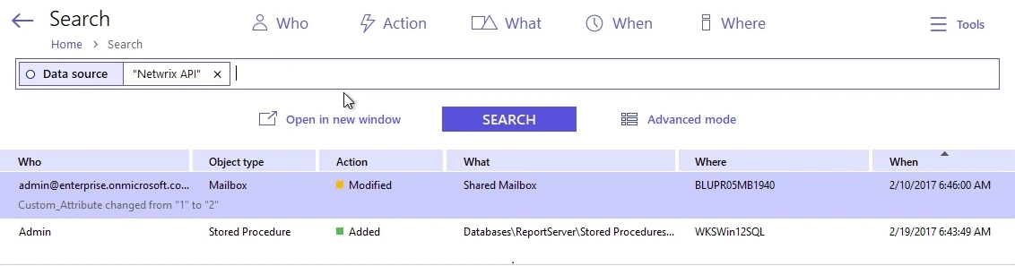

Step 4 – Check that posted data is now available in the Audit Database. Run a search request to /netwrix/api/v1/activity_records/search endpoint or use interactive search in the Netwrix Auditor client. For example:
Step 5 – For input Activity Records, the data source is set to Netwrix API.
