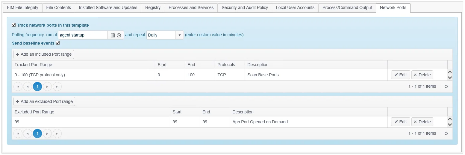

The Network Port Tracker is configured by specifying port ranges to include and exclude from the scan. In addition, the protocol used for each range can also be selected, either TCP, UDP or both.
NOTE: As with any UDP scan, the non-acknowledged nature of UDP requires a more intensive, slower approach which may result in scan times exceeding 24 hours.

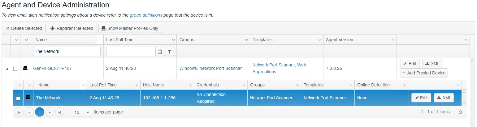

Step 1 – Define The Network device. Select the agent from which you would like the scan to run, usually the Agent installed on the Hub server, but any remote Agent or Agents can be used to run scans to their local subnet, thereby simplifying routing/firewall rules.
EditNetwork
  • Host/Database Name - Define the individual addresses and/or address range; use a space to separate multiple entries; use a 1-20 notation for an inclusive range.

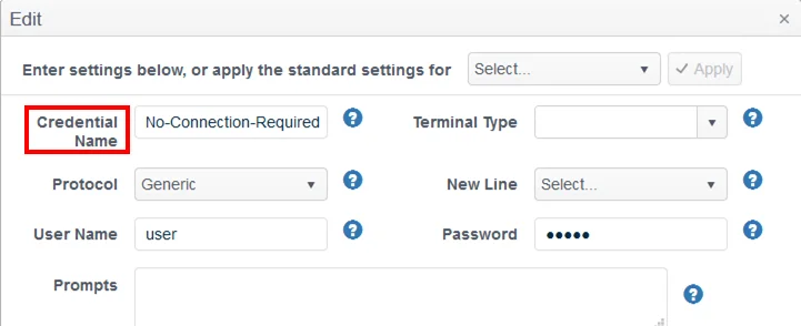

  • Credentials - For a multiple device/address port scan range, no credentials are required so a simple No-Connection-Required credential key is needed.
EditNetworkCredentialName
  • Credential Name - Create a ‘No-Connection-Required’ credential key – a username and password will be required but these can be entered as dummy credentials.

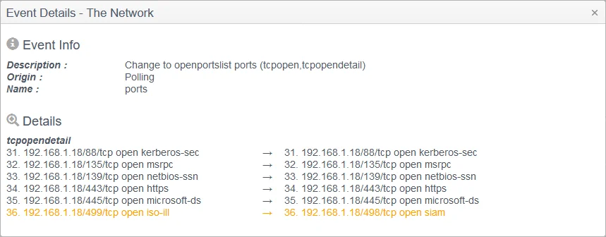

Step 4 – Provided you have specified within the Tracker template to Send Baseline Events then you will also be able to see both the full baseline/status for the Tracker results, as well as the usual change events. Similarly, you can also report on these, export the events, and receive alerts for any Planned and Unplanned changes.
