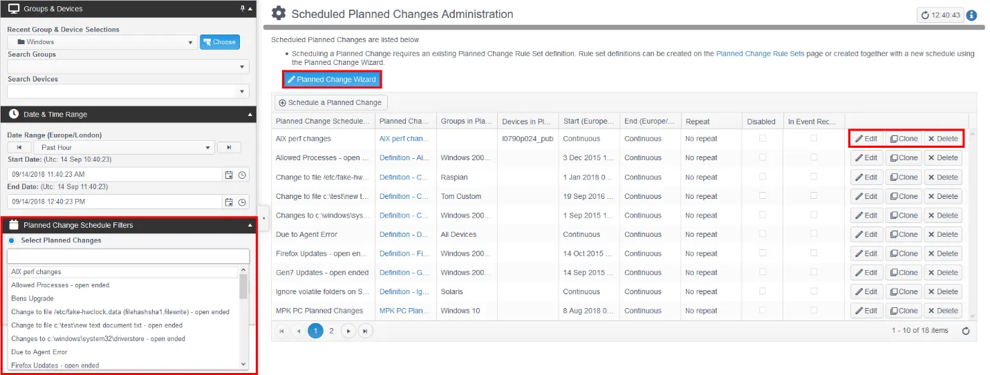

Scheduling, Creating and Editing Intelligent Planned Change Rules
Any Planned Change comprises the following elements:
  • Schedule – Start and End time/date, or continuous/no end date for permanently applied Planned Changes.
  • Scope – Events from the selected Devices and/or Groups will have the defined Planned Change rules applied to them.
  • Rules – Any number of Rules can be defined for a Planned Change to provide a template for the types of changes to be matched.
  • Rule Definition – Rules are typically defined against Device Events, with the Tracker™, Item Type and logical operator applied to match a file/registry value/software installation etc. name/part name.
  • Use the new Planned Change Wizard to guide you through the steps required to create a Planned Change Schedule and Rule Set.
NOTE: Rules can also be created directly from an observed event using the Actions button on the Events Tab, or by recording events directly from a device group. Note that an additional Planned Change Schedule filter is available in the Filter Control panel. Planned Change Schedules can be re-used – use the Clone button to create a copy.
