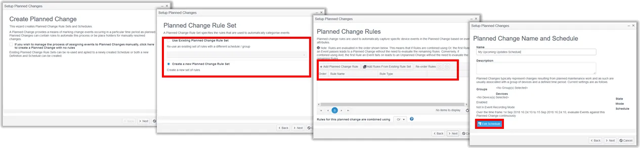

Planned Change Wizard
The Planned Change wizard helps guide the set-up of a new Planned Change Schedule and Rule Set in a single process. The wizard creates a Planned Change Schedule either with or without a Rule Set assigned.
The Rule Set can either be one previously created and re-used, or a brand-new Rule Set can be created.
The example below shows the sequence of steps to create a new schedule with a new ruleset.
NOTE: In Step 2, you can re-use rulesets where available or choose to create a new set. Rules can be created manually in Step 3 or again selected from the list of available rulesets.

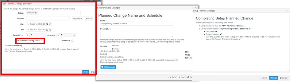

In Step 4, the Edit Schedule button allows Groups and/or Devices to be added to the schedule.
PlannedChangeRulesExample
NOTE: If you want to let Netwrix Change Tracker self-learn rules by recording change activity during the schedule, check the In Event Recording Mode box.
PlannedChangeEventRecordingMode page_guide_35
