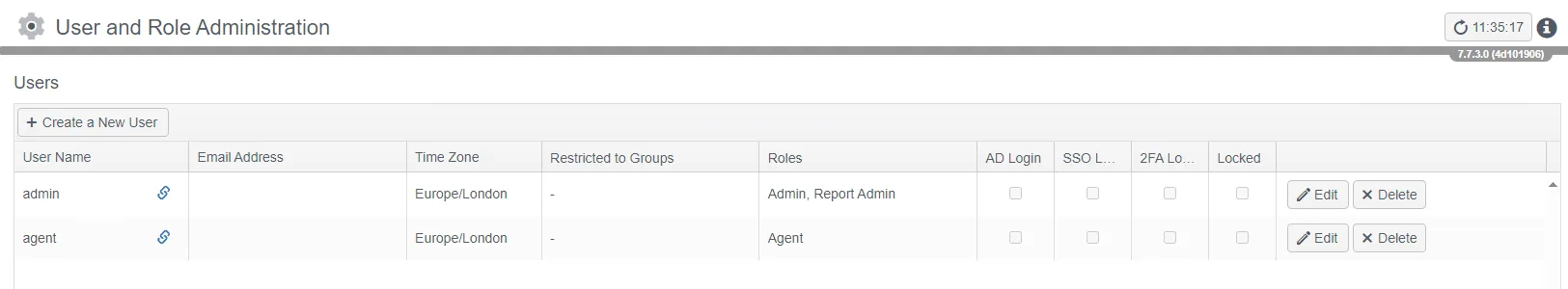

The Agent Account
During installation of the Hub, an account named Agent is created with just the Agent role. This role enables agents to use this account to authenticate with the Hub. As the agent account has no other roles, it can only be used by agents to authenticate.
Rotate Agent Credentials
The existing agent account can be seen in the Users section of the Hub.

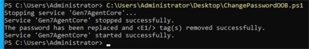

Agent Authentication Update on Windows
For Windows devices the ChangePasswordOOB.ps1 PowerShell script can be used to update the authentication details and restart the agent.
The two variables, $newUsername and $newPassword, near the top of the script, must be set to match the new agent account.
Running the script will set the new authentication details and restart the agent while producing the output below.

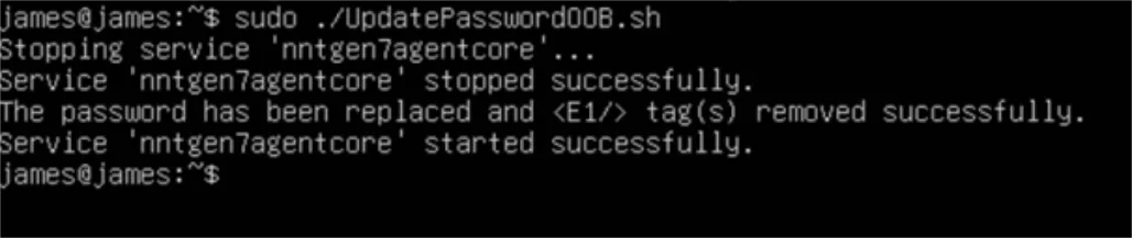

Agent Authentication Update on Linux
For Linux devices a bash script named UpdatePasswordOOB.sh is available to set the authentication details and restart the agent.
The two variables newUsername and newPassword near the top of the script must be set to match the new agent account.
Running the script will set the password and restart the agent while producing the output below.
