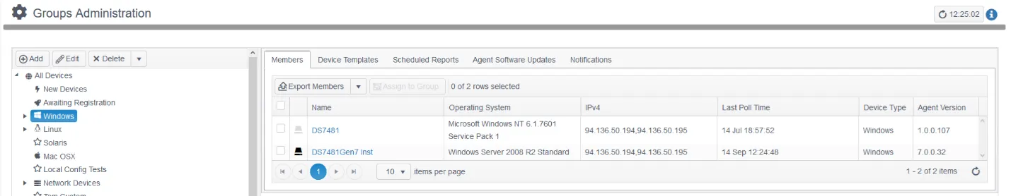

Device Groups
Click on a Device Group to edit the assigned Device Tracking template and Compliance Report, and to set the reporting schedule – contact Netwrix Support for more help

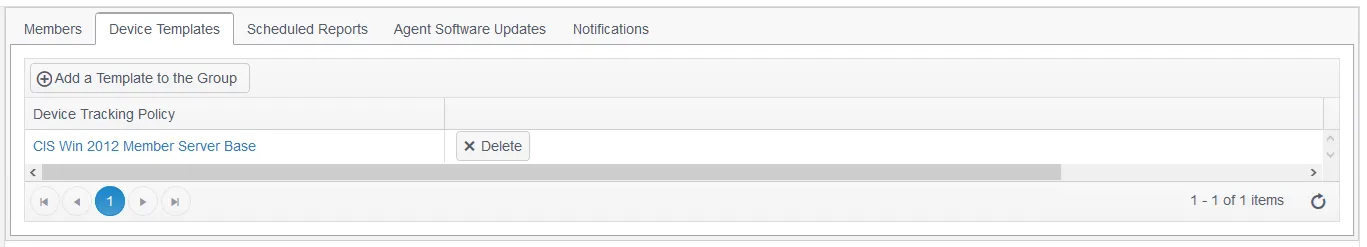

- To create a new Device Tracking template, use the Configuration Templates page;
- Assigning more than one Device Tracking Policy to a Device Group will result in a single merged policy being created;
- To create a new Compliance Report template, use the Compliance Report Templates page;
- To add additional Compliance Reports to a Device Group, just click the Schedule a New Report button;
- Use the ‘Group Name’ box to search and filter Device Groups shown.
Click on a Device Group name to configure further attributes for the Group, such as:
- Device Tracking Policy
- Compliance Report(s)
- Group Members, with the option to export a list of group Members
- Define the schedule for Agent Updates

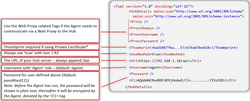

First Run – HubDetails.xml File
The Agent configuration settings are controlled by the Hub during operations but the initial registration necessitates a basic config file for registration with the Hub.
The HubDetails.xml file includes some details unique to your deployment of Netwrix Change Tracker , hence it requiring your intervention to make sure settings are as needed.
The key tags within the file are as follows:
*The Thumbprint uniquely identifies the Web Server certificate, see the How to: Retrieve the Thumbprint of a Certificate Microsoft article for additional information.
NOTE: Agent also supports additional nodes – NamePrefix and NameSuffix.
Agent does not need the UseNewHub node to be defined – this will default to true.

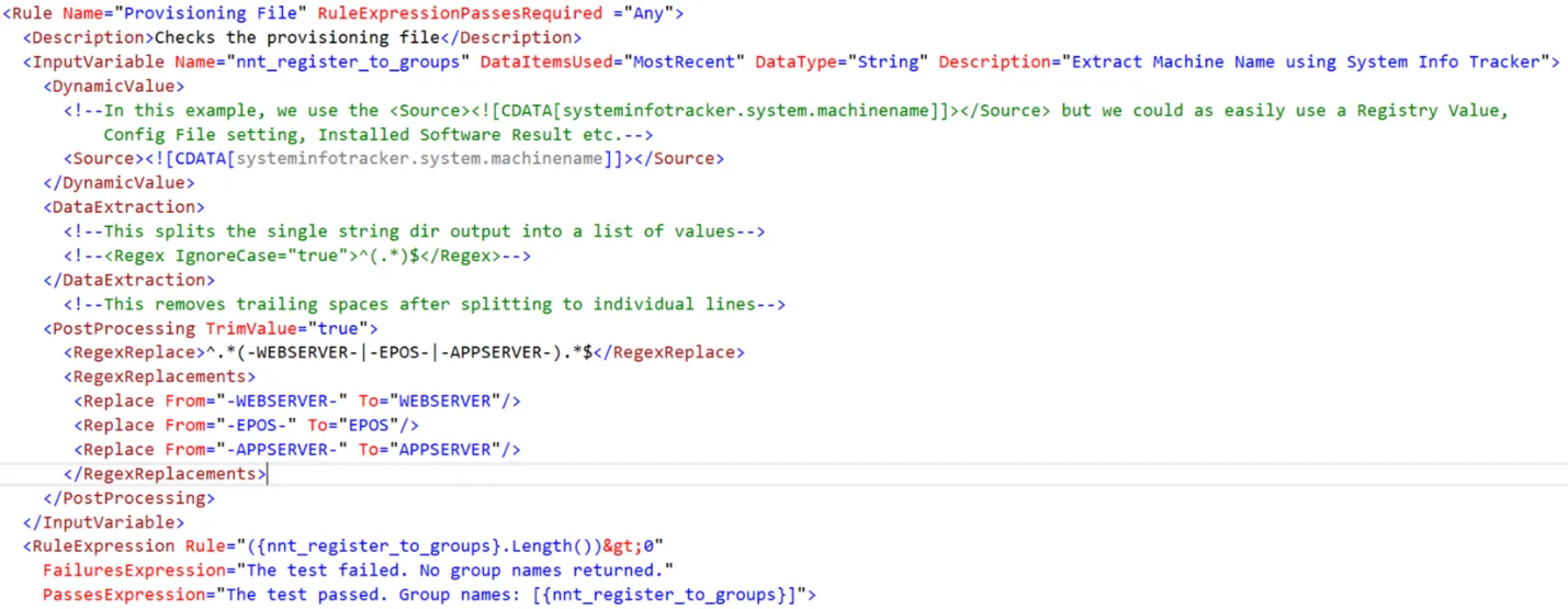

The Agent will then download and run the assigned Registration Report* which determines the Device Group that the Device will be assigned to. The Registration Report is like a full Compliance Report in that it can provision Tracker’s to gather config data from the device and process the returned data using rule expressions, with the results governing Group assignment.
In this example, the group regex match (-WEBSERVER-|-EPOS-|-APPSERVER-
) extracts only those
substrings if present, then the <Replace From lines
substitute in a valid group name for each
possible match (in other words, there must be a group already defined with the Group name being
referenced). This substituted name is then used as the initial group to register the agent into.
Note: if there s no match they ll end up in the default New Devices .

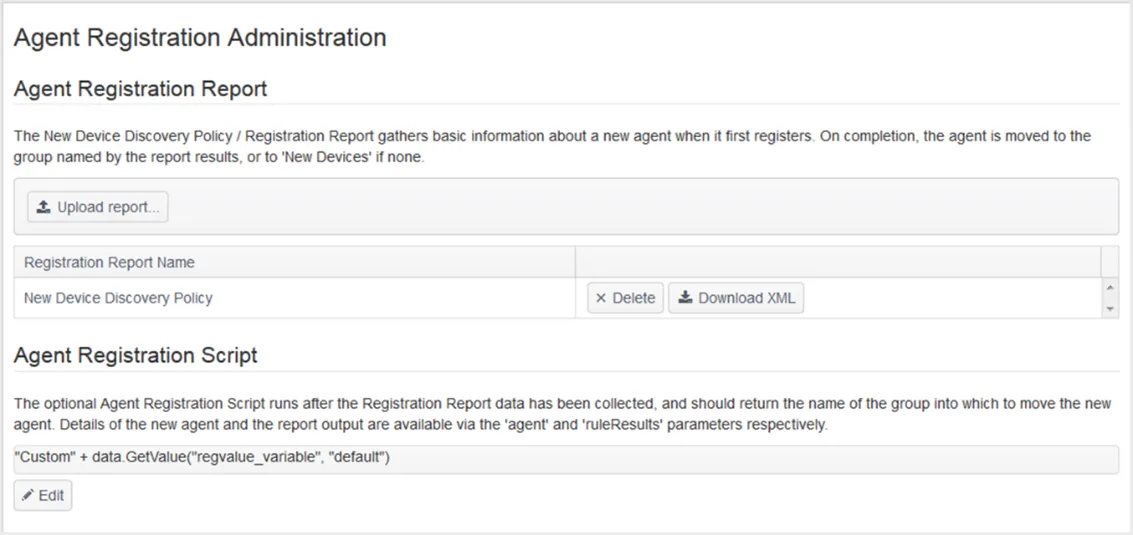

You can view and edit the Default Registration Report from the System page. In conjunction with
the Registration Report, the optional Registration Script parameters can be used, providing a GUI
option for post-processing Registration Report results in order to control group allocation. In the
example below it is assumed the report has a variable called regvalue_variable
i.e. reading a
value from the registry, and the custom code reads this value and appends it to the text Custom.
So, if the registry value contained WebServer, the device would be placed in the
CustomWebServer group if it exists, falling back on New Devices if it doesn t.
