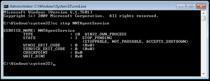

Step 4 – Stop the NNT Agent App Service.
- For Windows – Either use the MS Services Console Run > services.msc or use Command Line as
Administrator:
sc stop NNTAgentService
