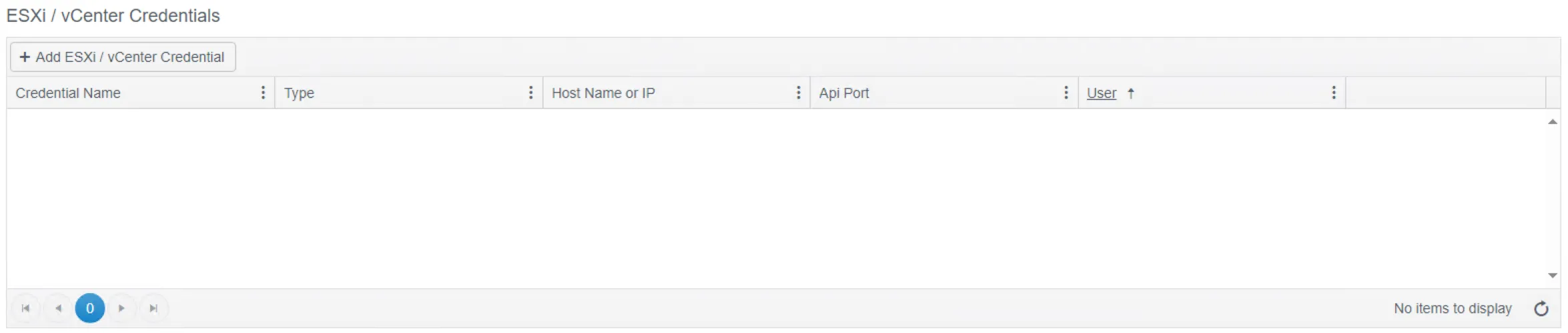

Step 1 – From the Settings menu, select Credentials and scroll down to the ESXi / vCenter Credentials section.

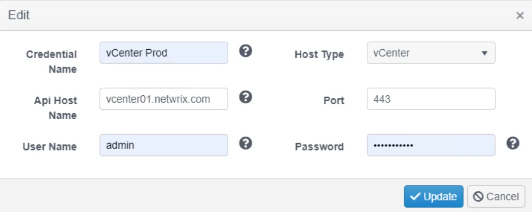

Step 2 – Click the Add button and enter the credential information. For vCenter / ESXi monitoring, it is recommended to use vCenter as the Host Type as it allows for ESXi node discovery, The ESXi Host Type option enables connections to stand alone ESXi servers.

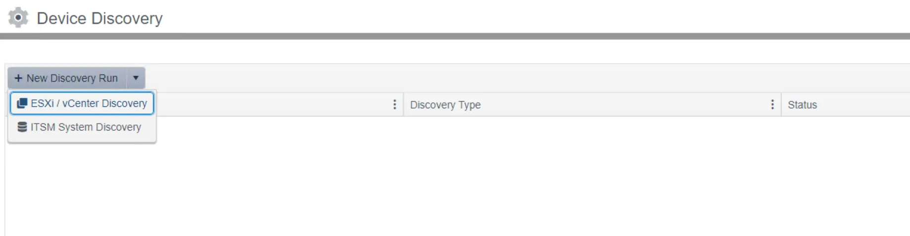

From the Settings menu, select Device Discovery. Select ESXi / vCenter Discovery from the drop down to configure the discovery job.

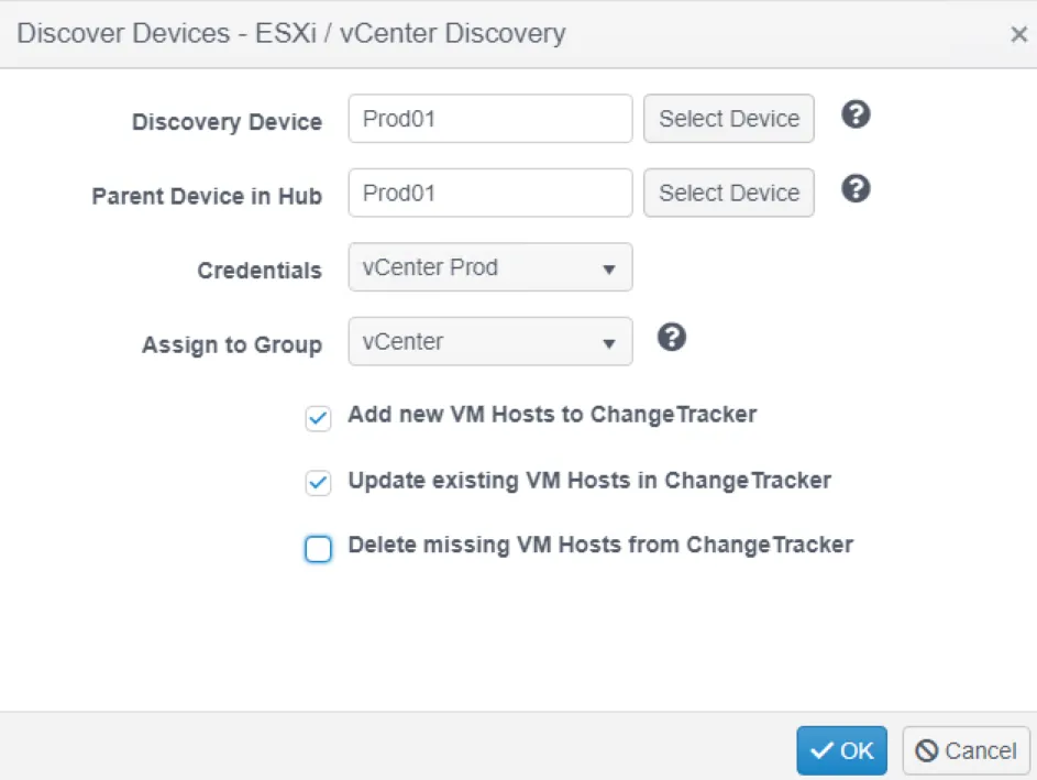

Discovery Device is the device running the agent that will execute the commands to discover the ESXi nodes.
Parent Device in Hub is the proxy device that the proxied devices (that represents the ESXi nodes) will be registered under. Usually Discovery Device and Parent Device in Hub use the same agent, but different discovery jobs executed by different proxy agents could be configured to register all of their discovered nodes under one proxy agent.
The "Assign to Group" drop down is the group the discovered ESXi nodes will be assigned to. There is no automatic registration so a group must be chosen.
devicediscoveryform

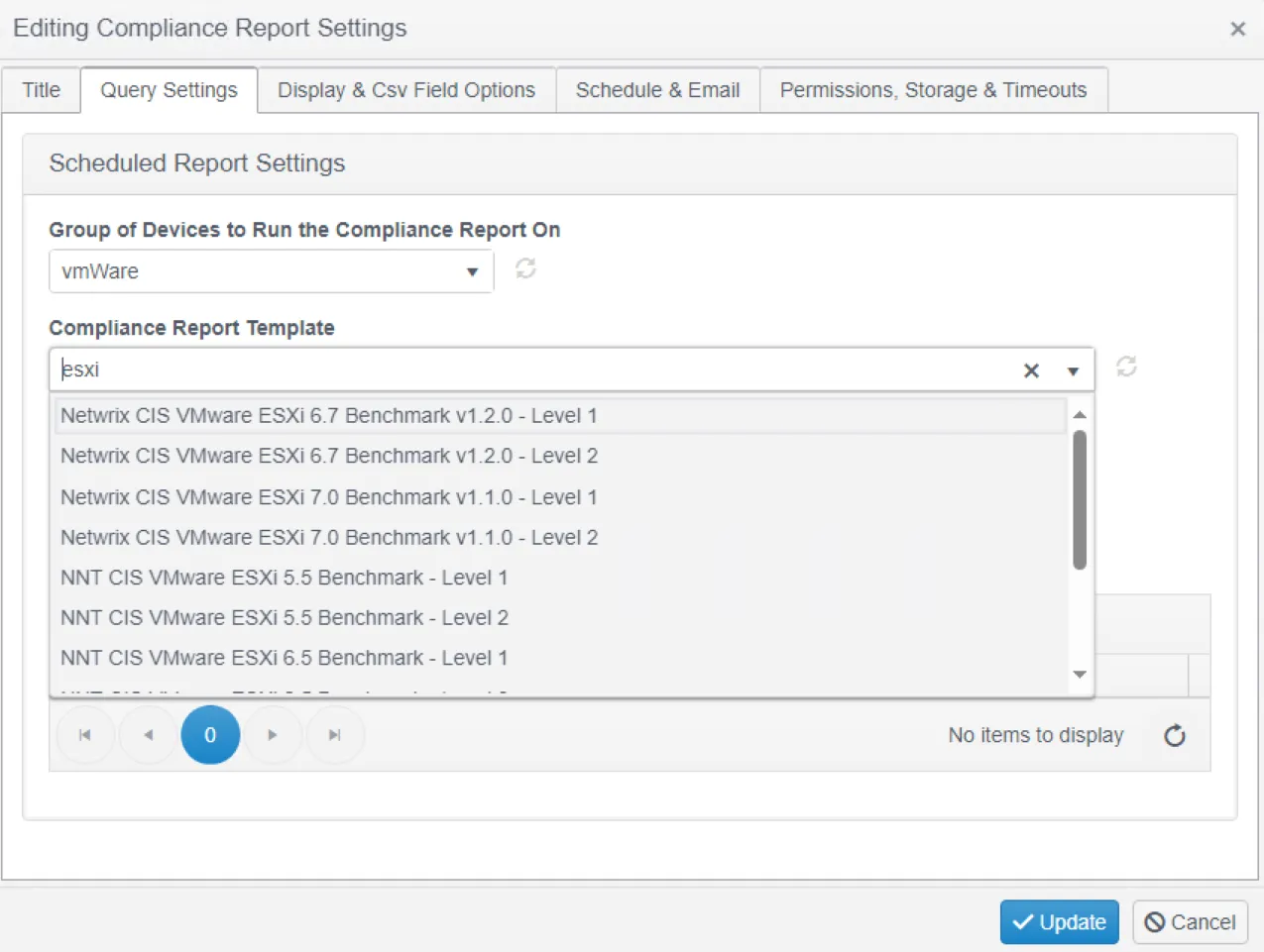

Under the Reports tab, it is now possible to configure and run the appropriate compliance report against the group that contains the ESXi devices.
