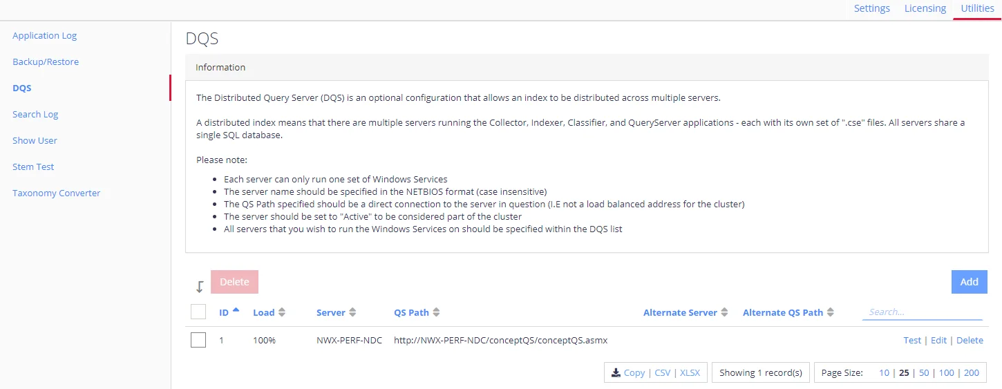

  5. On the DQS tab, click Add to add servers you prepared, one by one.
    dqs_mode_page_thumb_0_0
    Complete the following fields:
    SettingValue
    ServerProvide the NDC Server name or IP address (name format is case-insensitive).
    QS PathPath to the solution component responsible for DQS mode, residing on the server being added. Filled in automatically; leave the default value.
    ActiveSelect to enable clustering for the instance being added.
    Alternate ServerNetwrix recommends using default values.
    Alternate QS PathNetwrix recommends using default values.
  6. Click Save to close the dialog.

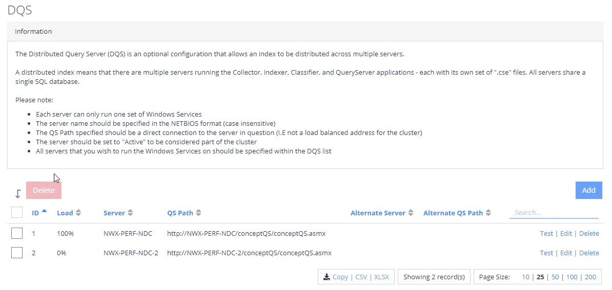

  2. Repeat steps 2 - 6 for every NDC Server, then review the list of servers to make sure the new server was included.
