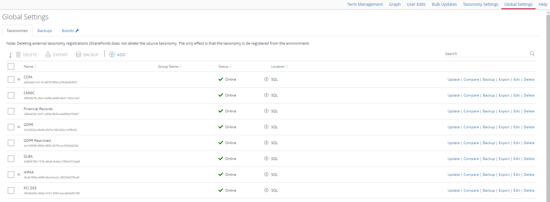

  1. Update taxonomies manually. For that:
    1. In administrative web console, navigate to Taxonomies → Global Settings.
    2. Click Update in the right corner next to each taxonomy
    update_taxonomy
