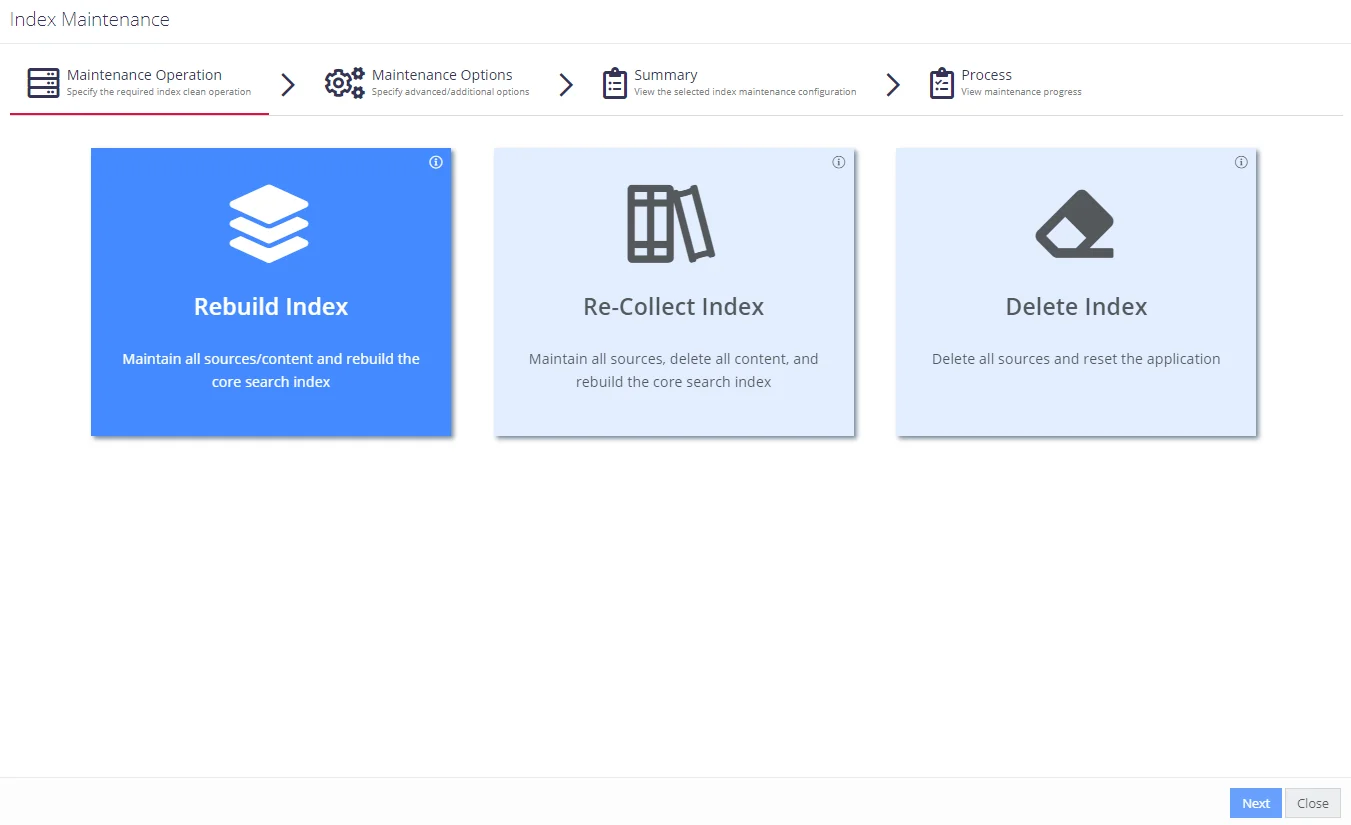

Step 1: Maintenance Operation
Select the operation you want to perform:
  • Rebuild Index—All content processing results (text/metadata) will be retained, but the search index will be truncated. Then the program will re-do all indexing/classification (during that process, search results will be unavailable). Optionally you can choose to Shrink - this will rebuild the Text.cse file removing any fragmentation. Shrink will require sufficient disk space to process (up to the existing size of Text.cse)
  • Re-Collect Index— The search index will be cleaned (all documents from the source will be removed from it). Then the program will re-crawl all configured sources and update the search index (during that process, search results will be unavailable).
NOTE: This option is recommended after setting up DQS configuration.
  • Delete Index—Delete all content from both the search index and the NDC SQL database.
cleaner_step_1

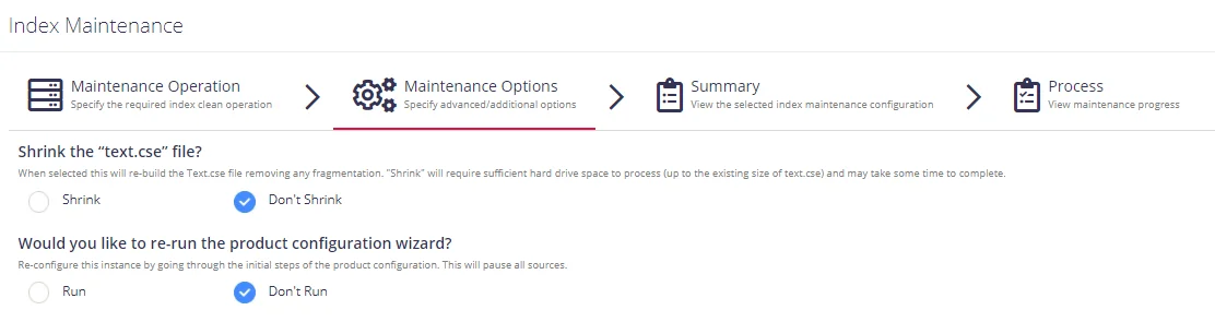

Step 2: Maintenance Options
Specify options for the operation you have selected.
Operation selectedAvailable optionsDetails
Rebuild IndexShrink the "text.cse" file? - Shrink - Don't Shrink (default)Selecting Shrink will rebuild the Text.cse file, removing any fragmentation. Shrink will require sufficient disk space to process (up to the existing size of Text.cse) and may take some time to complete.
All operationsWould you like to re-run the product configuration wizard? - Run - Don't Run (default)Select Run if you want to re-configure this instance by going through the initial steps of the product configuration. Note that this will pause all sources.
cleaner_step_2_thumb_0_0

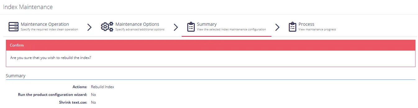

Step 3: Summary
Review the selected operation (action) and its options you have specified.
Clicking Next will confirm and start the maintenance operation.
cleaner_step_3_thumb_0_0
Step 4: Process
Finally, wait for the selected maintenance operation to complete. Until then, search results will be unavailable.

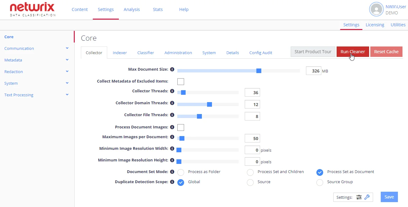

To launch the Cleaner tool
  1. Open NDC Management Web Console.
  2. Navigate to SettingsConfig and click Run Cleaner.
  3. Then follow the steps of Index Maintenance wizard.
run_cleaner_thumb_0_0
