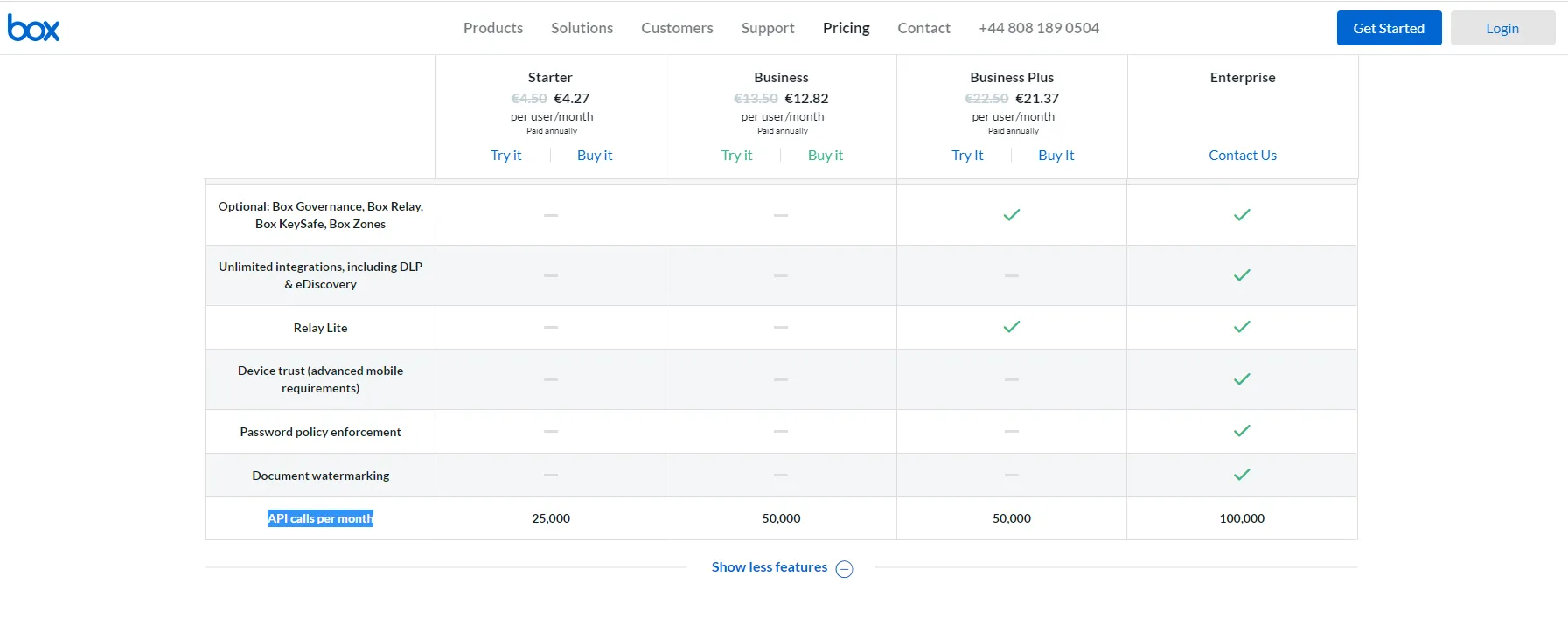

  1. Check if your Box license plan provides the capacity you need. Netwrix Data Classification uses API calls for content crawling (min one API call for a single file). Therefore, if you need to store and crawl a large amount of files in Box (e.g. 100, 000 files), then your selected plan should support a sufficient number of API calls per month. Otherwise, the solution will not be able to crawl your content in one month due to limited number of allowed API calls (e.g. with a Starter plan that provides only 25 000 calls per month). So, when selecting a Business subscription plan at https://www.box.com/pricing, remember to click Show more features in the bottom and examine the information on API calls per month supported by each plan.
box_lic_plans_thumb_0_0

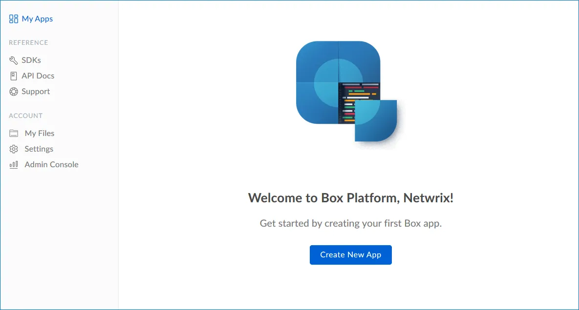

  3. If you have not created an app before, you will see a screen similar to the one below:
    box_app
  4. Click Create New App.

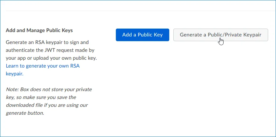

  11. Then you should create a public/private key pair to authenticate the JWT requests made by your app. Navigate to Add and Manage Public Keys and select Generate a Public/Private Keypair.
    NOTE: If you have not enabled two-factor authentication for the app account in advance, you will be prompted to do it. Click Settings, then in the Account Settings, navigate to Authentication. Select Require 2-step verification to protect your account, then provide the necessary information in the Enable Login Verification dialog and complete the verification. When finished, get back to the Configuration section, clicking the related item in the left pane.
    box_keys
  12. You will be notified about downloading a JSON file with all configuration settings of your app.
    IMPORTANT! Since Box does not store any private keys, this file contains the only copy of your private key, so store it securely.
