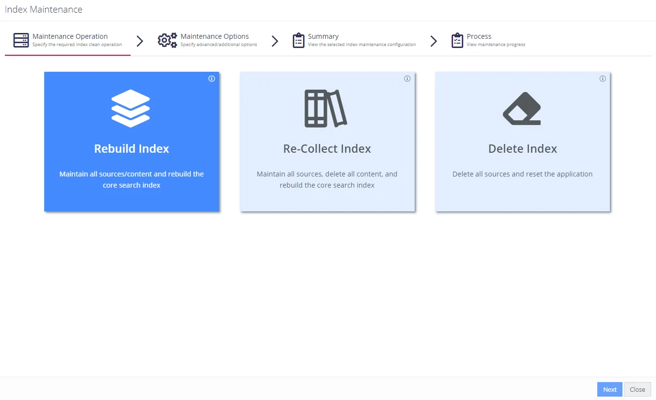

Step 1: Maintenance Operation
Select the operation you want to perform:
- Rebuild Index—All content processing results (text/metadata) will be retained, but the search index will be truncated. Then the program will re-do all indexing/classification (during that process, search results will be unavailable). Optionally you can choose to Shrink - this will rebuild the Text.cse file removing any fragmentation. Shrink will require sufficient disk space to process (up to the existing size of Text.cse)
- Re-Collect Index— The search index will be cleaned (all documents from the source will be removed from it). Then the program will re-crawl all configured sources and update the search index (during that process, search results will be unavailable).
NOTE: This option is recommended after setting up DQS configuration.
- Delete Index—Delete all content from both the search index and the NDC SQL database.
