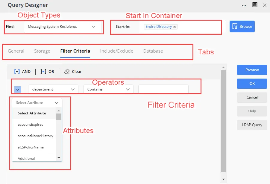

The Query Designer policy enables you to restrict the following Query Designer features for a security role:
  • Policy application on new groups or on existing groups as well.
  • The Start In container - Specify container(s) that will be displayed to role members on the Query Designer. Queries created by role members cannot run beyond the specified containers. You can also enforce the allowed containers so that role members cannot change them.
  • Object types - Limit the object types that will be available to role members for including in queries. You can also enforce the allowed object types, so that role members cannot exclude any of them from queries.
  • Tabs on the Query Designer - The Query Designer has multiple tabs and all of them are available to users by default. You can choose to hide any of these tab from role members.
  • Attributes and their respective operators. - Specify the attributes that will be available to role members for building queries for Smart Groups and Dynasties. For each attribute, you can also specify the operators that role members can apply to it.
querydesigner
You can also specify a default filter criterion, involving an attribute, an operator, and a value, that will be displayed to users on the Filter Criteria tab of the Query Designer. Role members can change this criterion as required.
If you already have restricted some schema attributes for the Query Designer pages in portal, those settings will be override by the schema attribute settings specified here.
