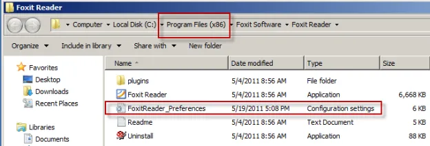

Using Windows Explorer, you can look for INI files (expressed as "Configuration settings" in the file type in Explorer), XML files, and other file types. In Figure 88, you can see an INI file for an application within Program Files (x86).

Figure 88. Example of INI files.

The warning indicates a problem not with where this application's data was found (right now), but actually where that data is likely to be stored (on the client machine).
Starting with Windows Vista (and continuing through Windows 7, etc.), only administrators can write configuration data to:
  • C:\
  • C:\Program Files\
  • C:\Program Files (x86)\
If you are seeing an application's data files inside one of these directories, that indicates that you've run this application at some point with administrator credentials. Then, the application wrote configuration data to Program Files, as administrators are allowed to do this. However, when this application is run as a standard user (that is, without local administrator credentials) those settings will not be stored here. When the application is run as a standard user, Windows will redirect the storage of this application data to somewhere within %appdata%. Therefore, it is not recommended to proceed using a hardcoded path with Program Files in the name because the file might exist on this machine, but it's unlikely to exist on the client machines in that same path.

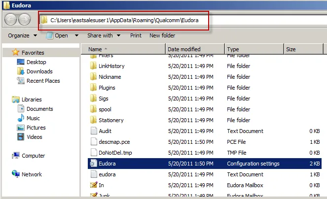

When this application is run as a standard user, the configuration data is within %appdata%\roaming as shown in Figure 90(in this case, %appdata%\roaming\Qualcomm\Eudora). That's because this application was smart enough to know to use %appdata% as its data store when run as a standard user.
discovering_configuration_3
Figure 90. Configuration data stored within %appdata%\roaming.
