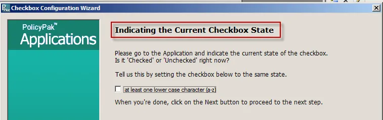

Netwrix Endpoint Policy Manager (formerly PolicyPak) DesignStudio Configuration Wizard is a lite capture tool. When the Configuration Wizard runs, it takes a snapshot of all the items in your data root, asks you to make some changes, and then captures what you've done. Then it sets your element's settings. To perform these tasks, the Configuration Wizard may ask you some questions about the current state of the application first. For instance, it may asked if a checkbox is currently checked or unchecked, as shown in Figure 114.
Figure 114. Selecting whether a checkbox is checked or unchecked.
This is to make sure nothing has changed from when the Capture Wizard captured the application's UI settings. If you look at the actual application and the setting is checked, changed, or otherwise altered, then change the Configuration Wizard, not the application.

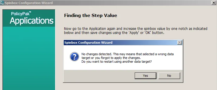

If you click "Next" in the wizard but the wizard was unable to detect any changes, it will tell you that no changes were detected, as shown in Figure 115.
Figure 115. The message to indicate no changes were detected.
To resolve this, you can try doing the following:
- Click "No" in the dialog box to try again.
- Ensure you've clicked "Apply" or "OK" in the application and then continue onward with the wizard to see if it detects the change.
- Select "No," then try closing the target application altogether. Sometimes the application's items are stored in memory and only written to disk when the application is fully closed. After closing the application, click "Next" in the wizard to see if the change was detected.
If you've you continued to proceed onward, and there are still no detected changes, then the data is
not stored within the data root selected earlier. Even if 80% of an application's settings are
stored within the same place (such as HKEY_Current_User\Software\<vendor>\<application>
), a
fraction of the settings may be stored in a different file or a different part of the registry. The
Capture Wizard cannot detect all changes on your hard drive; it has to be told where to look. So, if
you're still having problems, go back to the previous section of this guide entitled "Setting Up
Application Configuration Data," which uses Microsoft's Process Monitor to discover where settings
are being stored when you change data.
